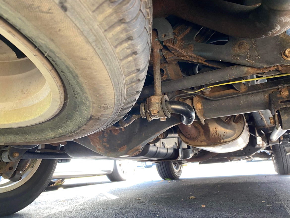

Thoughts on this rust for a 18k 2010 with 130k miles.
Personally I’d run! But depends what your choices are and how’s the rest of the vehicle. Maintenance records? Car fax? Etc. IMO I’ve always thought a good vehicle is worth traveling for. A airline ticket and road-trip back really isn’t much if your in for the long haul!

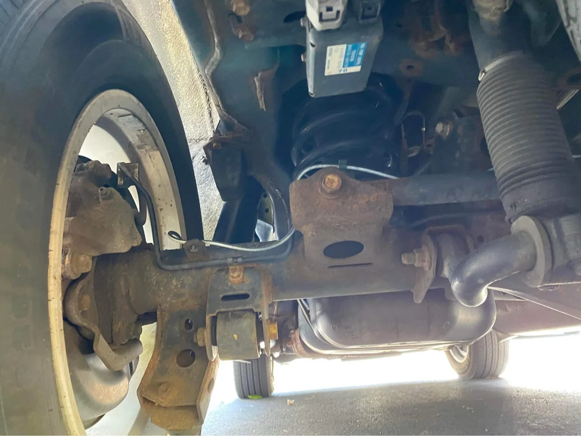

Overall that is not bad, but the rust above the rear axle (near the KDSS mounts) is a bit concerning. Kind of looks like some salt got trapped there. I would inspect that area and see if it is just surface rust or if some of the actual frame section has been lost. If you can peel of flakes of frame, I'd probably pass.
Other areas to check are under front radiator (core support area) and the passenger side framerail behind the front tire (where the AC line drips). For the passenger side framerail, it's not uncommon for them to rust from the inside out, so shine a light in the frame and see how good or bad it is.
I would not write the GX off just yet but I'd look at it cautiously before you make any decisions on it. If it does have actual frame section loss anywhere on it, I'd probably pass. Surface rust is fine and can be addressed via undercoating.

My opinion, is if it's something that a wire brush will take off, then you're good. If you're seeing ANY bubbling, pitting, etc. then RUN! But considering you're in Pittsburgh, I imagine rust is as common as table salt. So that being said, what you're showing doesn't look all that bad. Look under some other cars (any cars) in your area that are that old with that many miles and see what kind of rust they have.
Lol… very true! Sometimes I feel lucky looking at some of the vehicles on this forum. I’ve never had to deal with lots of rust. When we get one in the shop people call in sick!!! All honestly, the frame above the rear axle looks excessive, But this Gx maybe in really good shape for being up there though.

Back to the GX in the picture - most of the framerails and underside looks great, other than a few spots. It looks like the PO ran it through an automatic carwash all the time, but those washes missed some hard-to-get-to places like the KDSS mounts, panhard bar mount, etc. Washing alone is probably never going to be enough for a GX in a salty environment - they need additional protection (e.g., undercoating) due to the crummy OEM frame paint/coating.
