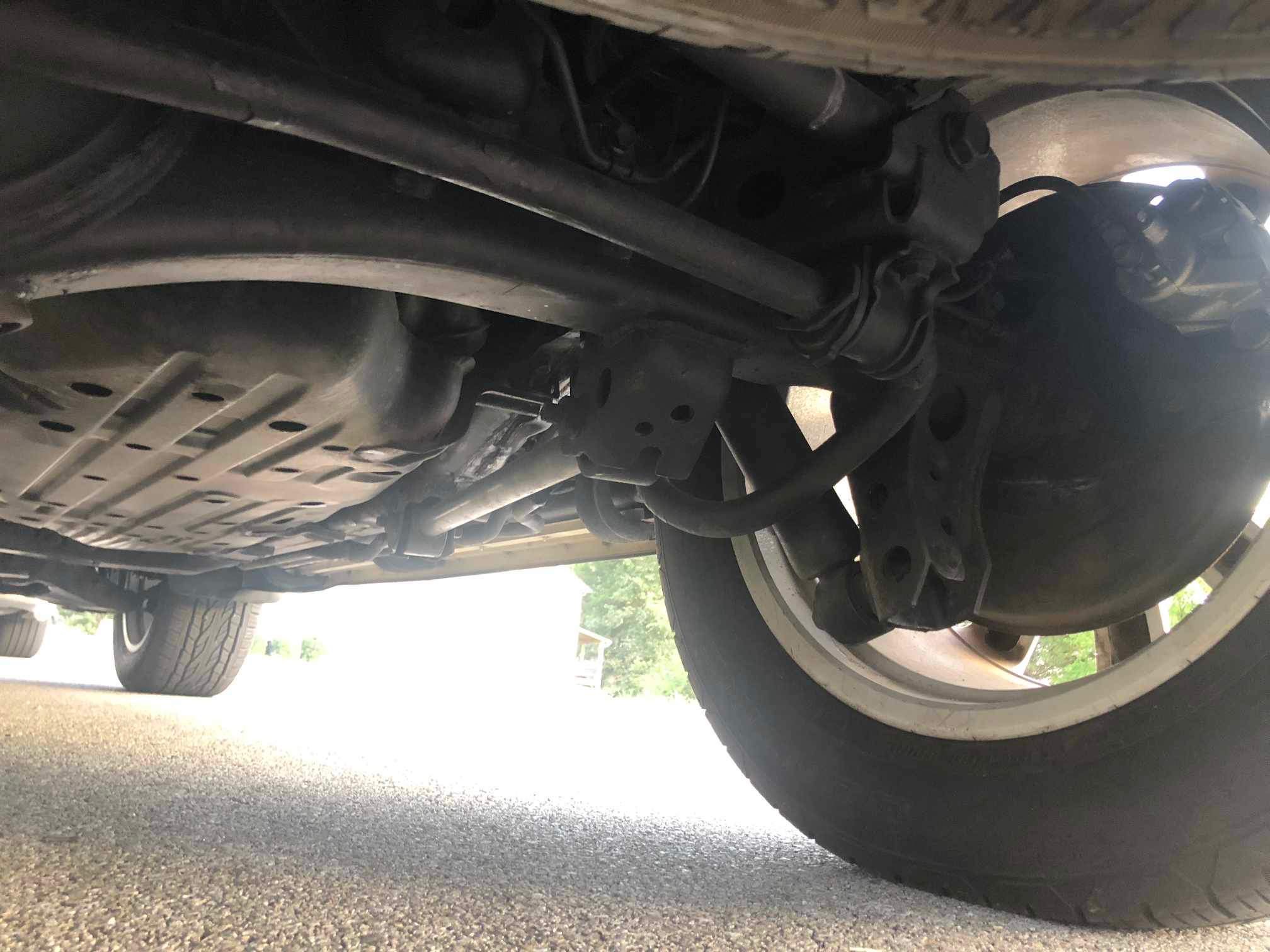

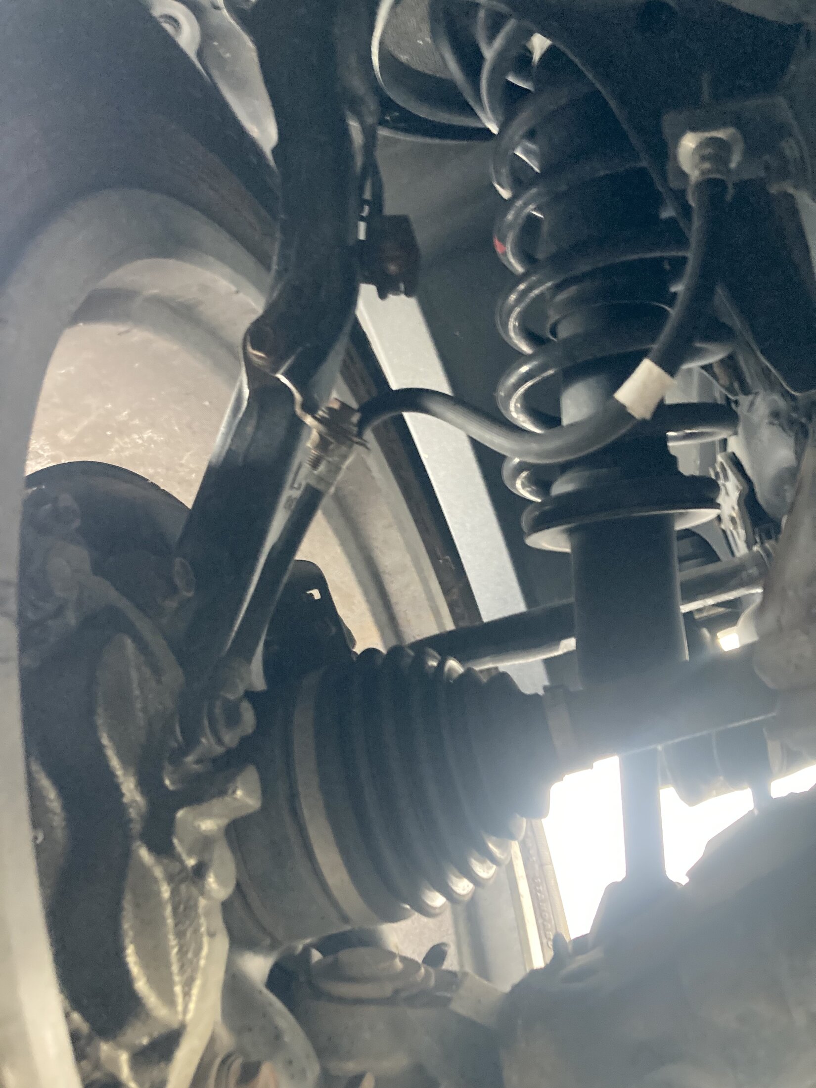

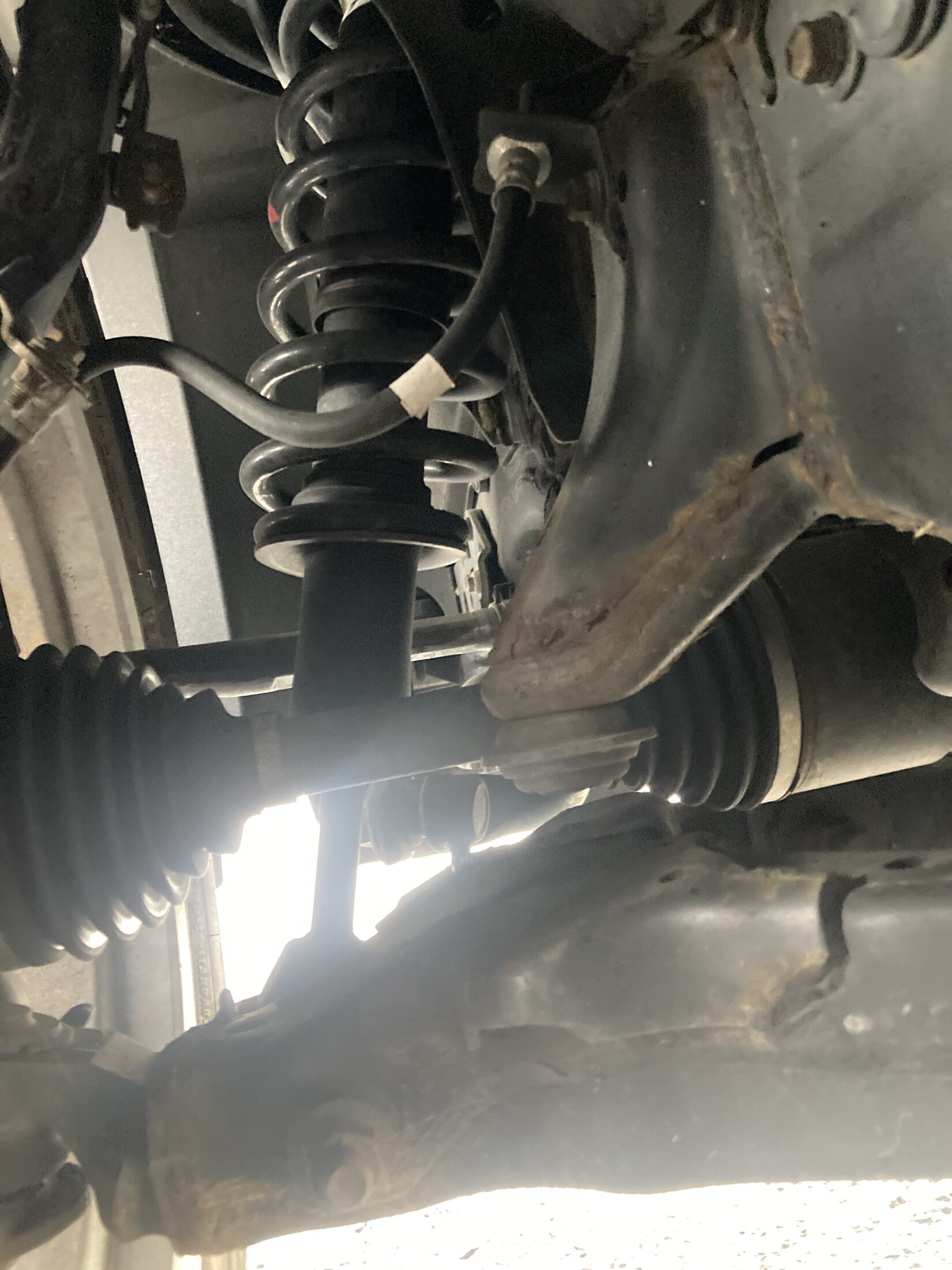

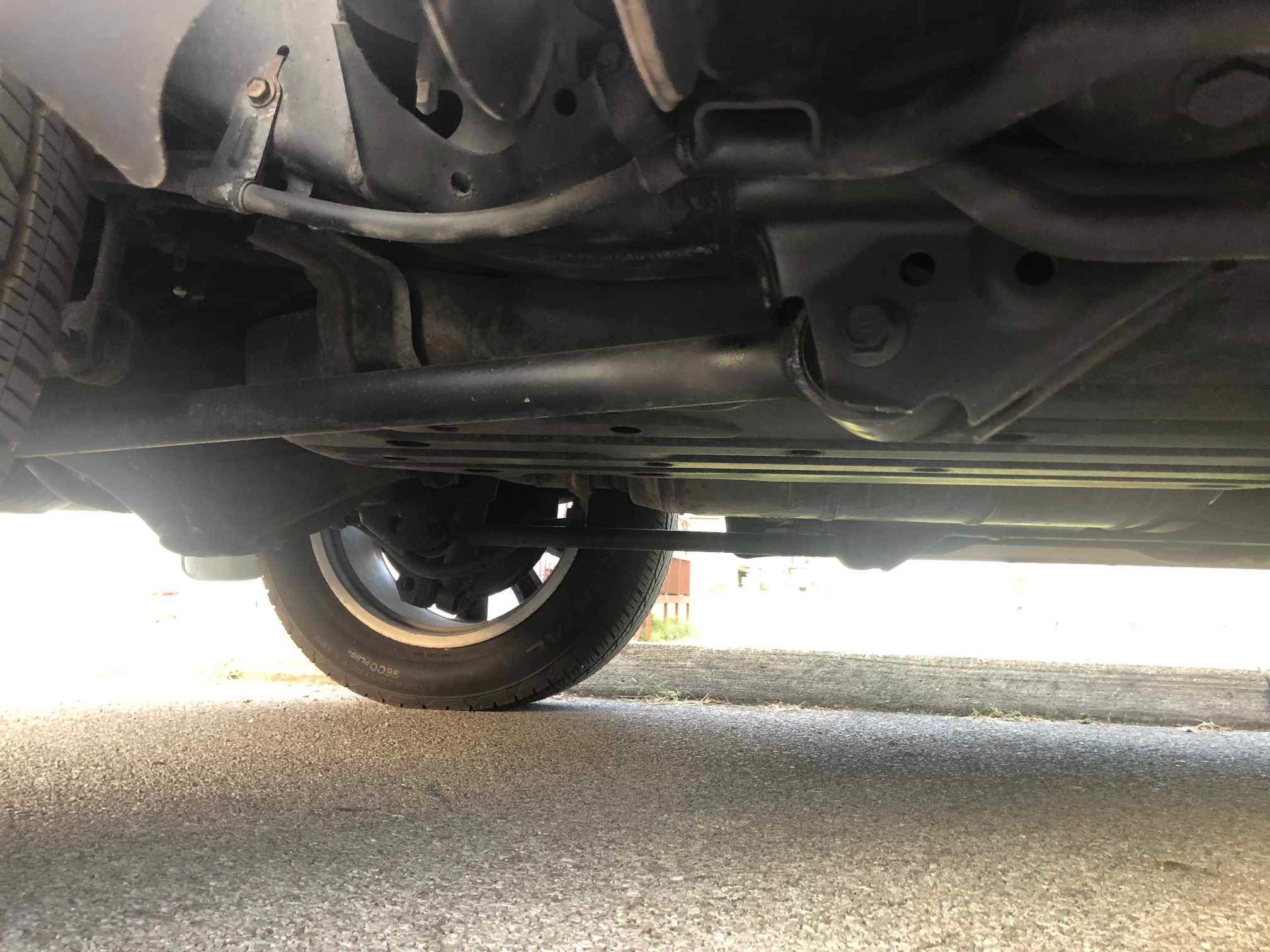

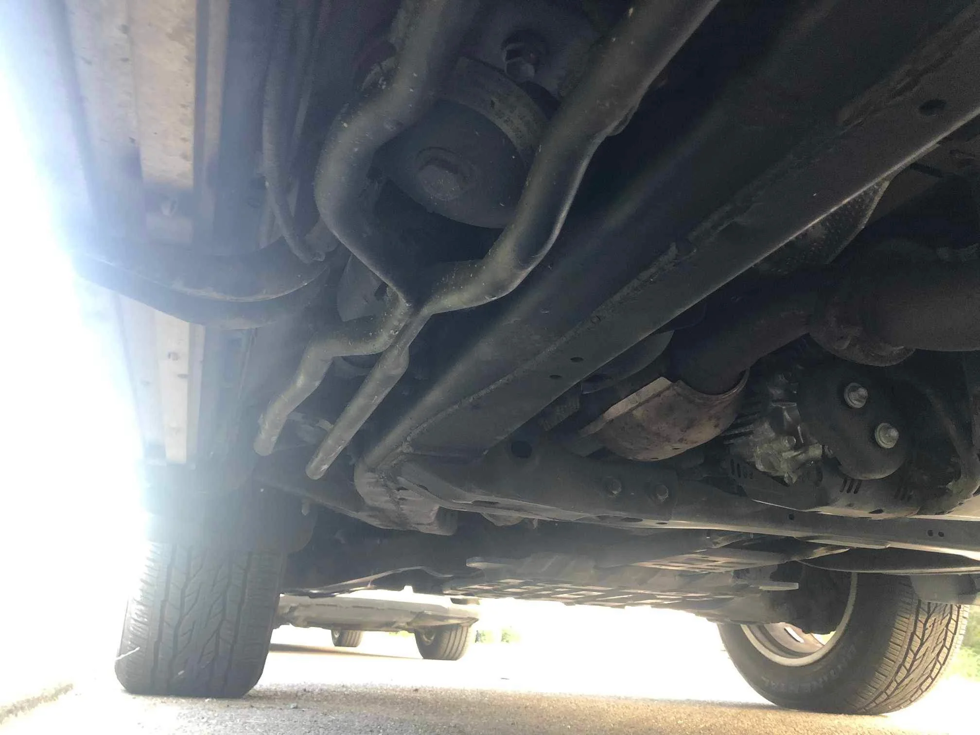

Nov 6, 2024 Replies: 1 Year 2008 Vehicle Model LX570 Vehicle spent its first 50k of life in NY. Frame looks good but some of the front suspension parts concern me. Thoughts? Click to expand...
TheLCProject SILVER Star Joined Feb 26, 2018 Threads 87 Messages 2,244 Location Bay Area, CA Website www.youtube.com Nov 6, 2024 #2 I wouldn't say the frame looks good. It looks like someone has spray painted under there, likely masking the true extent of corrosion. That's enough corrosion already to make nearly every bolt under there fight you or break off.
