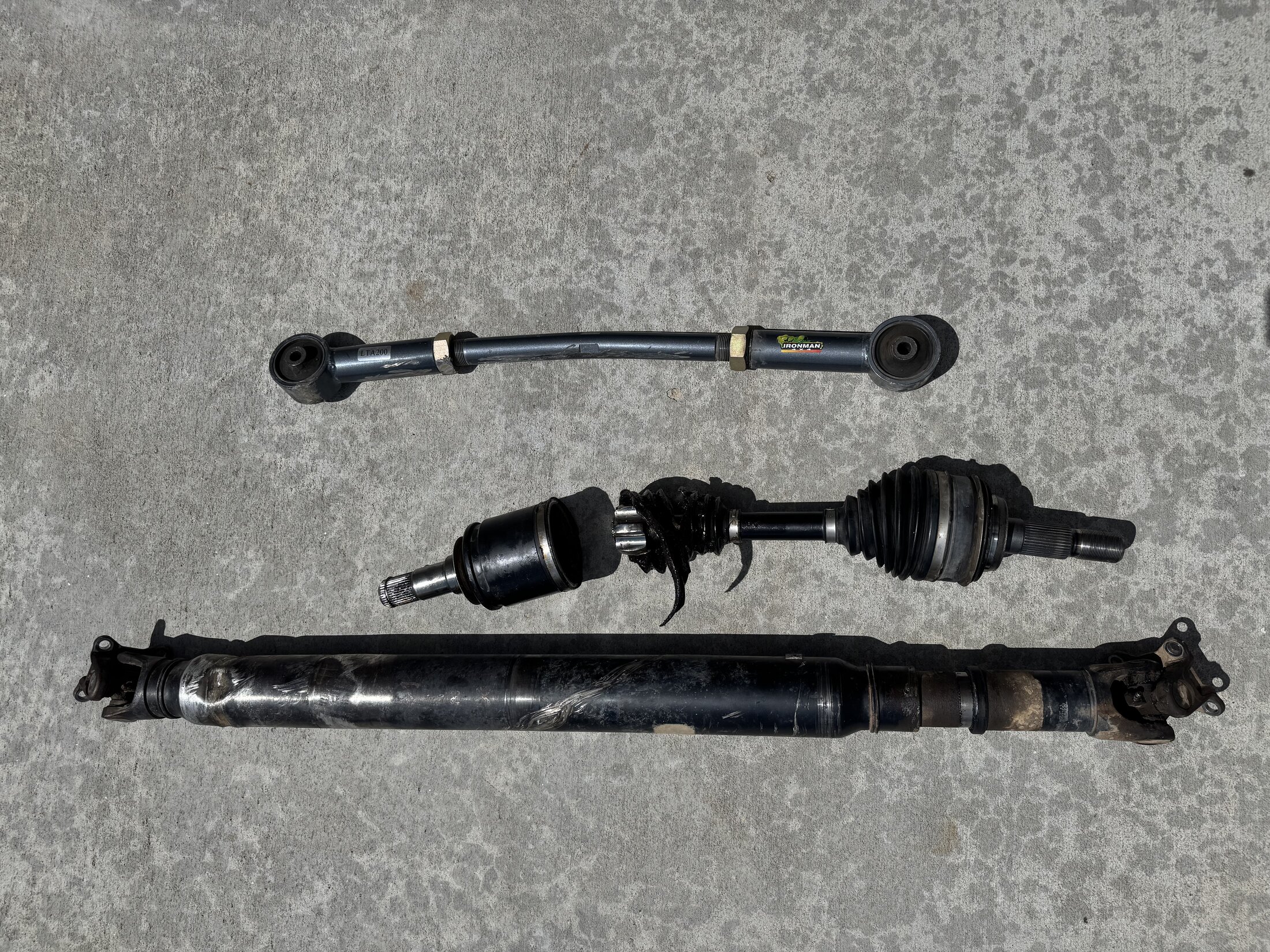

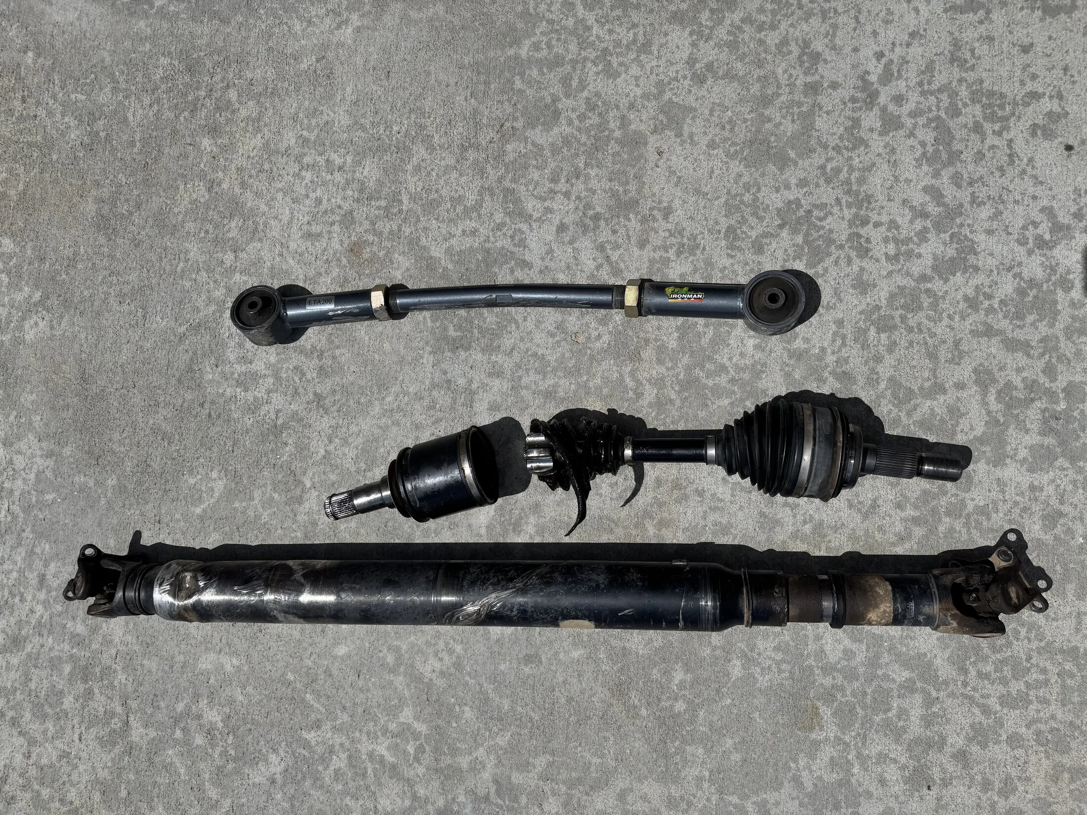

Damage:

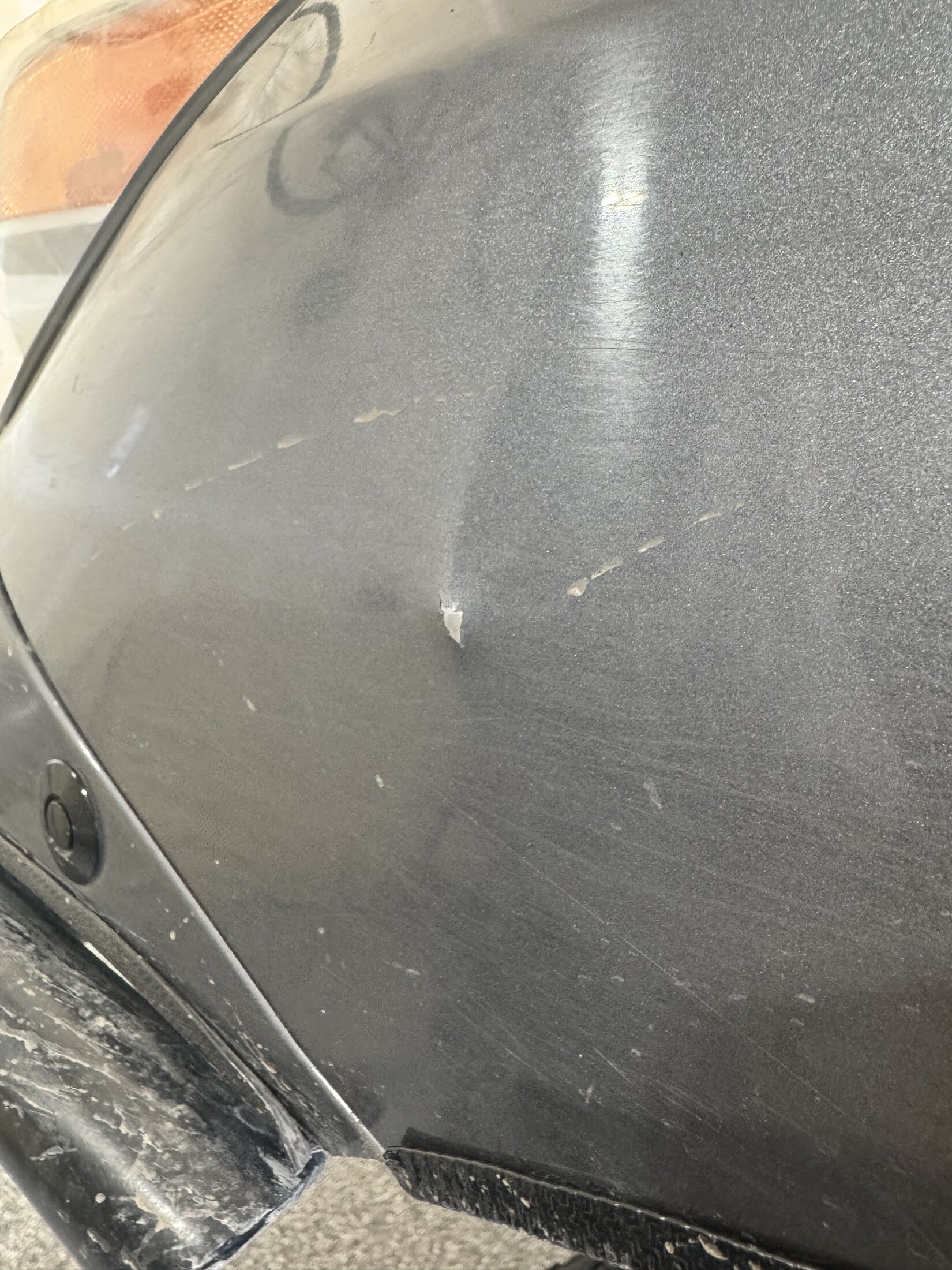

- No body damage was added during this trip.
- Blew apart a CV. I say blew apart because it exploded sending the ball bearings flying, also didn’t break at the shaft like I’ve seen in the past.
- Bent a trailing which I think took place during a hard winch pull when I was hung up. This pull is also what lead to my mechanical failure of my winch.
- My comeup winch broke during this trip, second one I’ve gone through at this point in 5 years. Pretty hard pull and after about 30-60 seconds of pulling it stalled the vehicle. Never experienced this before, usually this and the first comeup I had just work. After testing a bunch of things it was determined by myself and comeup that a gear is likely what failed internally, binding the winch up. I say likely because I’m still hunting for the culprit gear.
- Dented my driveshaft in a good amount and also sheared the zirk fitting off. In a moment of shear stupidity I had parked up after an obstacle directly in front of of a pretty large rock. When it was time to roll again I had forgotten entirely about said rock and drove straight over it, the rock caught the driveshaft and the forced the entire axle off the ground. Tried backing off and that lead to the rock rolling a different way shearing the zirk fitting off and also forcing the driveshaft up into my exhaust slightly pinching the exhaust. It was an expensive stupid oversight. No pictures were taken as myself and some others jacked my rig off the rock. Also drove 1000+ miles home with the dented driveshaft before replacing, honestly shocked it didn't have a bad vibration.

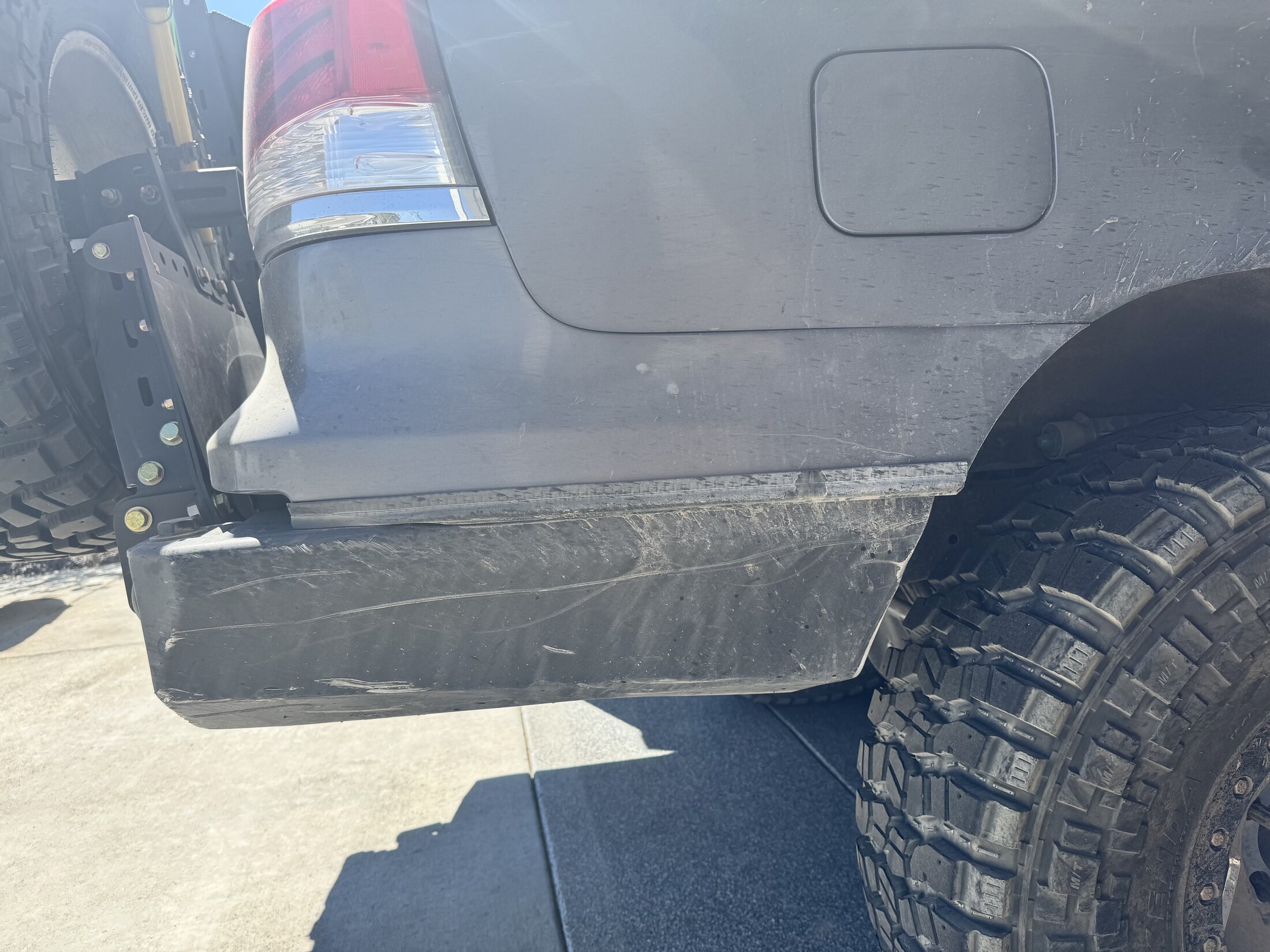

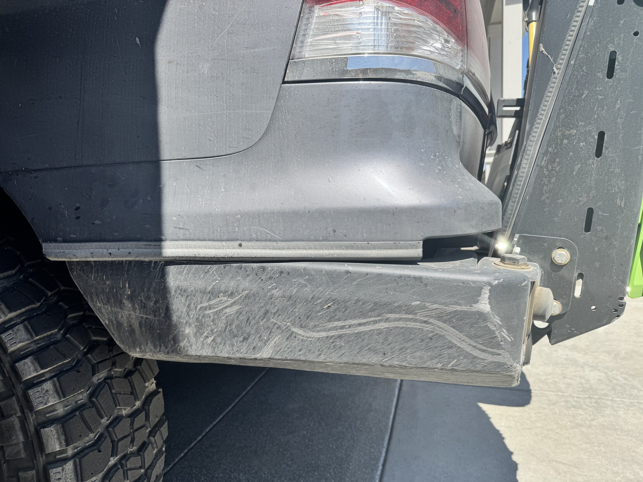

- Dissent rear bumper beaten up and starting to shift up into the body. The bumper and swing outs are still in place and function but I’ve definitely reached the point of using this bumper that it needs to be replaced. What dissent makes are amazing products, for 95% of the people who are overlanding and off-roading. I think that maybe I’ve reached a slightly more aggressive or severe use with my rig and aluminum and big swing outs just don’t cut it anymore. I need something minimal, steel, and likely will be cutting some stuff up in the rear to fit a different rear bumper in the future.
All in all I was expecting body damage so happy nothing new was added.

How much of that shifting do you think was due to the bumper being cut for fitting the 37s?
You know I’m really not sure. I cut that mount as I previously posted in half that’s in the rear of the wheel well, so I lost one bolt out of that part of the mount. However this bumper has been dragged hard on a lot of rocks and some really good hits dropping off shelves for years. I’ll have to post pics next week once I’m back home of what the underside looks like and how I actually started to tear the aluminum on the back end of the bumper.

Also curious about the CV break and whether this happened at max droop? One of the suspected vulnerabilities is getting too much angle on the CVs where they operate in a weaker zone, but also going too far where there is actual binding against in the housing. I think you have Kings and they certainly are one of the more aggressive in droop travel. Perhaps limiting downtravel or adding a diff drop could help? Or even RCVs that allow more angle?

The cv broke while in reverse, locked up, and it was actually stuffed on a rock. It was a tight squeeze and my spotter was worried I was going to slide off my front bumper and tag the headlight with the rock. So I was working it back and forth trying to find the right spot to squeeze past the rocks on either side. Backed up one more time and just gave it a little too much.
I’ve thought about going to rcv’s however I broke my intermediate shaft a couple months ago in Moab when I launched it a little hard off a climb. When the cv didn’t let go and that broke instead it made me realize I’d rather carry a cv and swap that out quickly instead of having to remove both cv’s, take the skids off, drain the gear oil, all to replace the next weakest link. I carry an intermediate shaft in the housing since then but I hope I don’t have to replace it out in the woods.
