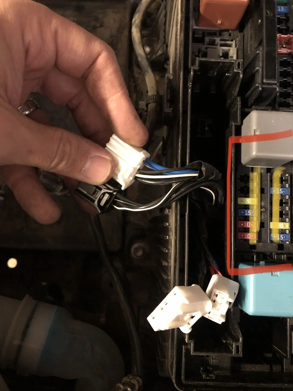

I did take some more measurements today. The fuses in the red box below all measured the same as the EFI NO.2 fuse. ~300 ohm referenced to ground on both terminals. The INJ fuse also measured the same. If either of the two harness are connected, the EFI NO.2 fuse reads ~300 ohms. The majority of the wires appear to be ground wires. The yellow bars are what appear to be a common rail in the layout of that portion of the fuse box.
The crappy part of all of this is, I can’t get the ECM harness to give the same reading on the other end with all other considerations unchanged.

Time for an update! I dropped it off at the local Toyota store last Saturday. They had the truck most of the week, and couldn’t get the symptom to replicate. I picked the truck up Wednesday evening, drove it home and it did just fine. Started it up yesterday morning, and the check engine light was on, but not in limp mode. It went into limp mode a little later.
I got to thinking about it last night. What operates when the truck is turned off that may be tied to the emissions.
I dropped my auxiliary tank this morning, and here’s what I found:
Dang! Good find. That's like looking for a needle in a hay stack. That was a s*** ton of work, but your persistence has paid off.
Has me going back to look at pics of my own install to see if I have that same vulnerability. Funny thing is I don't see a connector on mine in that position. My wire is loomed and goes all the way directly into the canister. On my '09 LX at least.
Props for sticking with it and finding the culprit. It'll likely help future people running into this problem. Should be an easy fix from here.
Curious if anyone of the other LRA tank owners have similar chafe in this area...Great find and I hope this clears all of your problems. For S&Gs, what does that blue wire do for that evap box?
