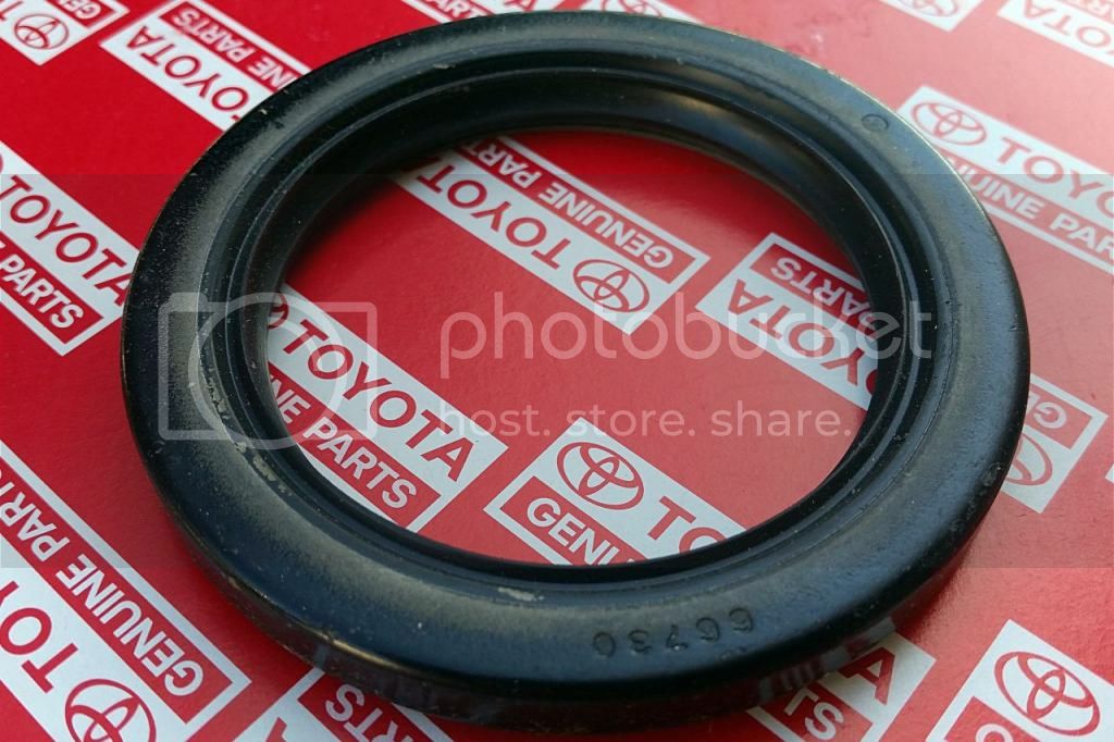

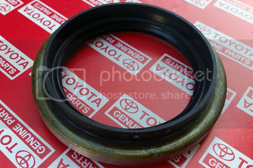

O'Reilly web site lists part number 226285 as the front and rear wheeling seal. It doesn't have the thicker lip like the OEM rear bearing seal. I am also unable to find any axle seal info from their web site. I hope they ordered the right seals for you.
Rear bearing seal.

Front bearing seal.
