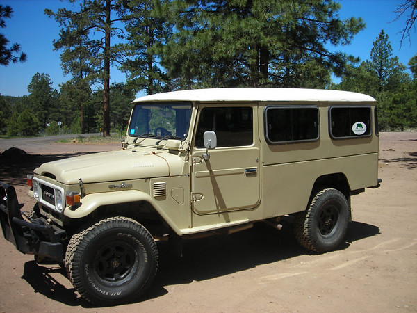

1983 (Build date 9/82) FJ45 Troop Carrier
Right Hand Drive (OZ Import)
2F Petrol 6 Cylinder, Dual Fuel Conversion with Propane
H41 Four Speed Trans
Fairey Overdrive
Old Man Emu Light/Medium Suspension (Thanks Kurt @ Cruiser Outfitters!)
295/75R16 BF Goodrich All-Terrains on American Racing Chambers wheels. The tires are a low glass compound made by BFG for Expeditions West and used on his Arctic Circle Expedition in 2007. Great tires!

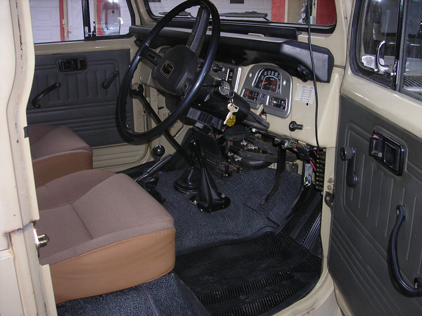

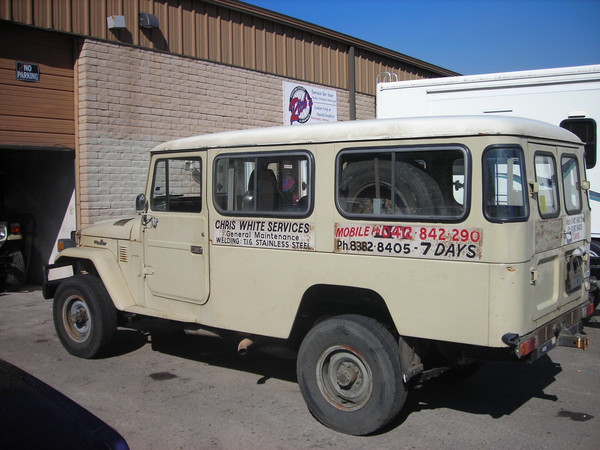

I picked her up in October of 2007, and have slowly but surely been upgrading/modding her for my family overlanding vehicle. Some light rust repair, followed by an upgrade of the seating to Bestop Trailmax Pro Thermal (Heated) front seats, and a Trailmax folding seat for the rear were installed, along with a nice moulded SOR carpet kit.

I like the height of the tires, but would go narrower. The traction is excellent, but I still get some rubbing on the steering and fenders under full flex. I think the 295s are one reason I'm getting good mileage, as they give a bit of an overdrive.
Interior noise is much louder than the 80 series, but not as much as my old 40 series for some reason....maybe over the years I've just lost some hearing...:rolleyes:
I get in Skeddy's 100 series and just about melt in comfort...
I'm still working on some additional sound deadening on the fender wells and cargo area. I don't really notice the noise, even in Mexico, but it was really hard to do any listening to books on tape...but then we only had the one stock 4x6 speaker by the passenger at the time. Since then I've "upgraded" to a couple of really cheesy 8" boxes from Crap Mart ($20/pair) that give more volume....
-H-
