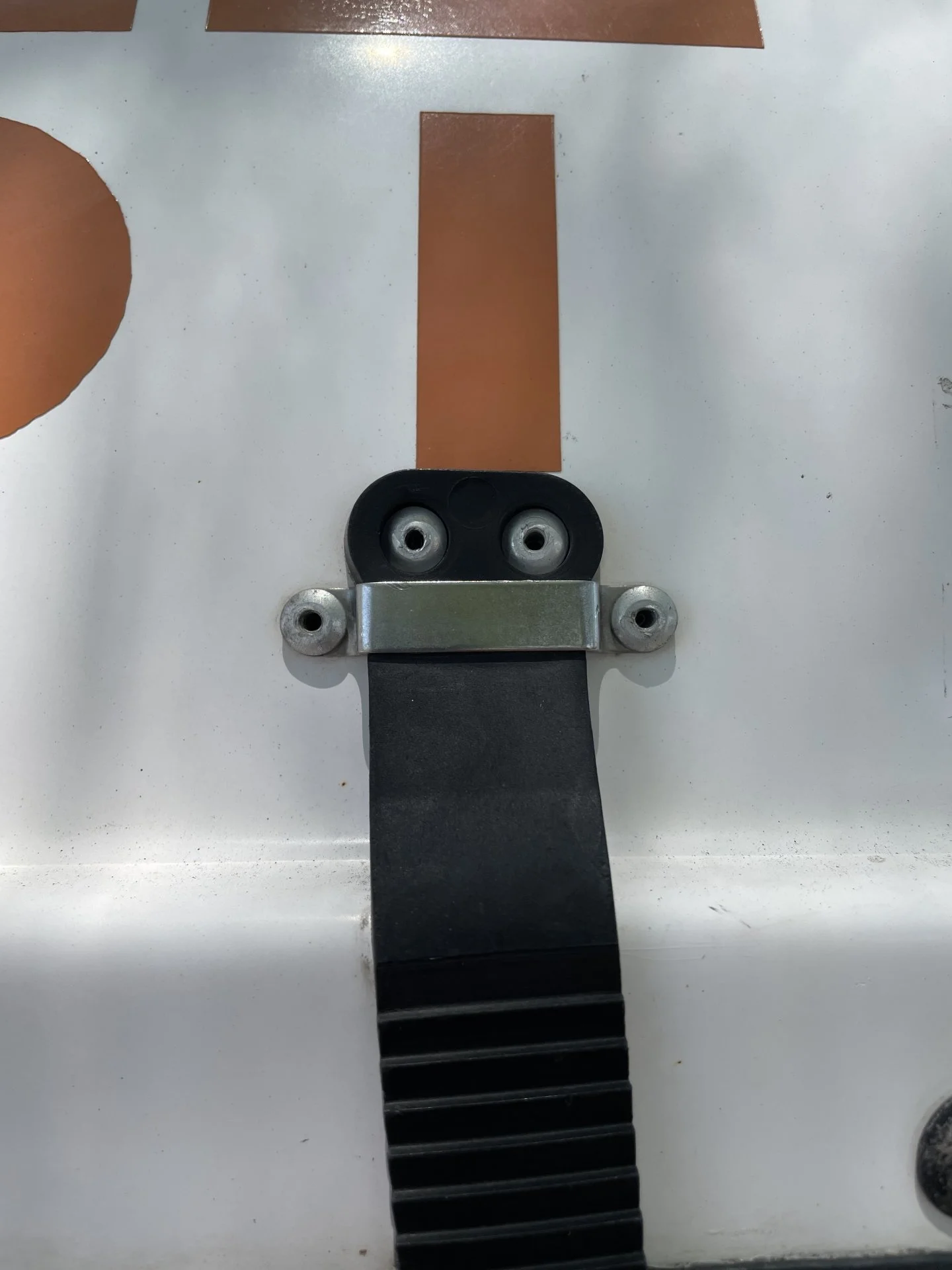

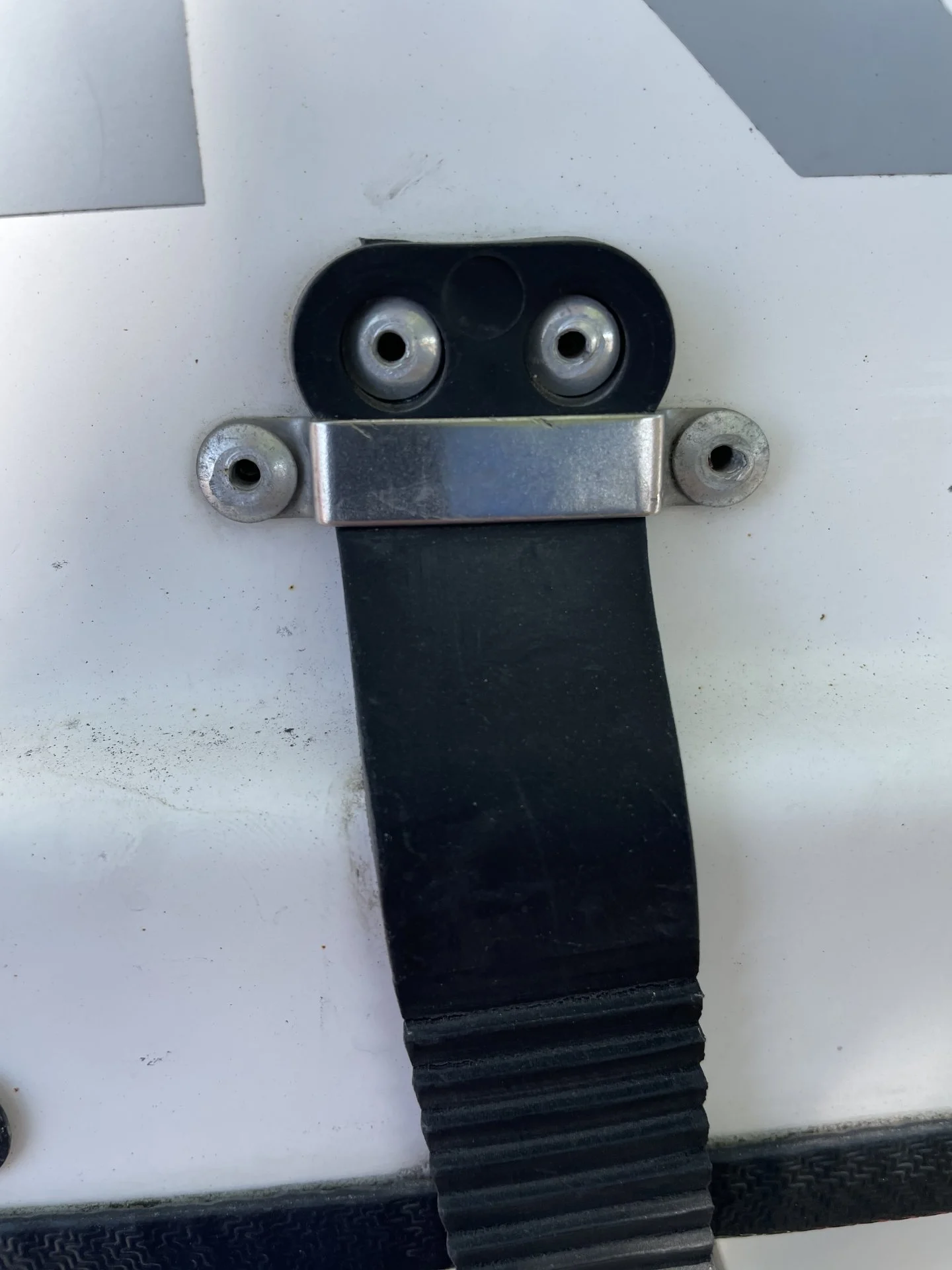

Hey guys,
while taking our Roofnest rooftop tent down my girl pulled a little to hard on the ratchet strap and broke the rubber.
Has anyone replaced one of these? And how do you get these bolts out?
Thanks for taking the time to read my post.
The "bolts" are rivets. They have to be drilled out and replaced with new pop rivets. You can look up rivet removal on youtube or google and see how they work and what need to be done to fix it.
