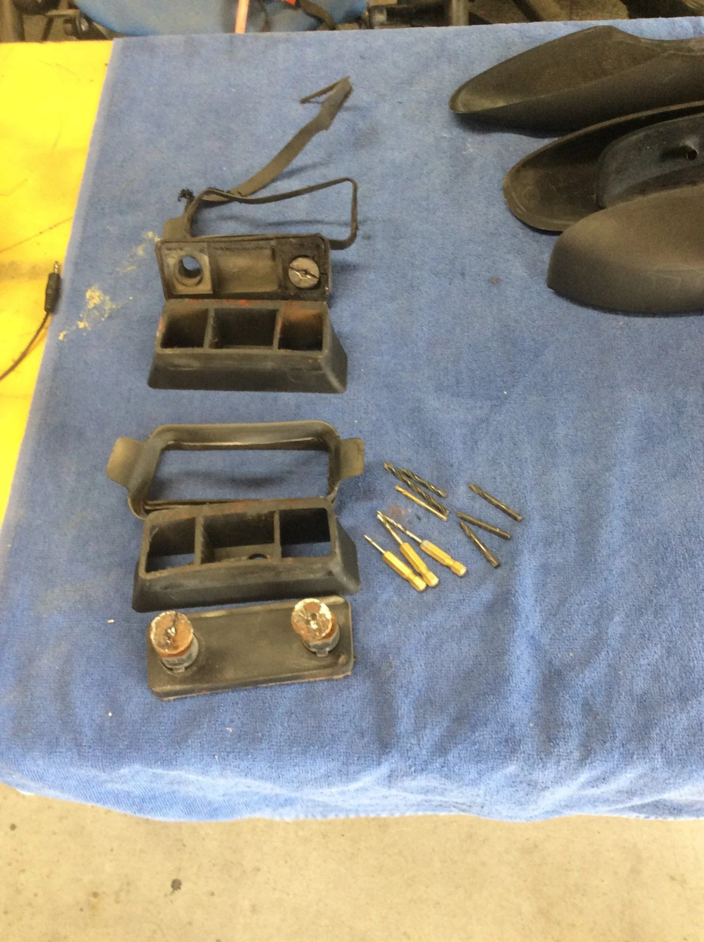

Now that I have one out to see diameter, depth, etc, I'm hoping that will help me feel more confident when drilling. I'll using a similar speed out, but the metal is so soft it just chews it up. I tried @gatormark91 approach with 4 different sizes, but again, the extractor just chewed through.
This was supposed to be a simple project to knock out while I took a break from my HID projector retrofit. On to the next bolt though!

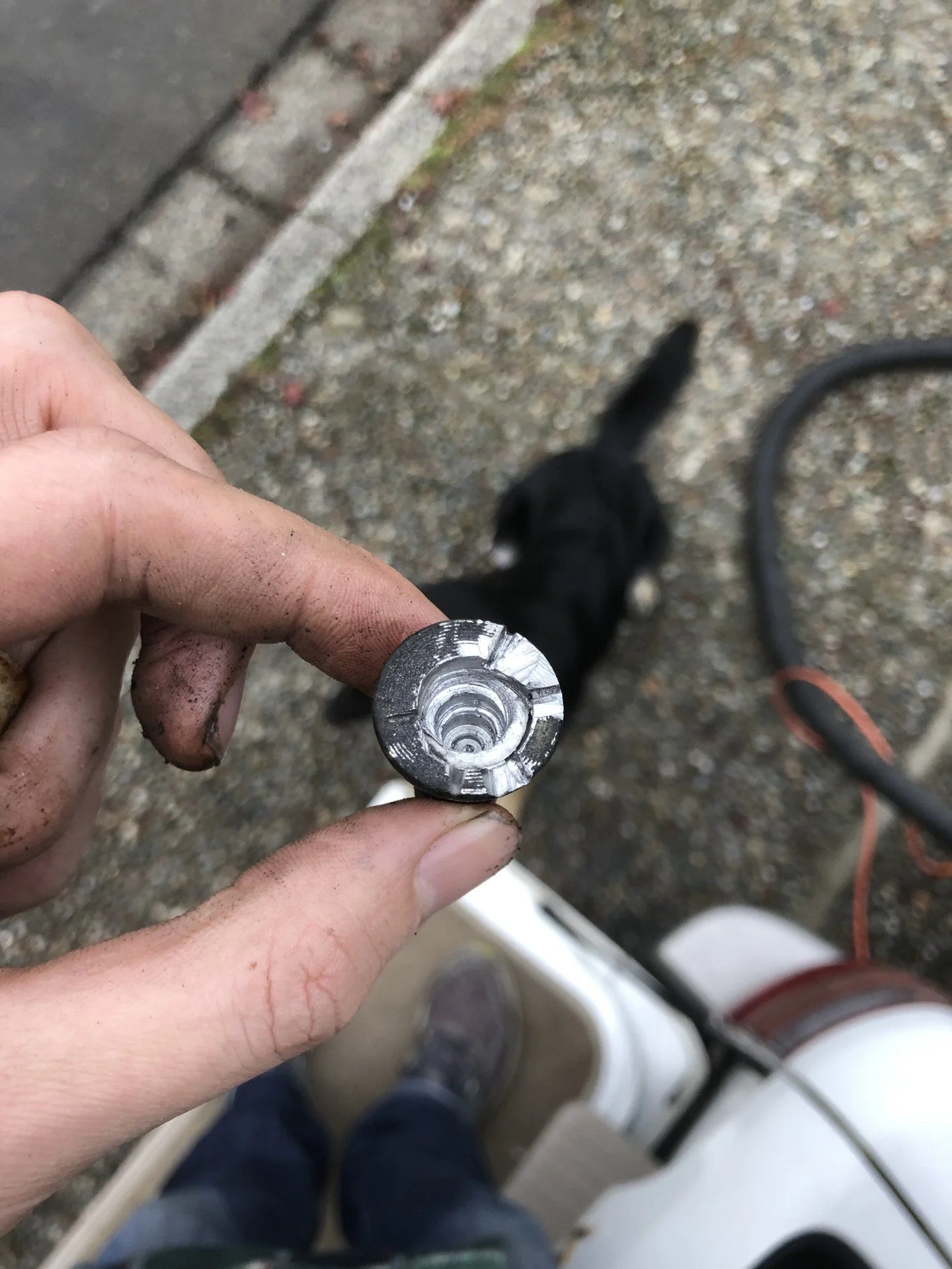

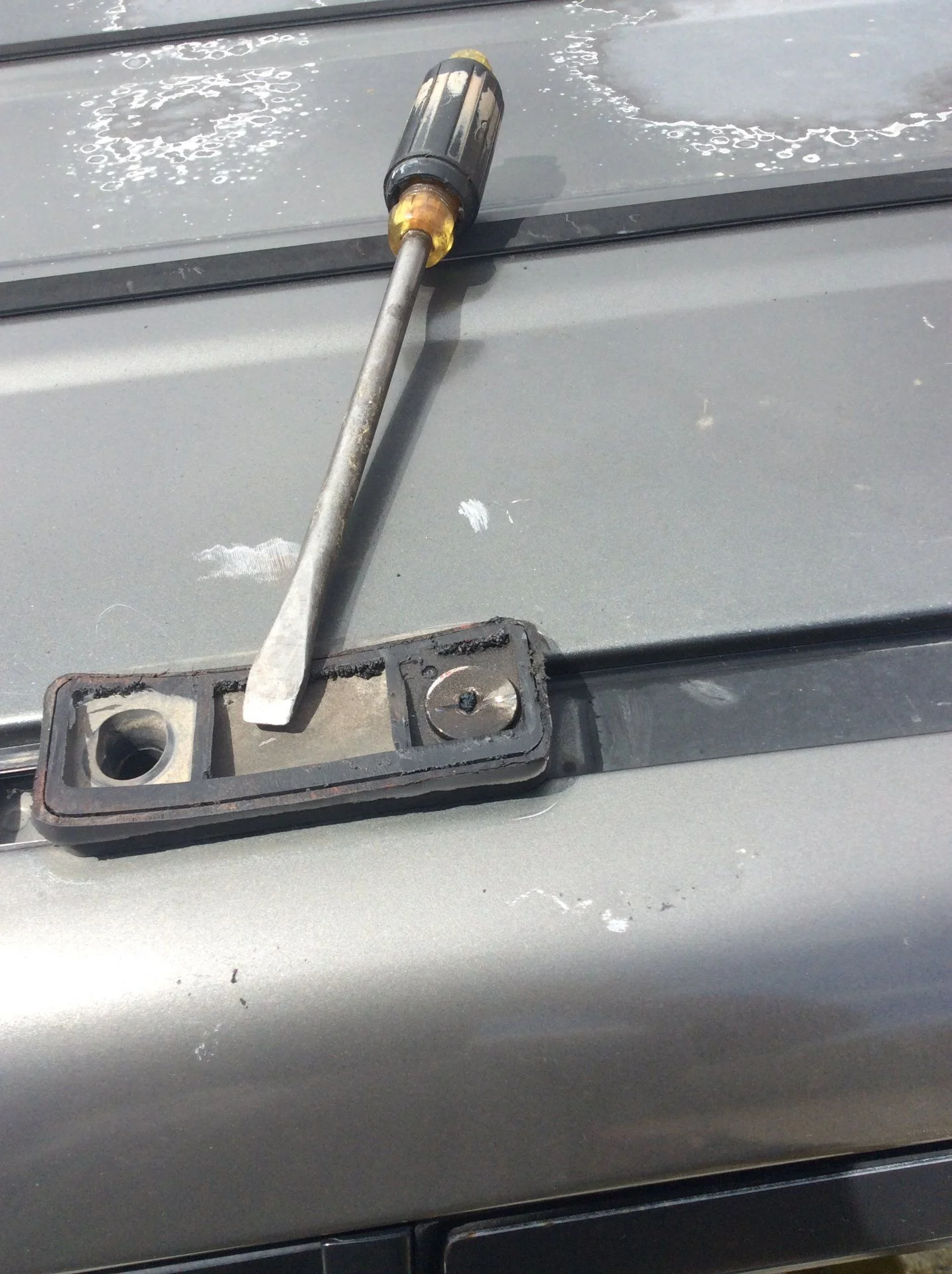

I used a Dremel to cut a notch across the top, then I put the blade of a flathead screwdriver in the notch and hammered on it until it started to turn. Depending on which bolt is stuck, you may have difficulty getting a Dremel on the head. A fellow mud member was generous enough to send me his spare roofrack feet so I was able to cut my feet down to access the bolt.
The stuck one on mine is the rear-most torx on the driver's side. Got all 7 of 'em no problem except for that one! Arg. Thanks, I was considering the dremel method either allowing me to get a big flathead in there to turn it or hit the notch with the flat head. Either way, thanks, here's hopin!
That's a better one than the middle ones that are deep down in the feet. I ended up cutting multiple notches as it started to turn. Good luck!
