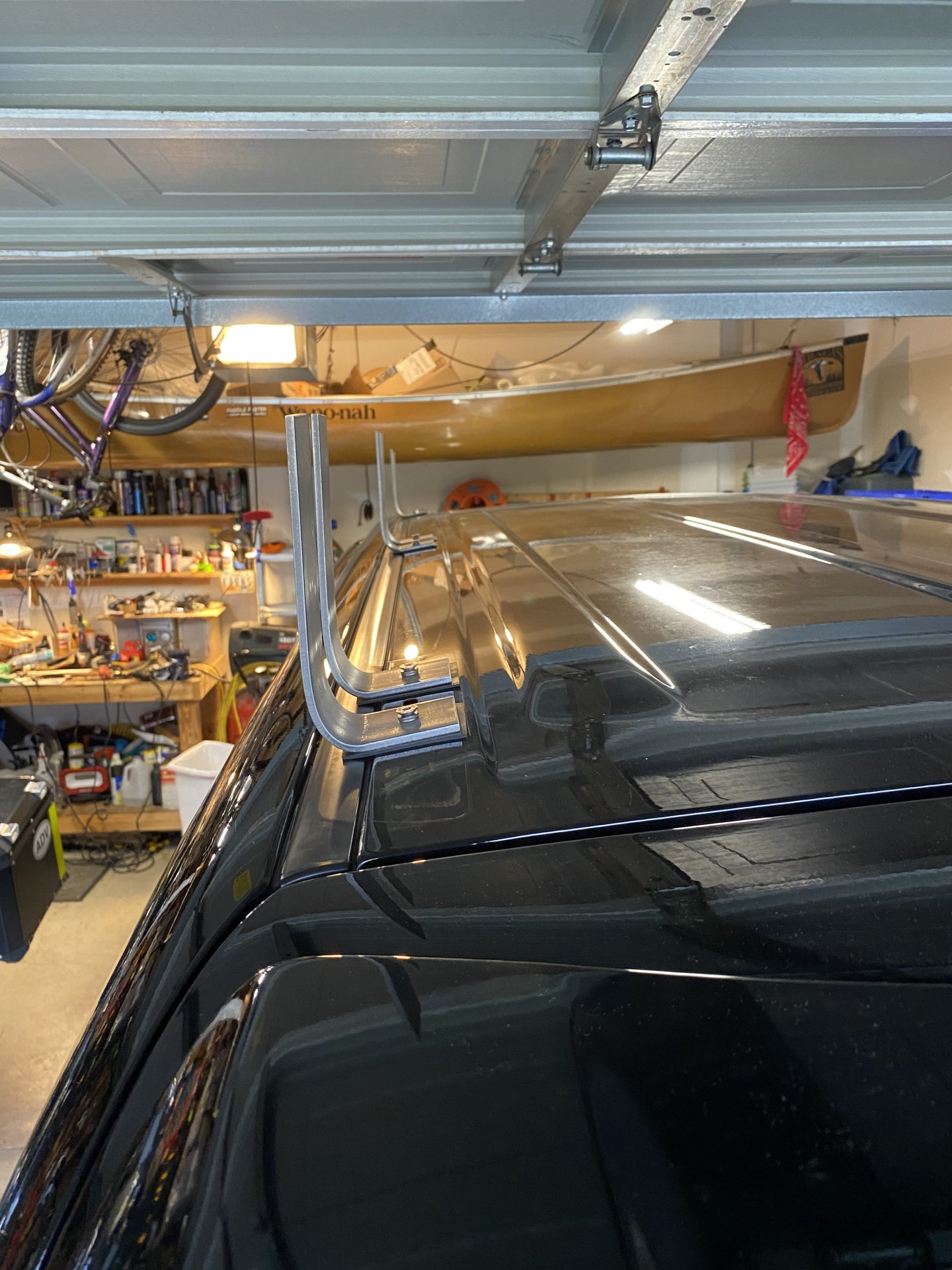

I ended up making my own brackets.
There are several issues with our mounting points. Each spot has 2 holes for each mount. The two front mounting spots have holes that are about 8” apart and the middle and back spots have holes that are about 6” apart.
Then there is the angle of the roof that makes each bracket angle off from 90 degrees.
Yeah. The hole spacing on the second gen is wider than the first gen for two off the three pairs of mounts. I modded the sherpas to work and it was a pain. And a bit of a cludge.
