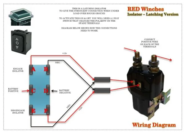

When Wiring this dash switch to albright am I using ALL 6 posts on this switch or just top two and bottom two? This winch is great but man theres a lot of extra wiring to go wrong. Im installing this switch and albright in addition to the lodar wireless unit that I thought would take care of everything.
