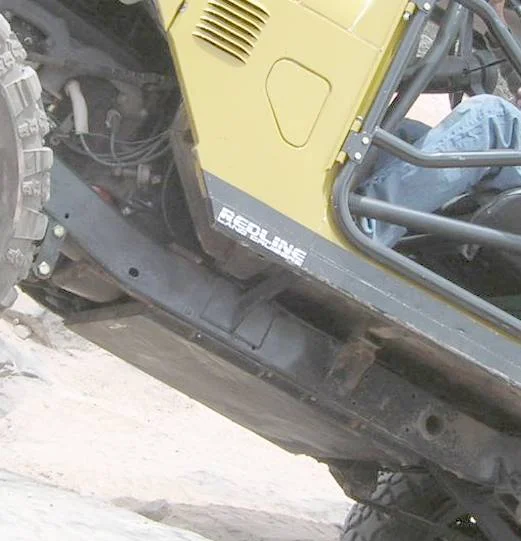

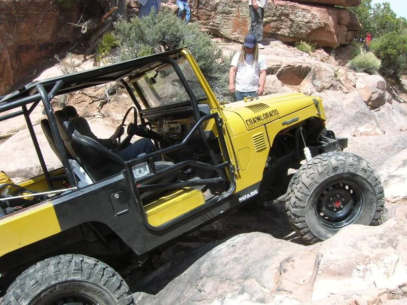

Mike,
I did mine like that.. 3/16" 2x2 tube.. Cut the Rocker so it had enughf lip to still clear the rounded off corners of the 2x2, Stitch welded it on the back side all the way down, and welded up the front side..
Since i already had the bondo out on the body repair (Black Area), i smoothed it all out and shot it with paint.
attachment.php
The Cage and Slider is tied in with this piece of thick wall round tube.. Id suggest doing atleast 2, maybe 3 frame ties..
attachment.php
i only have this one right now, and ive Slammed it enough to push up & Tweak the rear fender sheet metal
