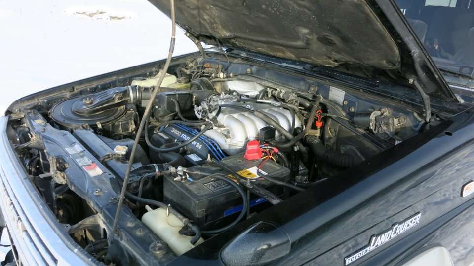

If you really want to swap, I recommend using an older engine. It will have less electronics and be an easier install. Engine's that bolt up to the same transmission series are the 5VZFE (3.4l V6) and the 1UZFE (4.0l V8). Both of these have been put into the same chassis with good success.
Here is a picture of a 5VZFE swapped for example. Looks perfect in there!
