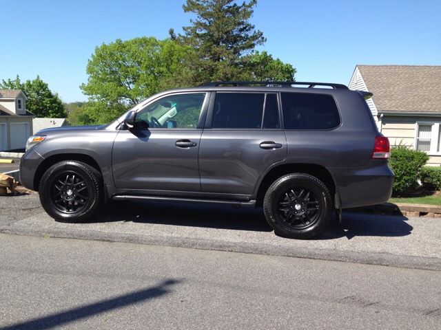

First pic is the ms2s second is the latitudes on the LX wheels, third is the Latitudes on the BBSs and finally the KOs on TRDs.
