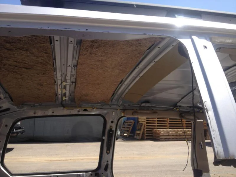

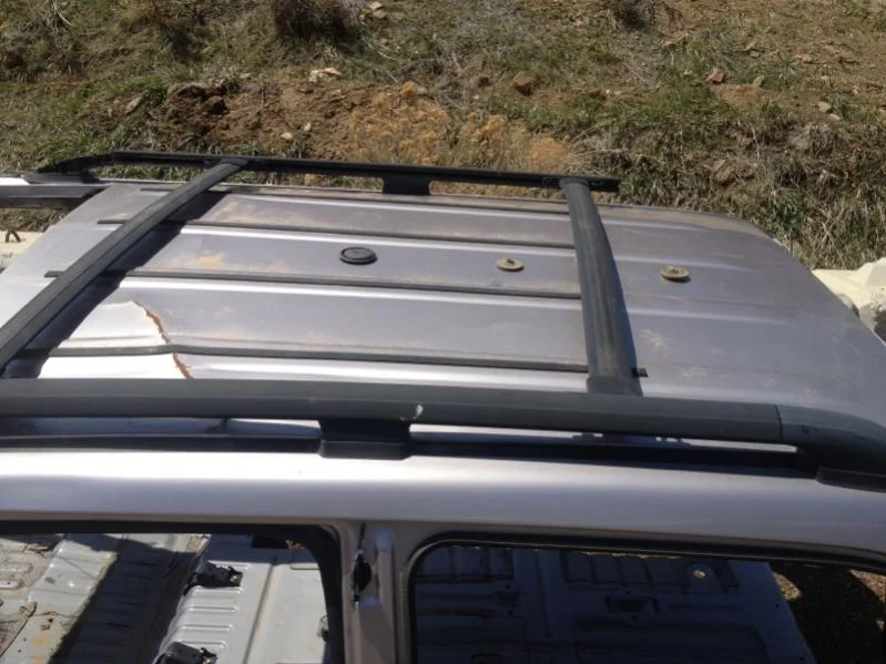

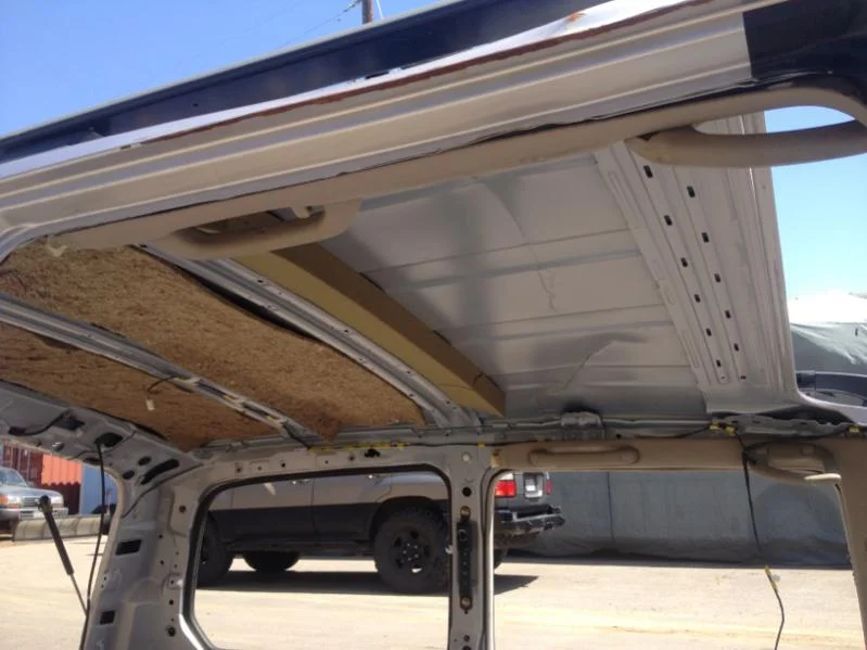

I took these photos in trying to figure out where I'm going to install three NMO mounts on my 100. Obviously the sunroof is not in place so that's something to consider. The stuff put on the roof was clear of the roof braces below.
I still haven't gotten around to dropping the headliner and doing this so by all means, please beat me to this.
