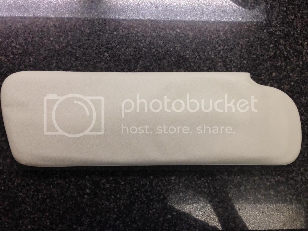

After cleaning with SEM's soap, they looked much better.

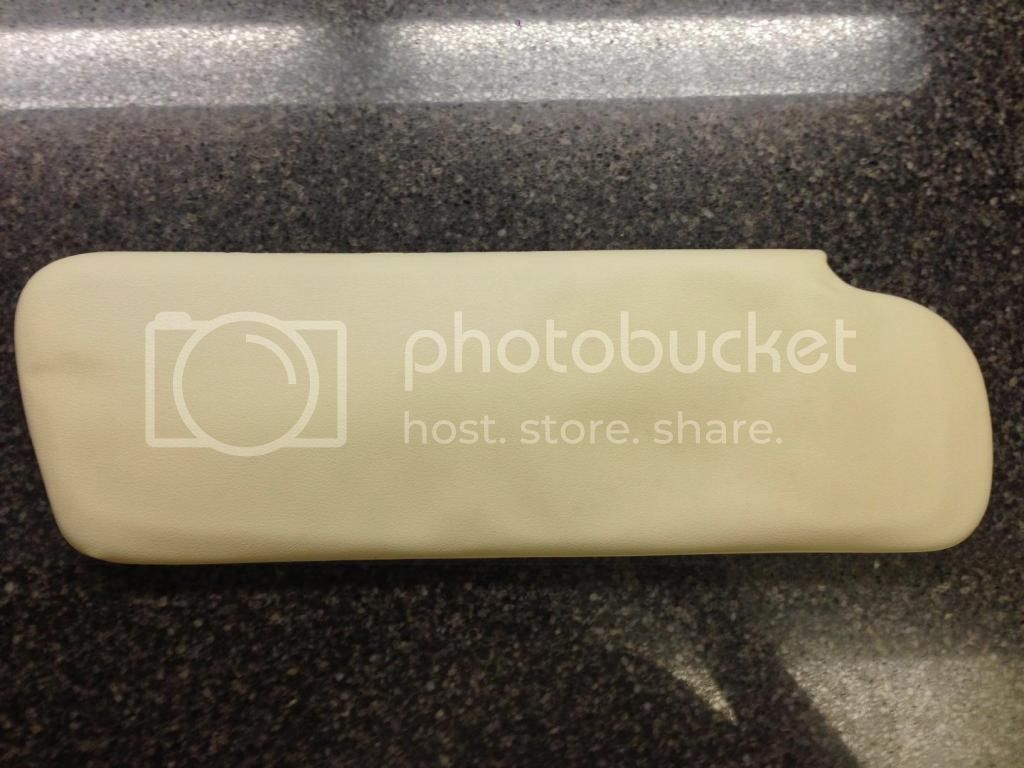

They were still a little dingy, so I decided to dye them using SEM's Color Coat product. Super White seemed to be a pretty close match to the original color. I followed the instructions, cleaning them with their vinyl prep spray first. The results came out very good. If they hold up, I will continue with the door panels to change them back to their original color and add the results here. Hopefully this will give some of you an idea of what to expect if you try this.
