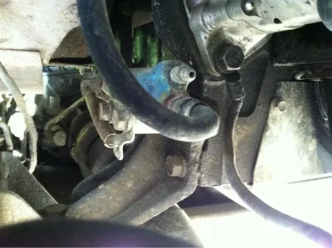

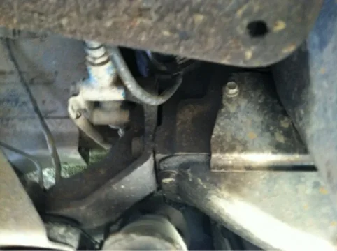

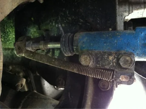

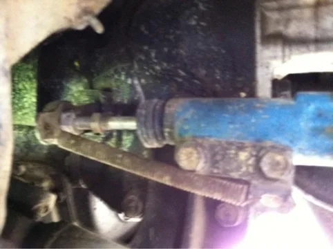

Second, can you guys take a good pick for the clutch slave cylinder bracket on a 78 or newer model. For some reason I am missing such bracket and cant figure out how it looks or how it goes, if someone has a spare one please let me know.

Best I could do Juan...
:beer: Ramon

I am trying to picture in my head what you are dealing with here. Is it the same as what Ramon posted up higher but on opposite side. I know SOR says they are the same from like 77 - 84.
The clutch arm will be the same no matter what side it is on. Only change i can think of was from 3 speed to 4 speed. The slave cylinder will be the same also from side to side.
Now i did put a later ( i think 78 year model ) transmission / transfercase in my fj45 and i put it on the drivers side.
