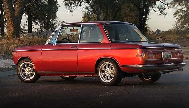

This is what I'm talking about;).........................................
Thanks, Helpy Helperton! Im sure you meant to post in my other thread titled "What do you think of a BMW 2002?":mad:
:flipoff2:
BTW, it thinks you are fugly, too;)
I like it/them!
If I were to own an old Bimmer that would be the one!
