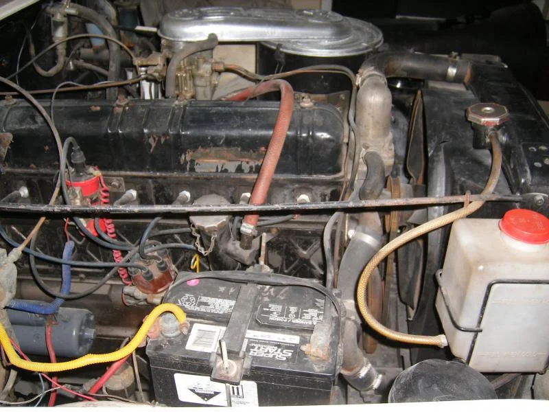

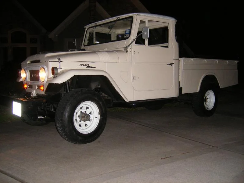

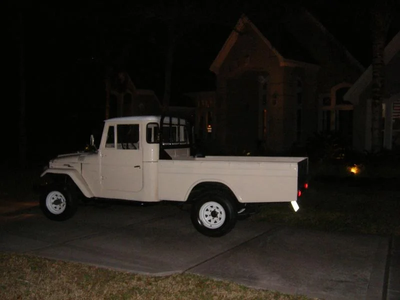

'65 FJ45 in the final stages :clap: and ready to cruise :steer: to a new home. Other than the 2 1/2" lift, heavy duty bumper and tube side steps it is strickly stock, to include the 6-cyl engine. Finally found a headache rack that was installed yesterday.
'65 additional photos
Light desert tan color with matching Raptor-color bedliner in bed and cab floor. Traditional white bezel and cap. The tailgate had been abducted-by-aliens :confused: years ago, so the PO constructed a heavy duty wire gate that folds down and/or removes (not too bad).

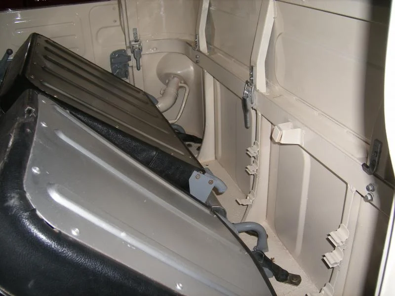

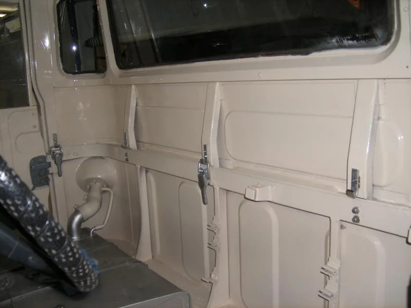

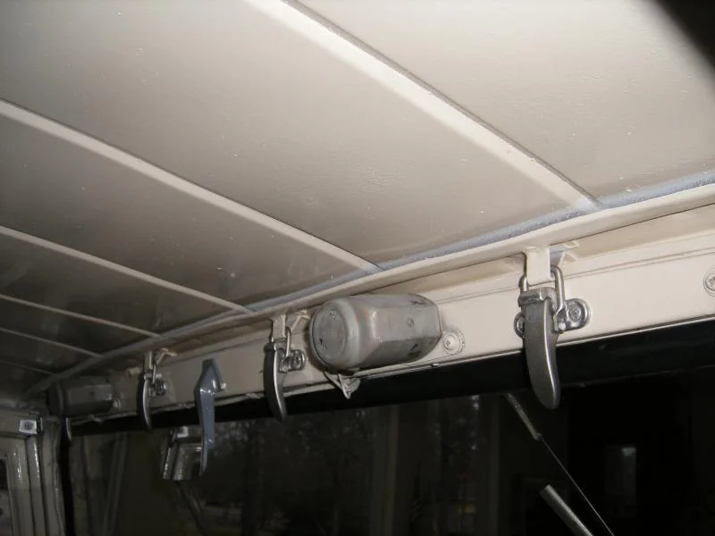

Interior Roof attachments
Michael,
Thanks for the nice words. Photos are of my '65, I also checked and my '66 FJ45 has the same configuration. Both have the removable top. The wrap-around cab can also be seperated from the top and the cab bed.
The front of the top is held in place with the 4 hook & latches. The rear and side of the top have removable bolts along the inside lip/rail and underneath where the window frame meets the top.
Hope this helps. Hooah! Major Don
