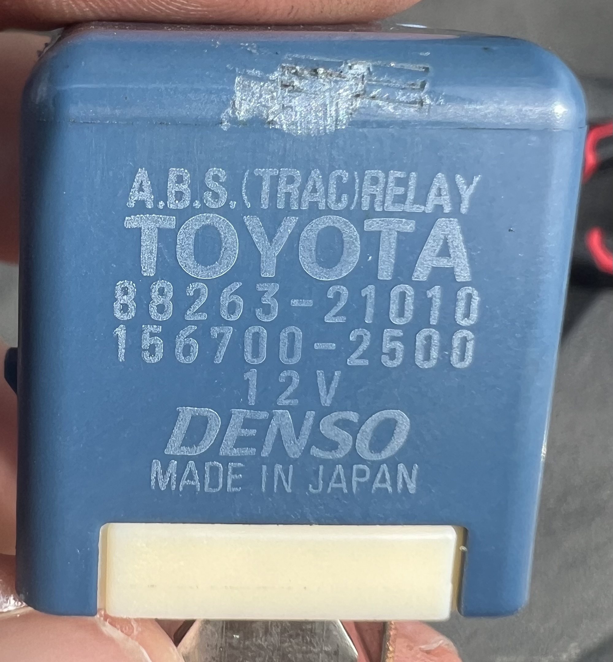

I performed a front sensor lift with no issues. The next day I did the rear and things took a turn. AHC was functioning I put in LO, then N, then HI and it was clear things were not right, I no longer heard the pump. I tried to drop back to LO and N and on the dash it just blinks, no arrow.
I do not have the system error appearing on the infotainment screen or gauge screen.
I read for codes:
P1603 (eprom malfunction)
P1605 ( keep alive memory test failure)
B1443 (something with climate control)
I checked All fuses other than the 50 amp AHC fuse in the engine bay, it looks good but I was not sure how to remove and test the bus, if that’s what it’s called. I checked the AHC relay and that seemed good. I checked the 20 amp AHC fuse on the passenger side, also good.
I tried clearing the DTC codes, no change no new codes.
After sitting for an hour at the kids soccer practice it seemed to eventually drop to the N position. I had a chance to read codes again.
Now when I read for codes I get:
B1443 (non descript climate control)
C1756 (Suspension Control Relay Malfunction)
C1781 (Steering Angle Sensor Circuit)
B15EC (Backup Battery Degradation)((seems to be related to telematics communication that is sunset anyways))
It seems there is a communication issue. What’s super odd is I set to LO and the front came up, not down. But I did not hear the pump. After getting out I could see the rear did drop, but the front didn’t, I believe that’s why I thought the front raised. At the moment I have the southern squat going on. But after I put the transmission in drive the downward arrow appeared and the front dropped. Still blinking LO. After driving a few hundred feet it’s now showing as N on the dash and ride high looks correct for a sensor lift.
Other side effects include the auto leveling headlights, unfortunately they are aimed super high and I’m blasting oncoming traffic at night.
No clue what to do next. Adjusting the sensors back does nothing. I have not heard the pump at all. I’m halfway through the main AHC thread and have done quite a few searches here and Google and am not finding anything relevant. Apologies if I’ve missed something obvious.
****Resolution was replacing the AHC relay. No DTC codes returned after a clear. AHC functioning normally.
