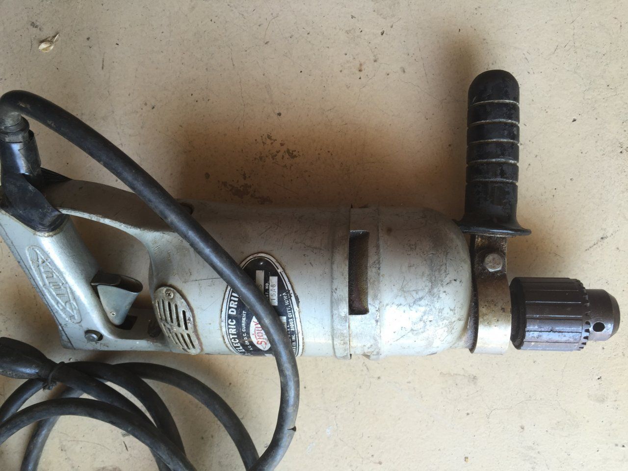

The chuck on this drill is frozen and I would like to replace it. Does anyone know how to remove it and how to find the proper replacement?

To remove you put a drill bit that fits snug in one of the holes in the chuck and hit it with a hammer. They are only screwed on.
OK, so I have been soaking this thing in PB Blaster every night since I posted. I have been whaling on it with a dead blow hammer every afternoon when I get home from working. It is not budging.
This drill is old, but it is nice and I would like to make it usable. I'm afraid that heat would ruin it. Any other ideas?

Finally a tech question a carpenter might have advice on. Put some kind of cylinder larger than the smaller diameter upper neck but smaller than the chuck throat. By the looks of it maybe a short piece of pipe or even PVC around 1.5" or there abouts. Pop it hard with a hammer downwards. You don't need to use a dead blow since you are pounding the cylinder, spacer, not the tool. It will dislodge the corrosion or bimetallic seize between the chuck cylinder and bit grabbing neck. Once you break the seized metal they will rotate independently as meant to be and the PB will be able to do its thing and you will be back in business. It happens a lot to our drills when they live in an outside work environment getting crusty with moisture. A couple of really hard good pops and you will be back in business.
I don't know if that one will have it, but on the newer ones there is a hex under the retaining screw inside. You can put an allen socket in and using an impact, remove the chuck that way.
I'll bet that drill doesn't have a brake, so trying to turn the thing by hand is probably frustrating.
You have a welder, grab a cheap socket, weld it to the outer end, and use an impact to pull that B*&^h off!!
