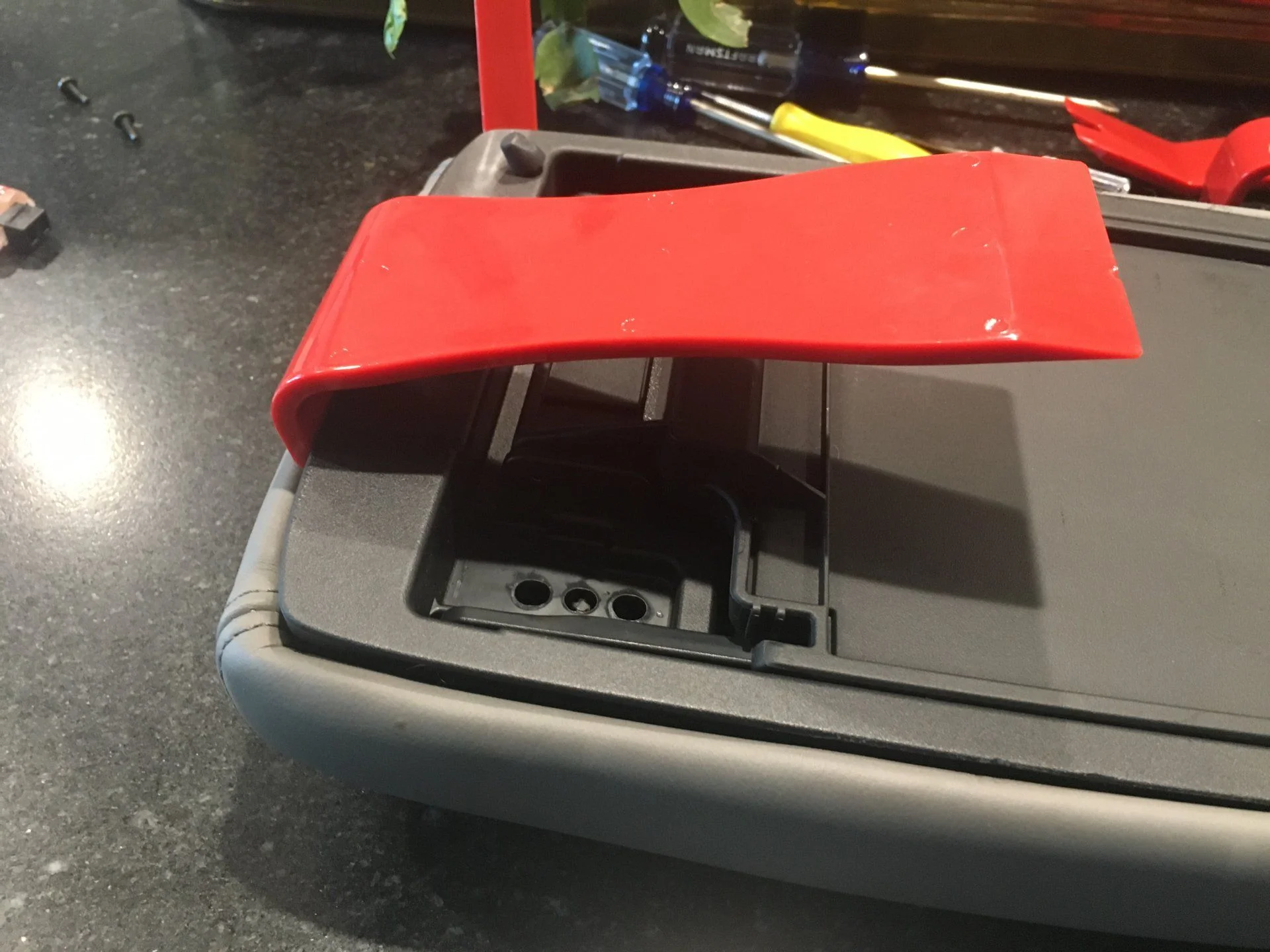

3. Gently break apart the plastic interior from the leather cap. I used the trim removal tools I purchased from Northern Tool during my lock actuator motor replacement. Just go slow and make your way around the edges. Note the picture in step 6 to see how many and what kind of joints you are breaking:

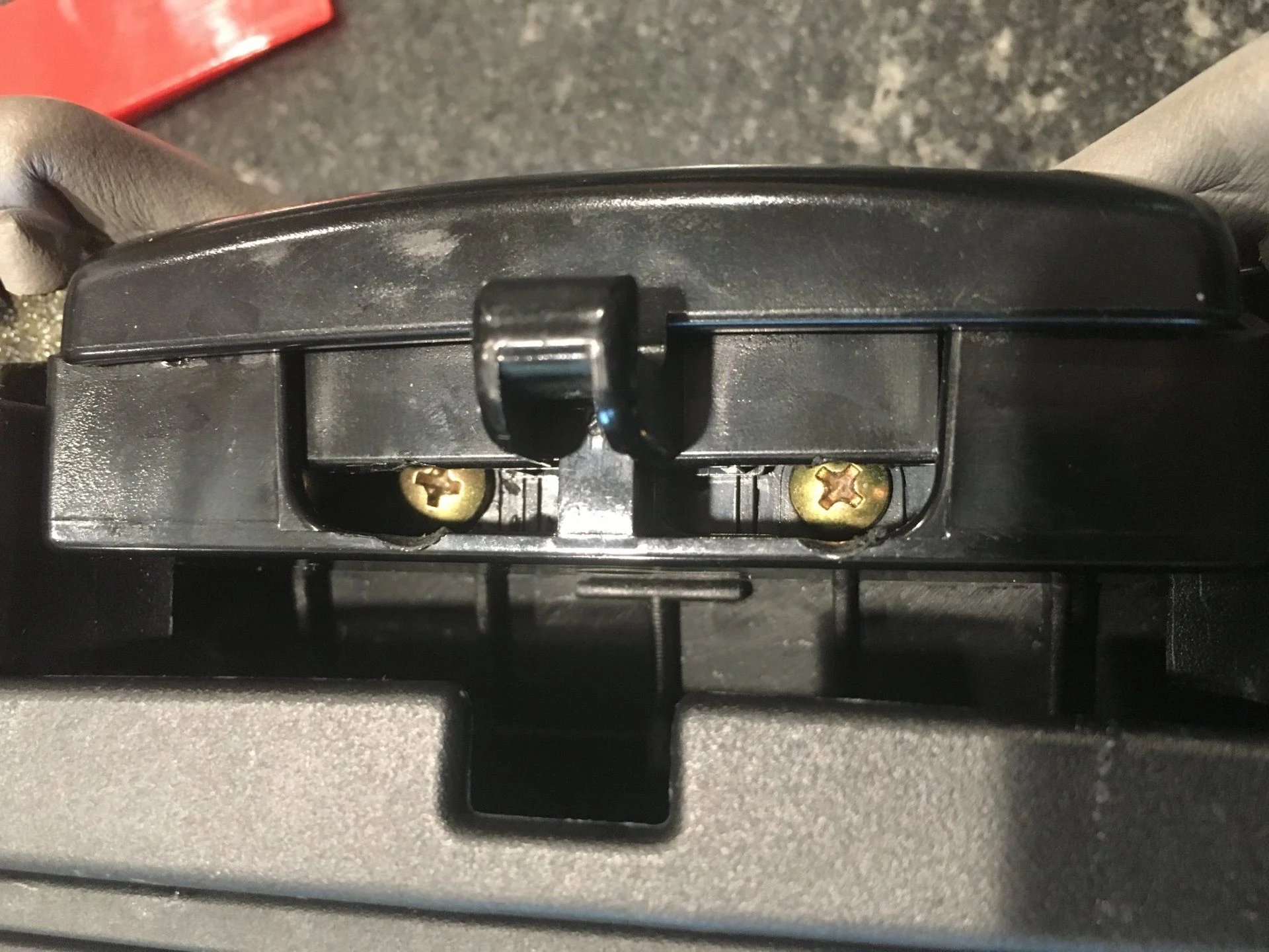

4. Remove the two screws holding the old latch and install the new latch:

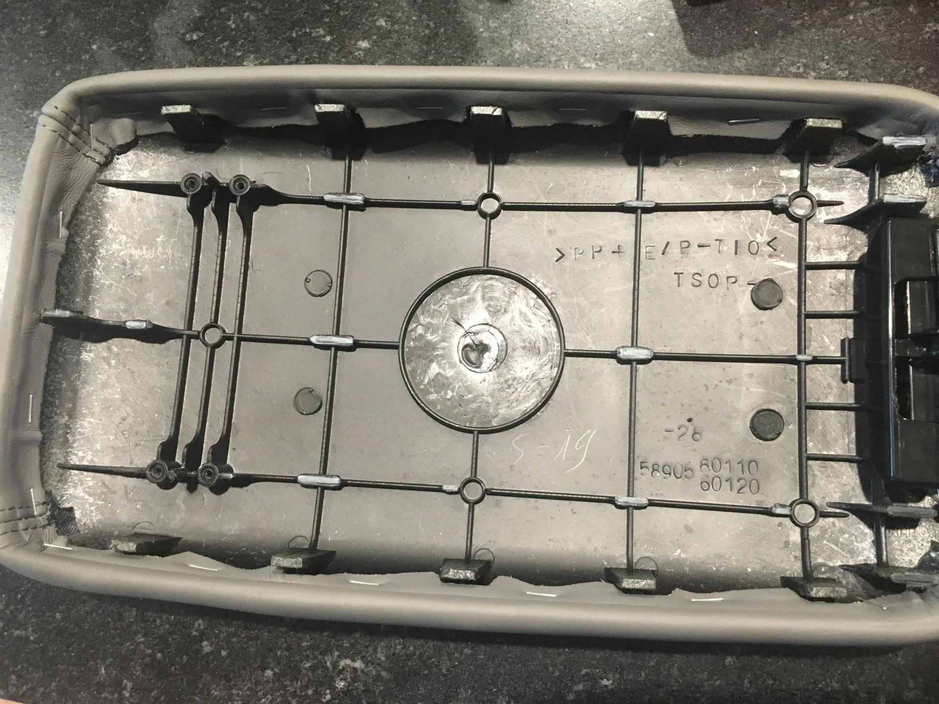

6. Put a small amount of your choice adhesive on all of the little broken joints. I counted about 27 of them. I used the JB Weld I had left over from the lock actuator fix:

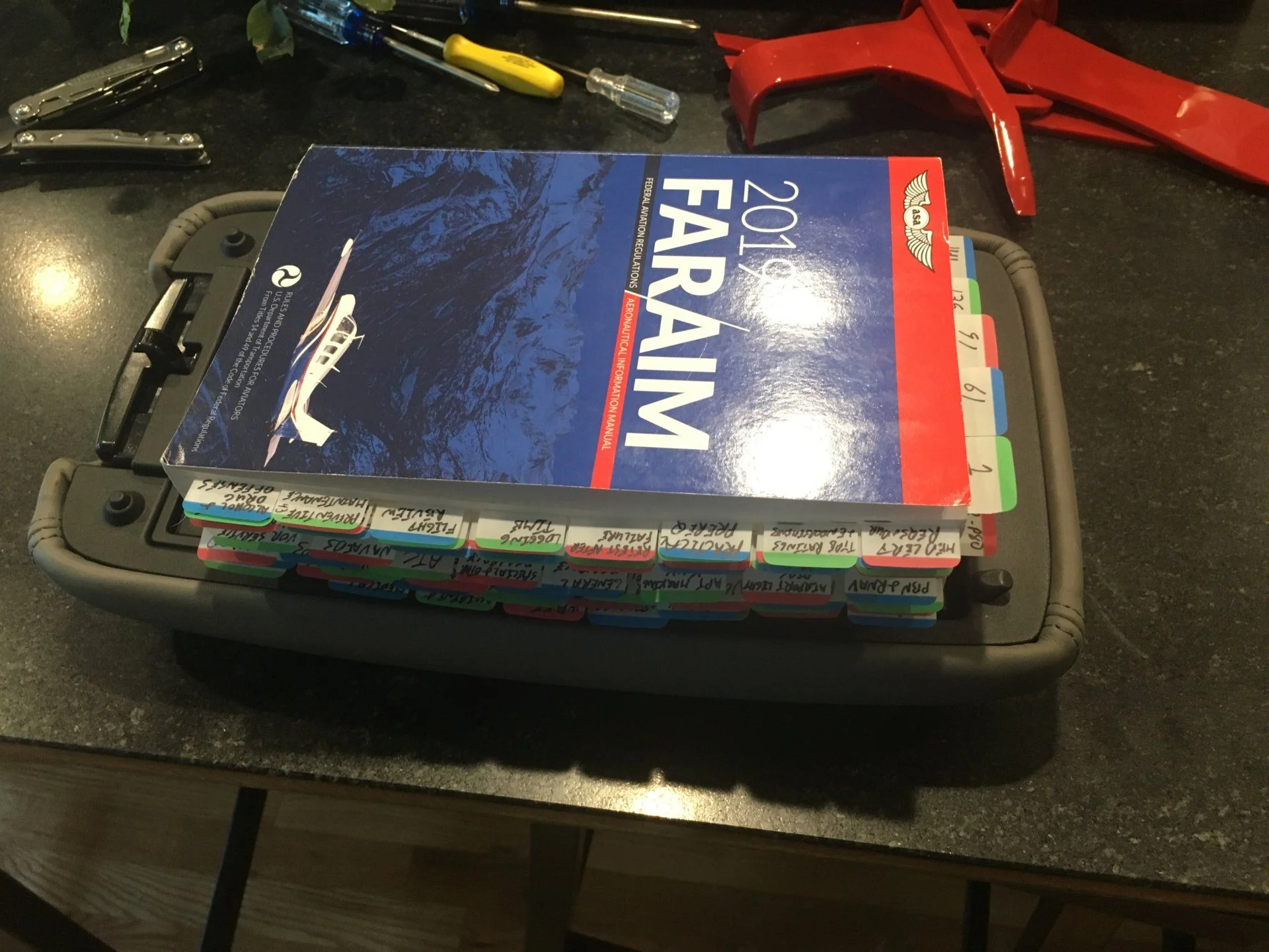

7. Apply a clamp or weight and let the adhesive cure. I used the heaviest book I had handy:

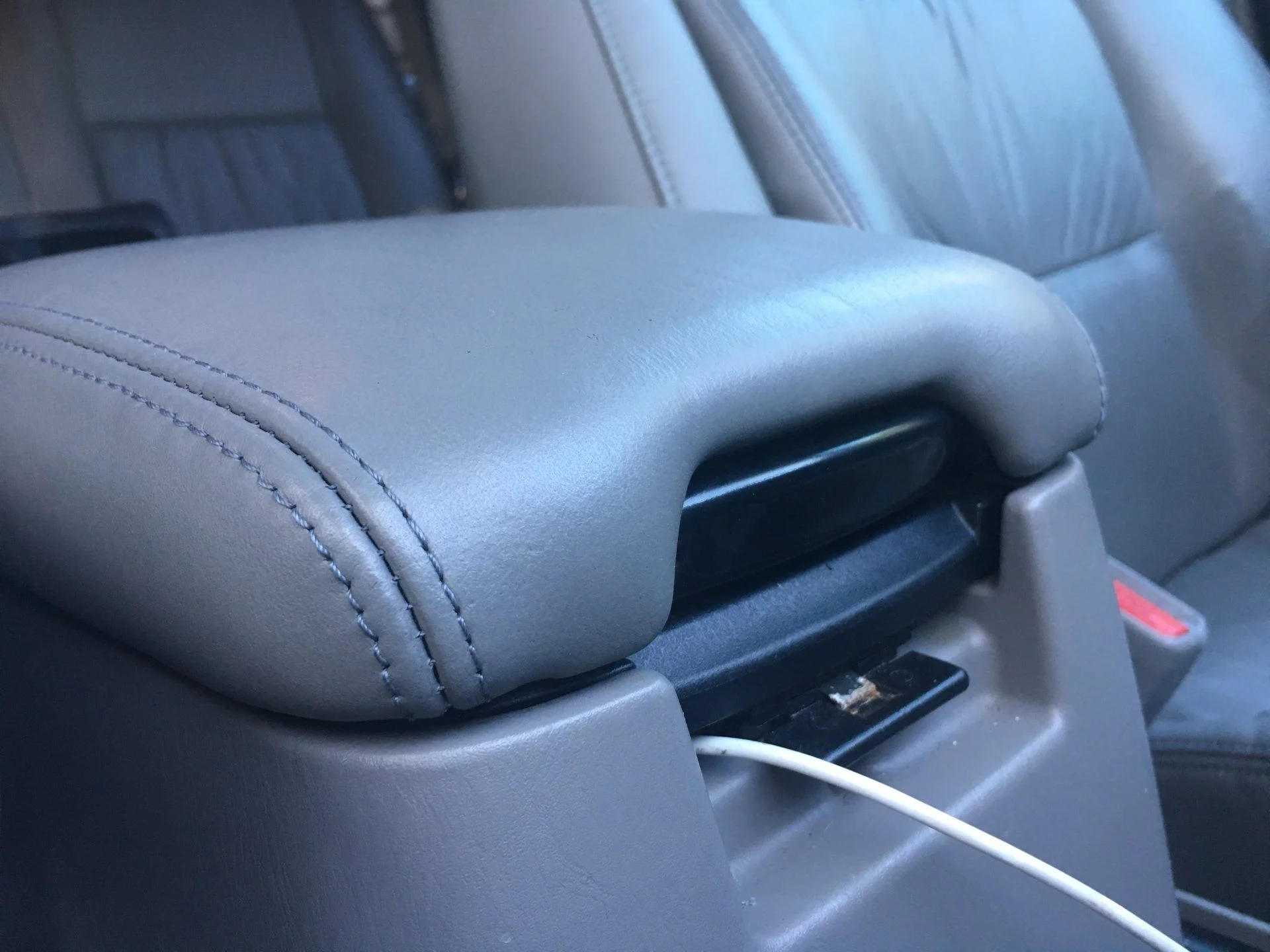

8. Reattach the top lid and enjoy a top lid that will actually stay latched...until it breaks again:

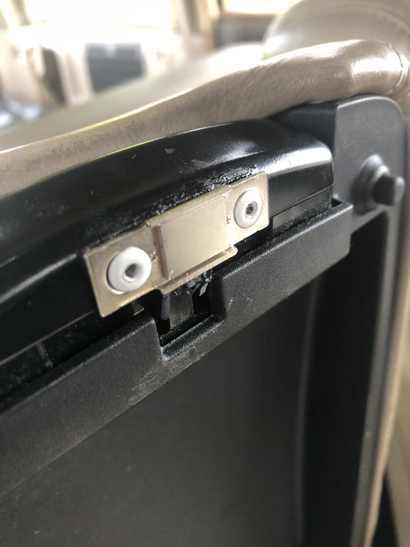

Ever since I bought my LC nearly two years ago the top door/compartment on my center console did not latch. I had a strap holding it to the second door/hatch to keep it closed. I had been looking to buy another upper section and replace, but all options were $$$. So I came up with my own solution that was nearly zero $. I bought a magnet latch off of Amazon and some rivets at the hardware store. View attachment 1719478
And less than 10 minutes later......
Works perfectly. $13 ish for the latch and rivets. Saved myself about $137 compared to my other options.
@04gto How is this fix working for you a few years later? I don’t want to break the top off of my lid to do the “fix” only to have more glued parts leading to a known failure point.
It is still working perfectly. The magnet pieces attached via rivets are as snug and strong as the day I attached them. Has worked so well since day one that I never give it any thought. OEM level solution.
I’ve never worked with rivets before, but I understand the concept. Did they work as straight forward in those two locations as they would anywhere else?
