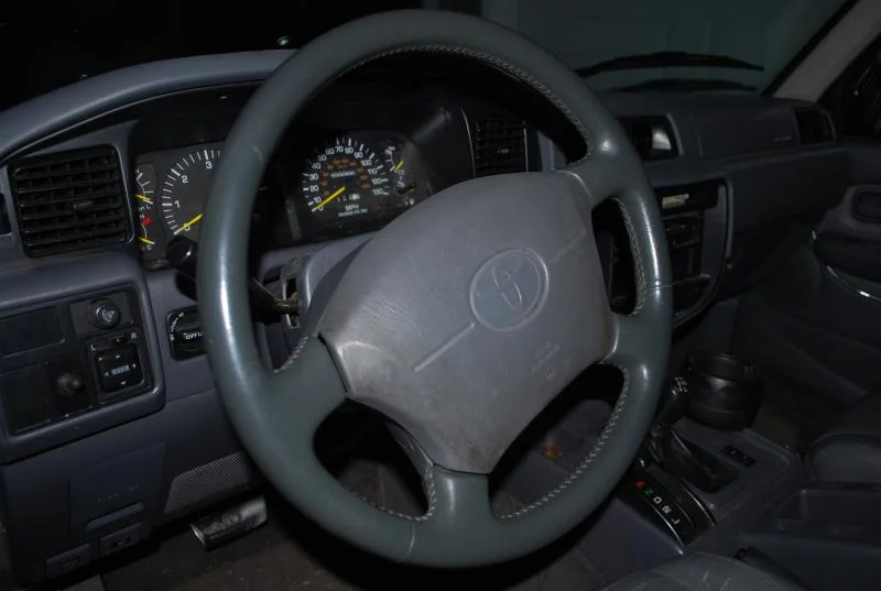

So after searching the forum fairly thoroughly I have found that several other Toyota Steering Wheels will retrofit to the Landcruiser 80 Series.
I have a 92/93 JDM HDJ81 and the leather on the steering wheel has finally started to fail.
I have seen pictures of a Toyota Camry wheel fitted to the 80 Series here on IH8UD but no one has ever given the year range for the donor vehicle.
Luckily for me I do not have to play the airbag game.
Al I want is a nice leather wrapped steering wheel preferably with a Toyota Logo in the center.
I have attached a picture of a Camry wheel installed in an 80 series that was posted in another thread in the hope that someone can provide a bit more information.
Thanks

Finally found a replacement for my ripped and tattered wheel. Once I realized the LS400 wheels fit (thanks MUD) I found one on car-parts (dot) com in my backyard and for $50. It's wonderful. I settled on a non matching color, hands beat out the eyes on this one. This wheel was from a '96 ls400, I swapped out the horn brackets as well as the airbag from my old wheel. I think the new wheel was in an airbag deployment in it's past life slightly bending a horn bracket causing fulltime engagement of the horn. Works sweet now.
I installed a steering wheel from a '96 Lexus car into my '96 LX450 a few months ago.
Fits perfect and is the same color, but you must swap over the entire assembly including the air bag and the horn brackets.
It's about 1" smaller in diameter, but looks 100% stock and complete. My air bag light has been on ever since the swap even after disconnecting the batter for a long time. I think there is a procedure to reset the air bag, but I haven't got around to it.
