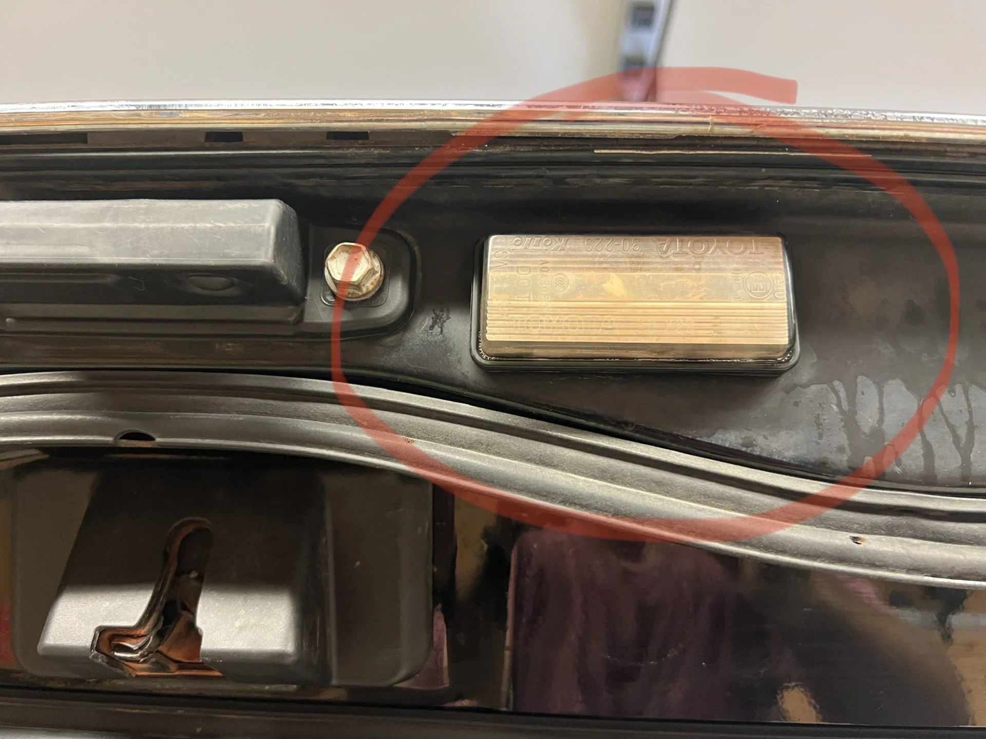

Any idea how to remove these lights? I can’t figure it out!
Thanks!
Push it toward the driver's side against a sort of springy feeling, then pull down on the passenger side. It'll clear a tab and the whole thing will drop out.
