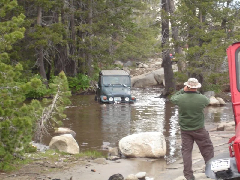

It happens from time to time.
From last years trip;
