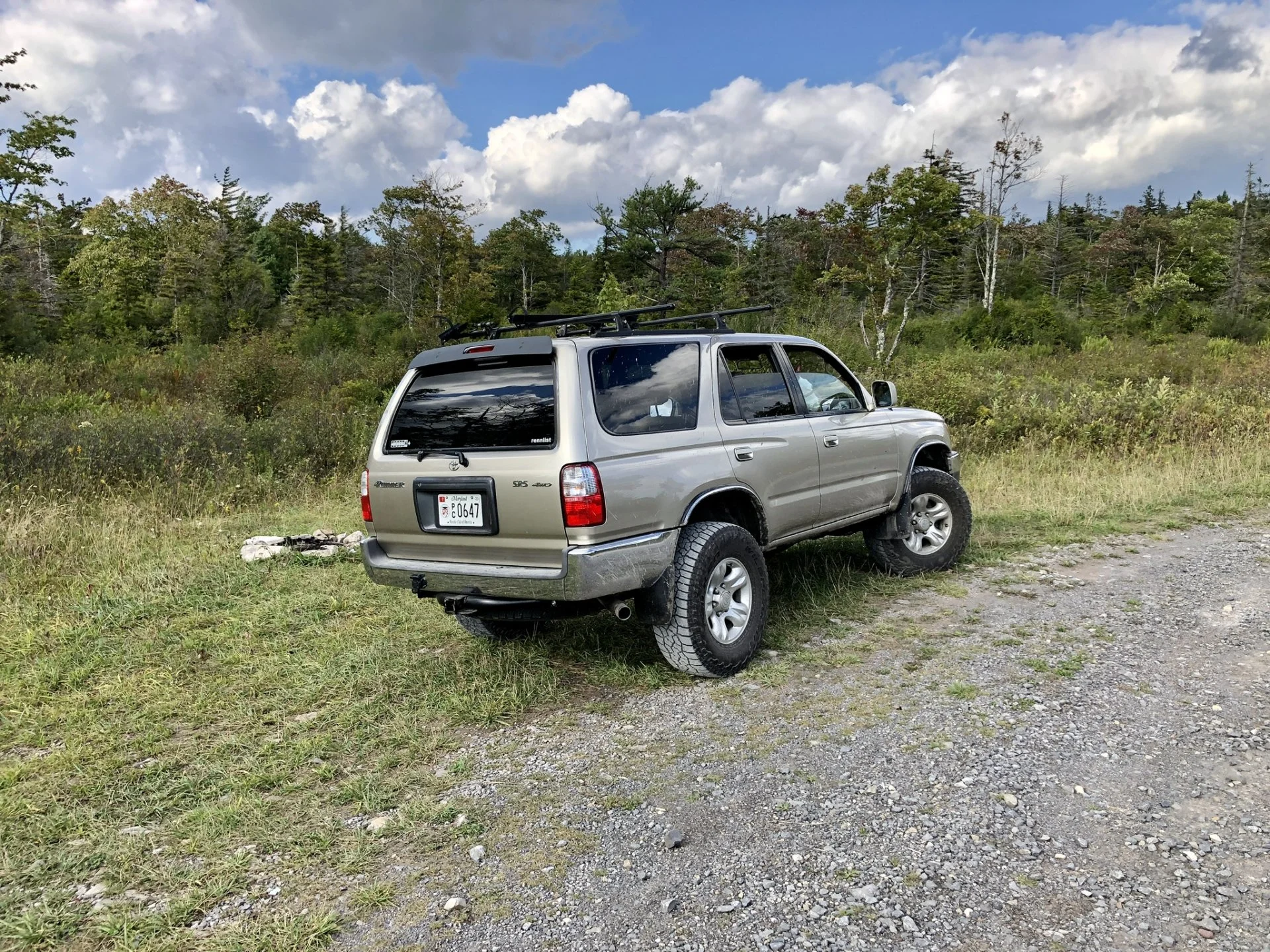

Have owned my '01 since new and now have 490,000 miles on the clock. I've done all of my own maintenance over these years and even had Zuk rebuild my third member three years ago.
Why re-gear now? I've run 265/75/16s for at least 18 years but would really like to make a change to 285/75/16s.
The fresh '99 coils & 1" rear spacers I installed 17 years ago are really showing their age, so I'm considering new coils/shocks/mounts. I drove around with a set of 33s for one month and loved the feel/look, but the stock 4.10 gearing was obviously a bit lacking on long grades.
With the stock 4-speed auto, and 285/75/16s, is 4.88 the preferred choice? The re-gear route is an expensive decision, so I'd like to get it right the first time. :)
