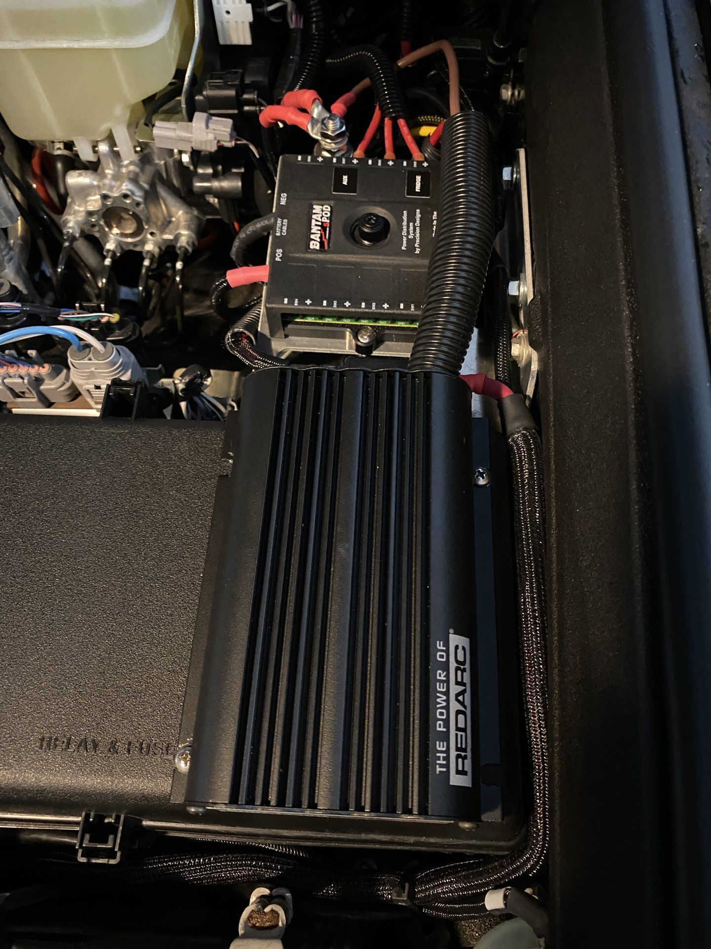

I don’t know if you’ve decided on a mounting location, but I put mine on top of the engine bay fuse box. I was initially concerned about heat, but so far, max temp has been 120 (my sPod Bantam is mounted just aft and it provide a temperature readout).

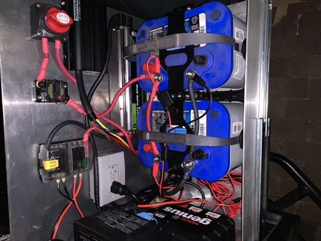

I actually use mine to charge the batts in my BRX Teardrop. Want it closest to the battery being charged so I mounted it in the trailer.
Anybody on this thread have any issues with the Redarc BCDC mounted in the engine bay? Redarc says it can be, but I'm curious. Does heat cause any de-rating of the equipment?
