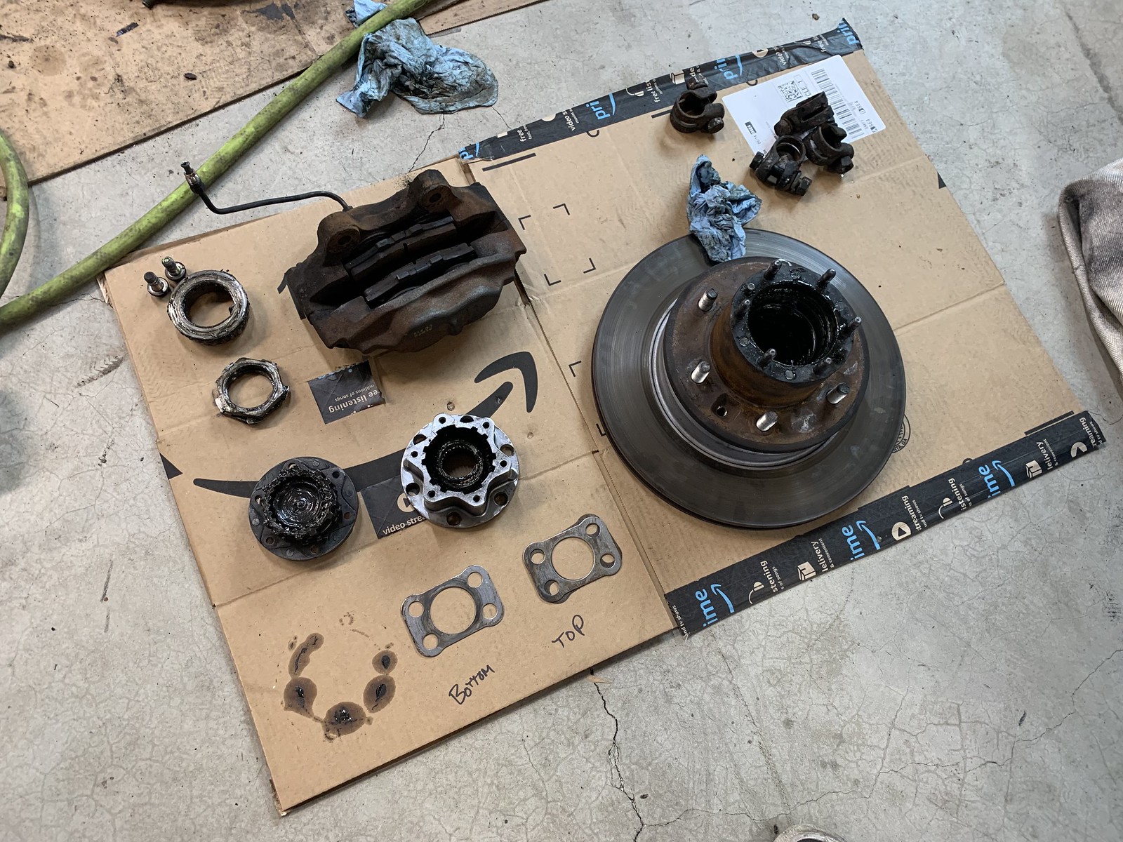

Knuckle rebuild and steering update started this weekend. Nothing spectacular to report. Things are slow. I just keep pressing along. Popped all the steering arms off and got the ends all off. Pressure washed the arms and will prepare them for a fresh coat of paint. Similarly, I tore down the passenger knuckle and started cleaning all the parts for a fresh coat. I also put on my Indiana Jones Fedora and started unearthing the axle. I felt like I was at an archaeological dig uncovering a T-Rex bone from the Jurassic period. Trying to devise a way to pressure wash it in my garage without making a mess. I have a fairly slopped driveway so I can't really push it out into the street as I wouldn't be able to get it in. Not a big deal though. Here's a few pictures, as is my status quo.

I think I got the dirty part of this job done. Both sides of the front axle are apart. All of the parts are clean and are ready for paint. It was raining all weekend so hopefully I'll get to hang all the parts today and spray them with a POR-15 Chassis Top Coat. Going to give the axle housing a quick scrub as well and put new sway bar hardware on, probably time for extend links and new bushings.

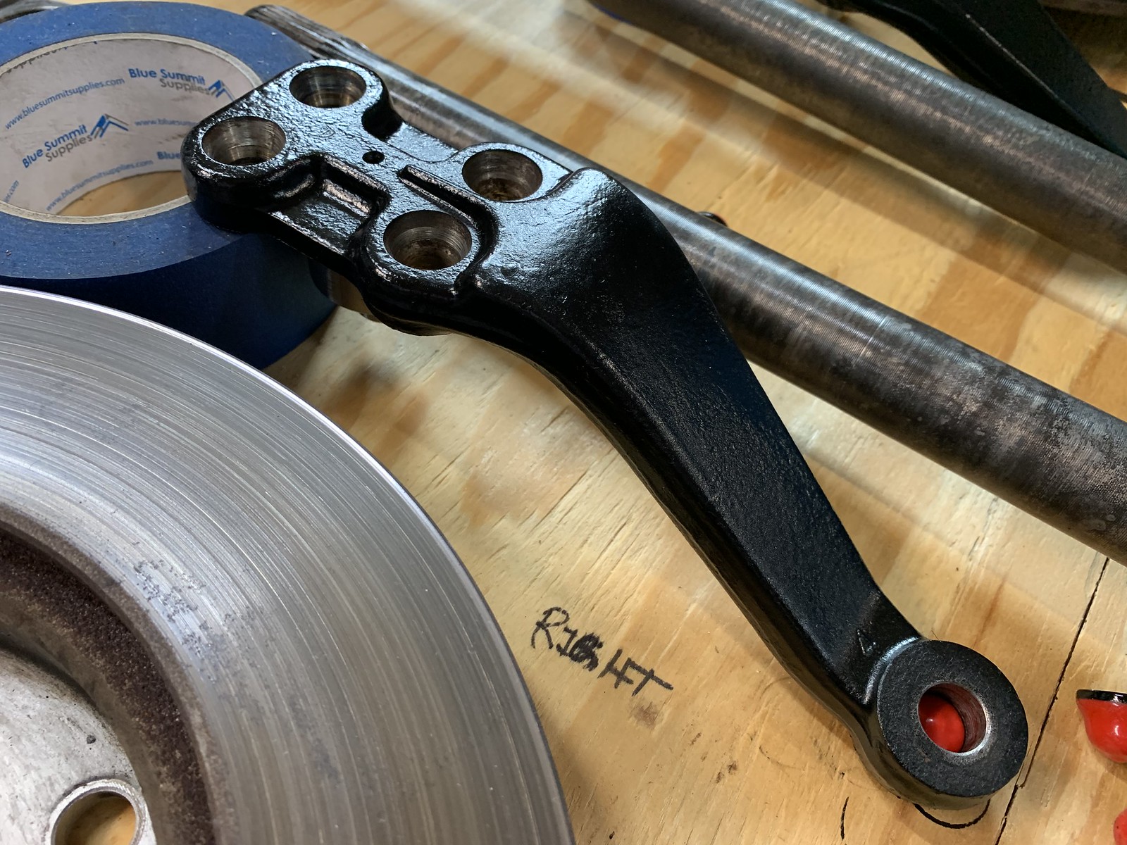

I know how exciting painting suspension parts is for you guys :rolleyes: So here is the finished product. I'm pretty happy with the POR 15 Chassis Black Top Coat. It covers pretty well and seemed pretty forgiving enough even though I tried to do as much prep as I could. It's not the cheapest stuff on the planet, but the finish is good. We'll have to see how durable it is. I will be using this same stuff on the frame and engine mounts when it is all welded together.
And now the pretty parts that will never see the light of day:

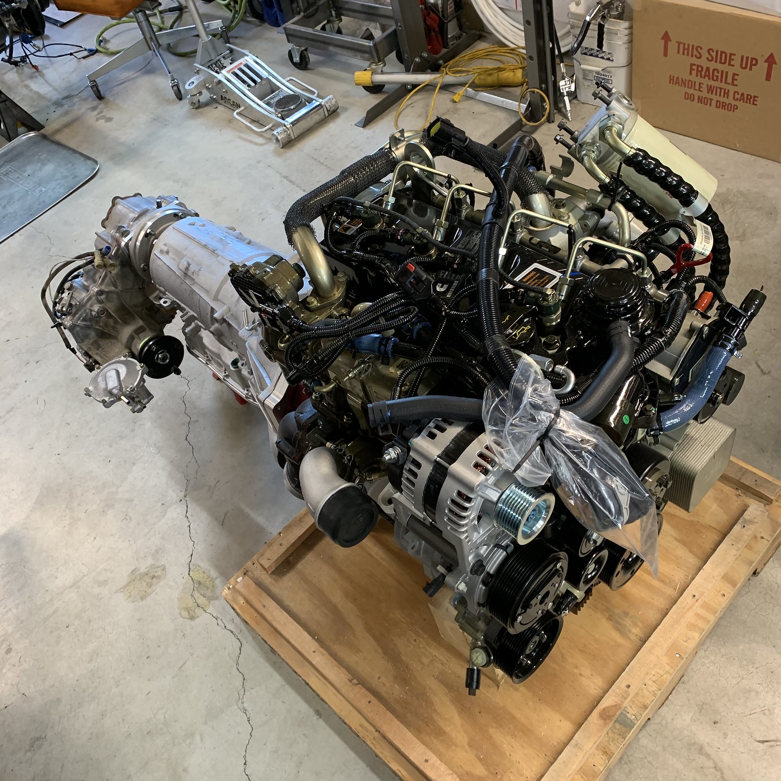

I got my work bench back this weekend. Got the rest of the Axis Industries kit installed and bolted up which means the engine and transmission are mated and sitting in the garage. Kevin is a solid business owner by the way. I reached out on instagram, and he was very helpful about some of the R2.8 questions I had. He really designs some amazing stuff. I'm sure you can see the quality in the machined parts, but wanted to point it out.

Then like SpaceX docking with ISS, I slipped the two chunks of money together. I put a quart in the torque converter and attached the converter to the flexplate.
Slipped a jackstand under the transmission and took a few pictures:

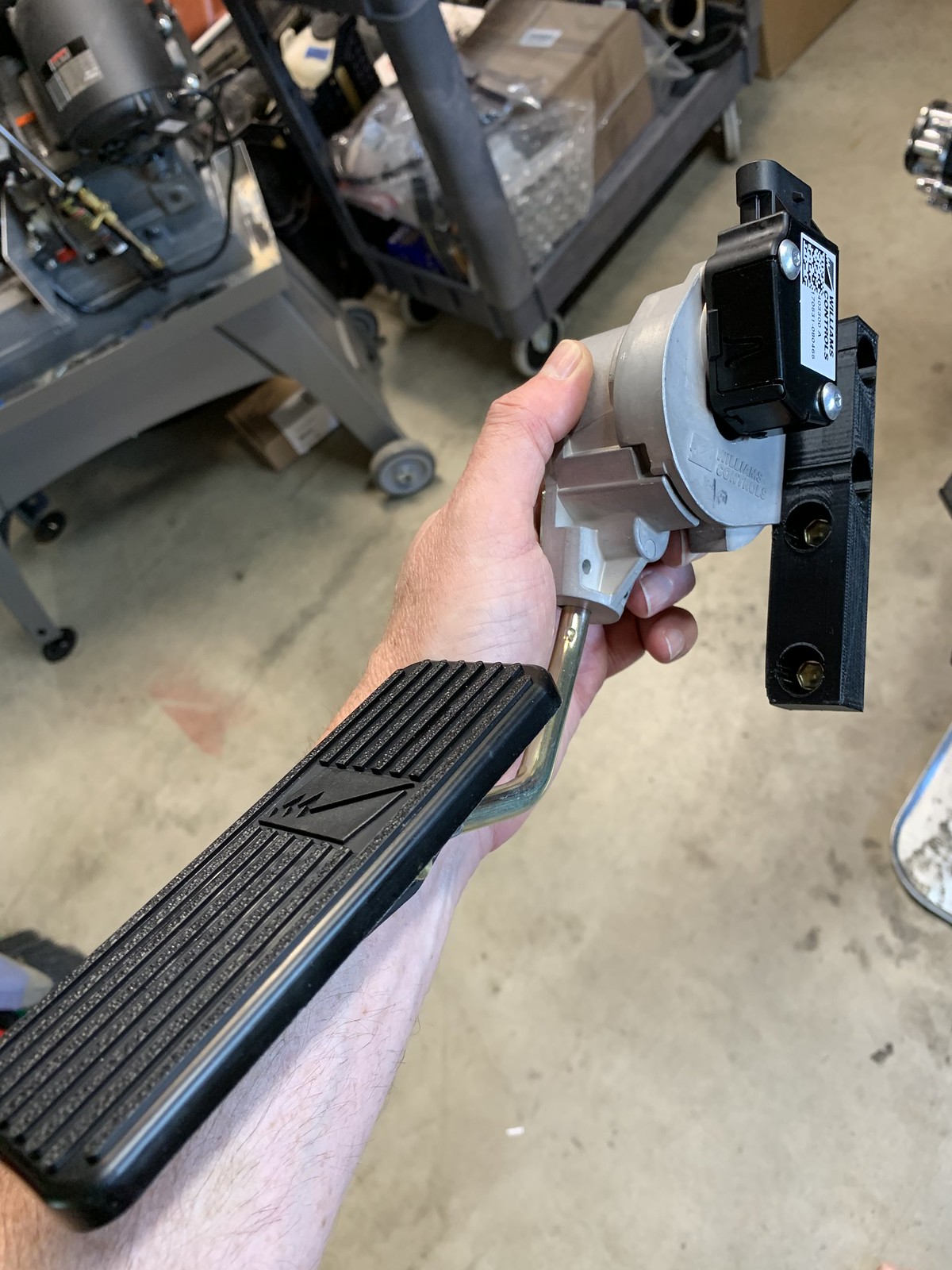

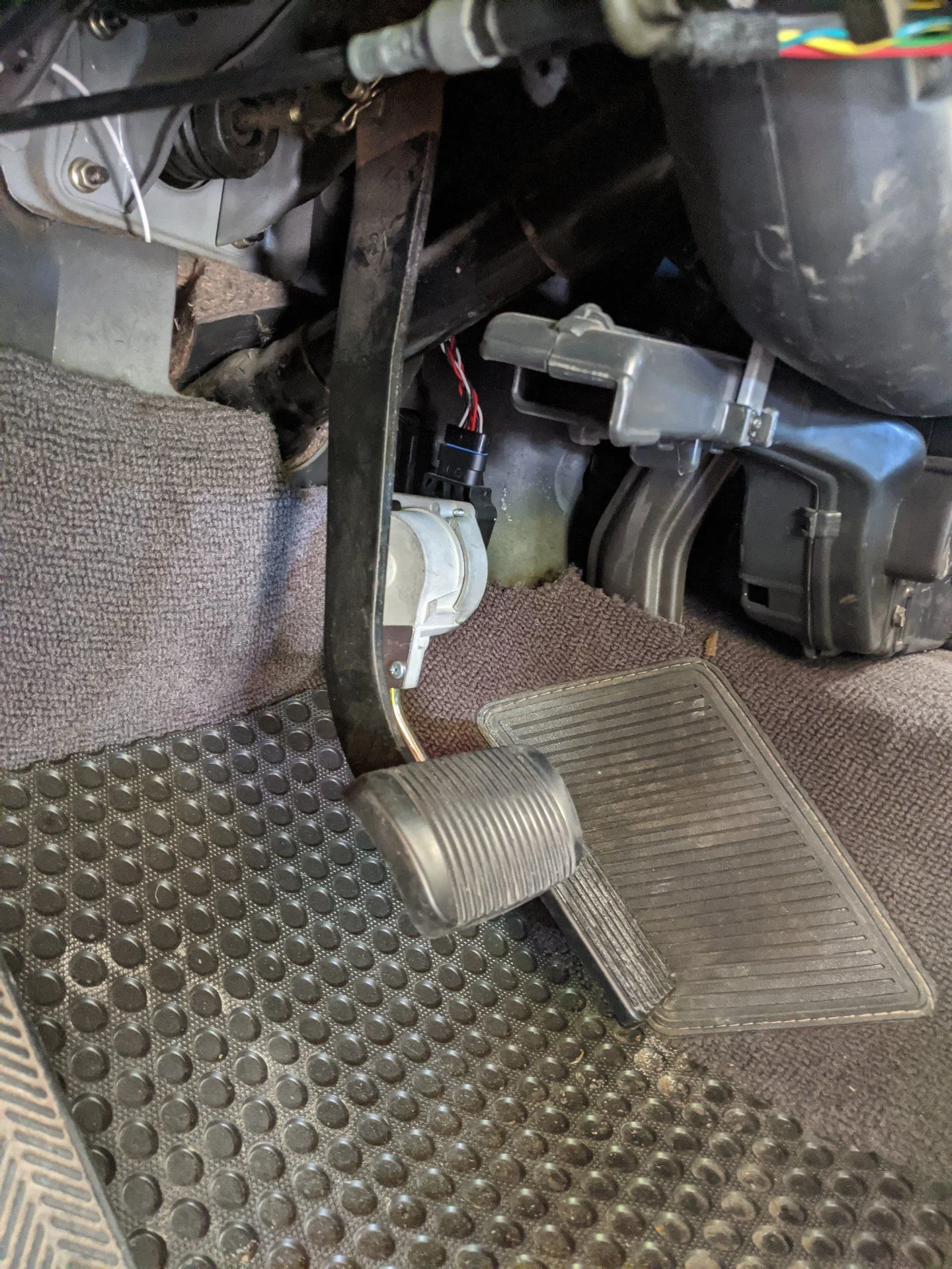

I hate to dissapoint, but the engine and transmission are still on the garage floor. I kept going on some of the firewall things, and well, got side tracked. I spent most of Saturday and Sunday working on the new pedal location which isn't a waste of time as you'll see. The R2.8 comes with a fly-by-wire gas pedal. It seems like a decent unit, but the bracket it comes with made the pedal location fairly proud, not to mention the amount of fabrication necessary to attach it to the firewall. The feeling of going from brake to gas would require you to move your foot in, then over and then start pressing on the gas. Not that typical recessed gas pedal feel (which is actually a safety thing as well).
Stock Bracket:
I started to model the old pedal and new pedal in CAD. The new pedal is shown below highlighted in blue. I could move and rotate the pedal assembly until it lined up with the old pedal face. It's not an exact science because I'm using calipers and photos as reference to model, but it gets me in the ball park and helps me formulate a solution.

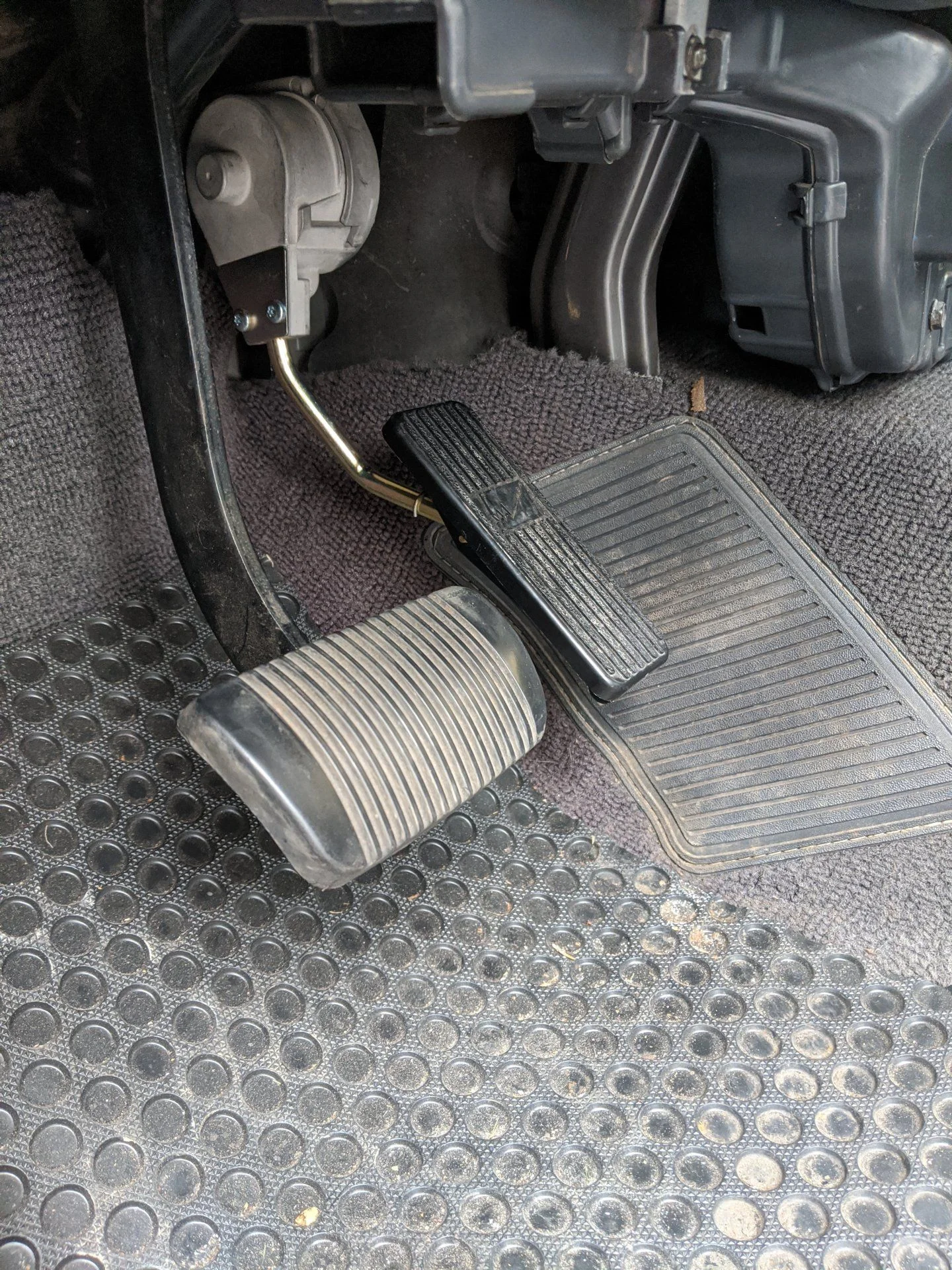

Once the new pedal is positioned, I just made a quick adapter to allow me to use the stock pedal mounting point with the new fly-by-wire pedal. The geometry worked out really well. I was happy with how close I could get to the original pedal location while keeping the adapter fairly simple.
I printed up one and did a test fit.
For a first draft I'm very happy with it.
I could sit in the truck and try out the ergonomics. The wife could give me an approval as well. We both thought it could come closer to the driver a hair, which is easy to modify and try again. The finished part won't be printed. I don't trust the material for my old 3D printer that much. I'll probably print a jig and then bend a small bracket. Pretty happy with how it all turned out.
Added bonus is that the stock pedal stop is right below the new pedal. I should be able to thread a longer bolt in there and make it usable for this new pedal as well. The new pedal doesn't have as much travel as the old.

FYI, this is what I came up with for a pedal stop. I used the jam nut (12mm) from the factory stop bolt on the backside of the widget and tightened it down. Seems to be the perfect length Screwed all the way down. Need to see if I can get a throttle position sensor reading off the OBD port and Torque app just to make sure that I'm getting full throttle but I think it's just right.
