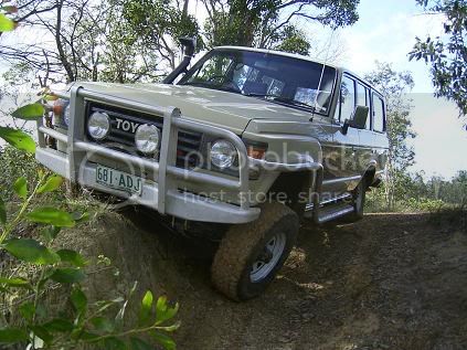

Bring it to Amarillo; to Texas Spring on Fillmore. He can do it in a day. He is an old blacksmith; has been working on ONLY leaf springs for like 35 years. He disassembles the packs, makes a custom LONG second leaf, heats up all the leaves, re arches them one at a time with a 5 lb hammer, cools them down, then heats them again to "temper" them. Charges about 375 per end; expensive I know but mine has been re arched for a year and has not settled. At the same time, I used 1 inch longer in front and 2 inch longer in rear shackles and new poly bushings. Used cheap Heckethorn shocks. Very happy with the results. Here's me flexin my totally bad ass 32s. I run 32 X 11.50 with NO rubbing at full flex; 33X12.5 rub even with a OME kit I've heard.
