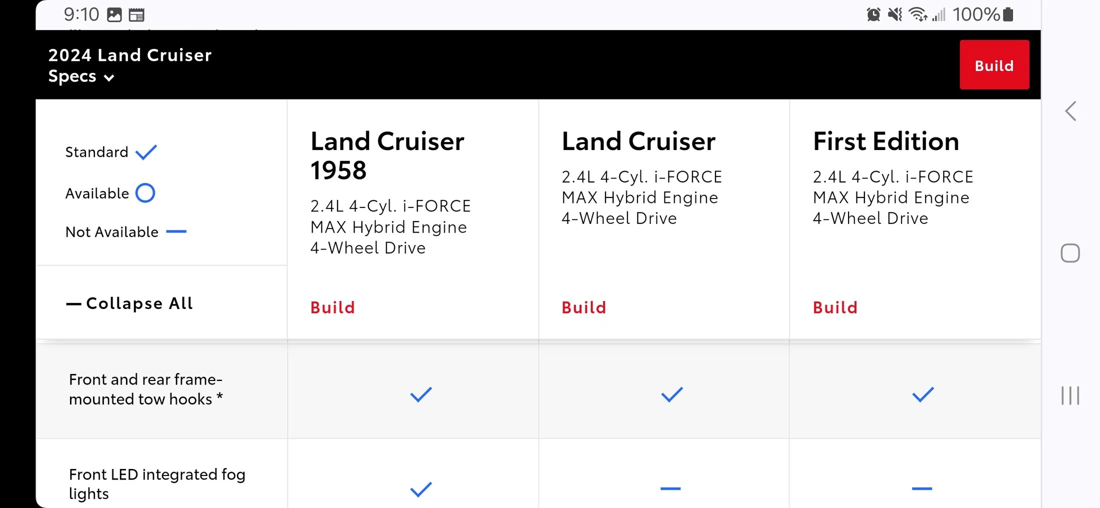

Can someone tell me if there are factory installed recovery points on the 24 Land Cruiser or are they just tie down points. Two on the front and one on the passenger rear.
Yes, they have factory recovery points. 2 on the front, one on the rear.
I saw that. It calls them tow hooks. Just want to make sure that a toe hook is the same as a recovery point. As you know snatching or recovering can be a little more forceful than just towing. Thanks
