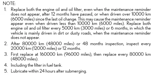

@arekieh does it have a transmission cooler? If not that would be high on my priority list. Not sure if the Middle East market comes with them from the factory or not, that is something I have been wondering about.
The Middle East market is different than North America. In NA the maintenance intervals are much longer for marketing reasons. The ME market is more where it should be IMO so one of the first things I did was download the owners manuals from Dubai. Looks like the GX manual is no longer available from the dealer there if you don't have the original hard copy then message me and I can try to attach it back or send it to you in an email. It is rather large and for a 2023 but the scheduled maintenance in it would still apply. And what I would use in your case. Or even mine, like Acrad said fluids are cheap and repairs are not.
There are a lot of special operating conditions listed in it with shorter intervals that are not in the NA manual as well. Such as - Operating on dusty roads. (Roads in areas where their pavement rate is low, or a cloud of dust often arises and the air is dry.) I spent 118 days in the Gulf of Oman back in 79-80 and pretty sure you fit in that group of cloud dust and the air is dry.
Not even special operating conditions but normal maintenance schedule from a few in the Dubai manual. There are a lot more plus inspection items
Spark Plugs replace every 60K
Air Cleaner replace 24K
Brake Fluid replace 24K or 24 months
F&R Diff Fluid replace 24K or 24 months
Oil change interval is also different from NA
Fuel filter replacement is 96 months note 4 says also replace fuel filter in the tank.

Lubricate after submerging. Now, that's a maintenance statement. I can't imagine that showing up in the Lexus brochure.

Thanks for that I have wondered as have a few others if it is just the NA version that doesn't get the external tranny cooler. Had a feeling it was eliminated as a cost cutting measure here. Lot of North America owners wish they had the factory install a cooler as they wait for a reman transmission, especially in warmer climates in the States.
After baselining it with new fluids I would continue forward with the ME maintenance schedule. Mileage or time which ever comes first. I'd use the dusty conditions schedule no matter what, that crap which is silica gets in everywhere. Mix it with oil and it is called lapping compound. Your call but if it were me that is what I do.
The NA schedule is written by marketing to reduce apparent Total Cost of Ownership as well as environmental reasons. Think ATF lifetime fluid for example... The rest of the World maintenance schedule Toyota engineers get to write them as they should be done. Which is what I use and why I downloaded it as soon as I got the GX. I'd stay with the recommended schedule not the NA schedule. Especially if the cost is not that much as Acrad said repairs are expensive compared to maintenance.
As @Cold Iron stated we just have the sock in tank...
from FSM for other markets if we did have one in the engine bay.. super simple swap for those models
