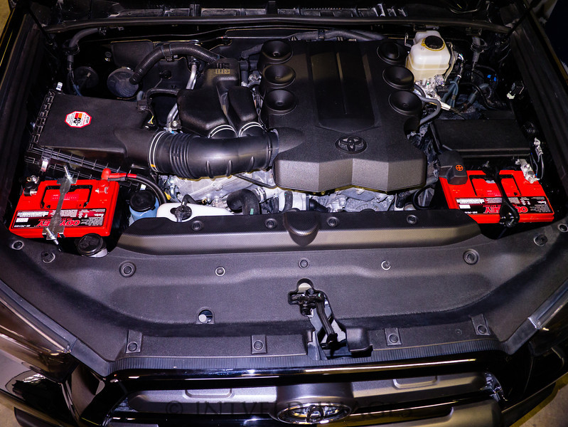

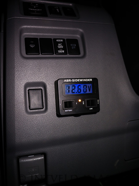

Since I'm using an isolator that allows the starter / glow system to draw from the aux battery (parallel batteries) I opted to stay with a hybrid deep cycle AGM battery. I am, however, upgrading from the Optima to a Sears Diehard Platinum PM-1. I'd wait for the Optima to fail but who knows when that will happen, so I'm upgrading pre-emptively. Not because I'm concerned about reliability but because I want the extra 45AH for a trip.
To keep the batteries charged, I have 100 watts (two panels in parallel) with a 10amp controller permanently mounted on my roof (TBD). This should allow me to run my aux load indefinitely, without starting the engine, provided I get enough sun.

http://www.intveldimages.com/photos/i-kmczsNv/0/L/i-kmczsNv-L.jpg
http://www.intveldimages.com/photos/i-XXgqgkF/0/L/i-XXgqgkF-L.jpg
