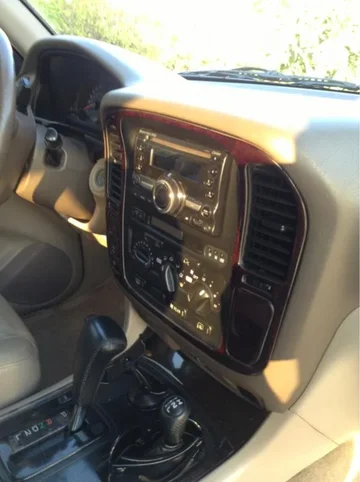

Just installed the Pioneer AVH-X2500BT in my 01 LC and am very very happy. The install is a piece of cake and you use your factory brackets and no face plate is required. Other than the difference in plastic materials from the new HU vs. the old it looks very nice. The back up camera feature is a great addition.

Onpoint01,
Thanks for the post and photos.
I am all about easy installation.
