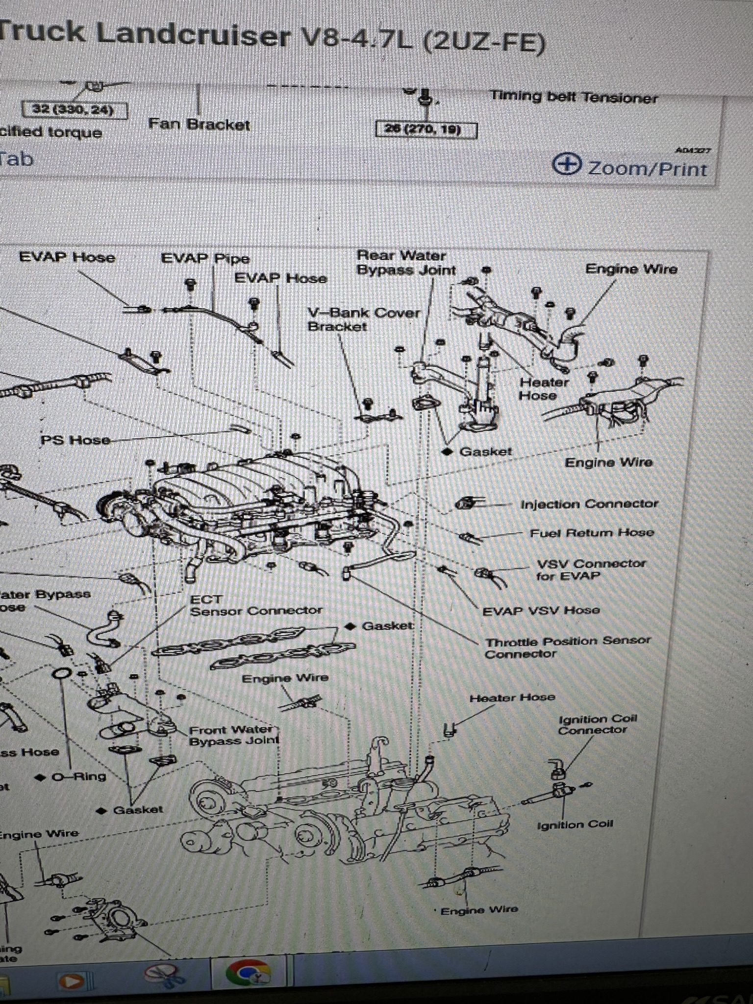

In part of baselining my 2002 LC, I proactively replaced the heater hose T's and connecting hoses from a LC specialist shop in the SF Bay Area. (That was about 18 months ago)
Over the past year I've been having quite a big coolant leak, with my reservoir sometimes being completely empty. There doesn't seem to be a pattern...sometimes I drive for hours and lose no coolant, other times it's empty after short trips around town. I took it to my local independent shop and they replaced the radiator cap. The leak continued and I took it back, this time they pressure tested and found a leak at the rear water bypass pipe. (Where the hand cursor is in the below pic).
Estimate to repair is about $950, for 4 hours of labor, a new OEM rear bypass pipe, and two new gaskets. (Also found it here on CruiserPatch.) I'm taking the hundy on two big summer trips and I want to fix this coolant leak for good before it causes more damage. Some thoughts/questions if anyone has any experience with this:
1. Would this be likely related the heater hose T replacement? Looks like the hoses are connected. The LC speicality shop offers a 24k miles warranty on their work, but it's a PITA for me to get down there and $255 to diagnose the leak. Though if they deem it related to their work, it's covered.
2. I'm leaning towards having my independent shop just repair it for the $950, but also wonder if I'm replacing fine components and maybe it's a simple hose connection. I'm not comfortable getting in there myself to do the work, unfortunately.
3. I can see the pink residue and coolant pooling at the bottom of the Rear Water Bypass Joint, so it's a substantial leak.
4. Anything else I'm missing? I found a thread on mud here with a comment that the bypass joint can leak after heater hose T work, so maybe this is a thing?
Thanks in advance !
When I replaced this part, it was under 100 bucks and not a ton of difficult labor, imo. If it is this part, it’s not related to the heater tees. You can visually inspect the heater tees and they don’t normally trip into the valley. If you peek into the valley of the engine and it is filled with coolant, you just have to see which bypass pipe it’s coming from. The rear is harder because of access, but the front is harder because abuse of the thermostats housing. Somewhere on here I have a thread of what it looks like when I did it… although I did just look for it, and I don’t have pictures of the rear, only the front:/ and it was for a 00 lc
The pipe that goes in to it can easily break near the base, I damaged mine replacing the heater Ts on my last cruiser something like a decade ago. Can't say if the shop that replaced your heater Ts actually caused it though. Wouldn't surprise me if it was already degraded, and any movement/pressure on it from replacing the Ts (even if not an excessive amount) just exacerbated it.
