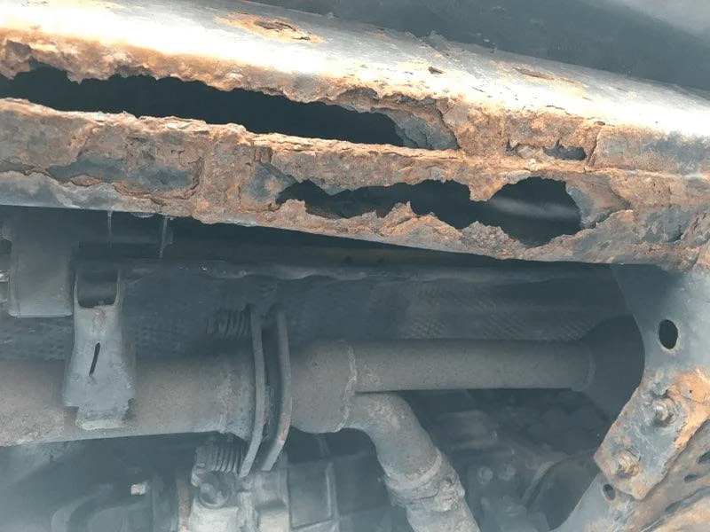

The front and rear cross members are toast...and the passenger side rail is in rough shape, pic below, and I am sure there are more areas of weakness...but I'm trying to get us through the next 12 to 18 months with some assurance of relative safety...as this truck will be used around town and sparingly on the highway. If I can accomplish that then I'm good...and I'll then offer it up to some ambitious soul who wants to get creative with it.
I have new front and rear cross members ordered and on the way ....next week the vehicle will be at the welder for some R&R....new cross members, patched side rail and new rear upper link bracket. afterwards I'll give it a Fluid Film treatment and the cross my fingers.
