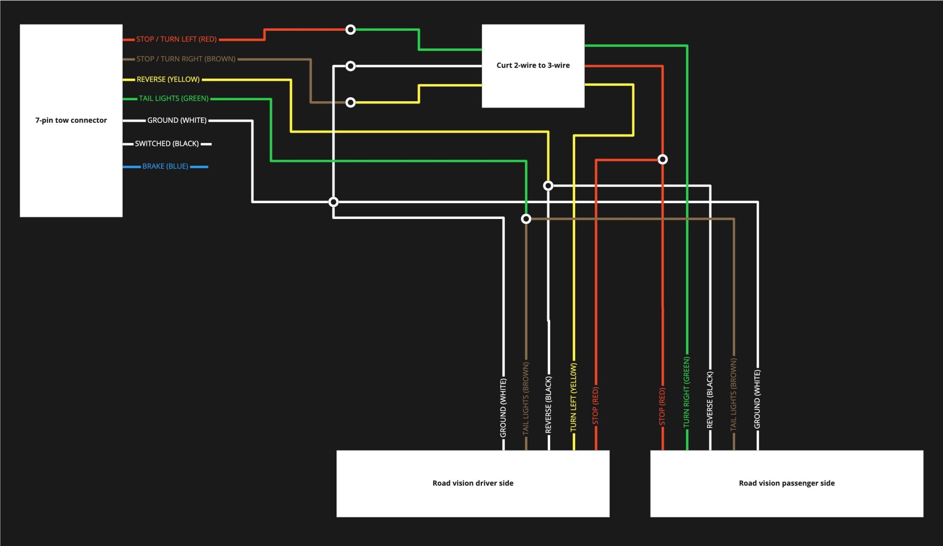

Hey all. Just curious if someone had any idea/existing thread regarding which wires do what in the body mounted portion of the rear tail light? Installing the roadvision br201ar and im having difficulty finding the "tail lamp" or "day eunner" light wire. I've found the ground, turn and brake signal wired. Any help is appreciated.
@tbisaacs that's awesome. Thanks a ton for that. Did you relocate your reverse camera?
Is the camera relocation in your Lx570 build thread? I'm just trying to relocate mine using the existing camera housing.
