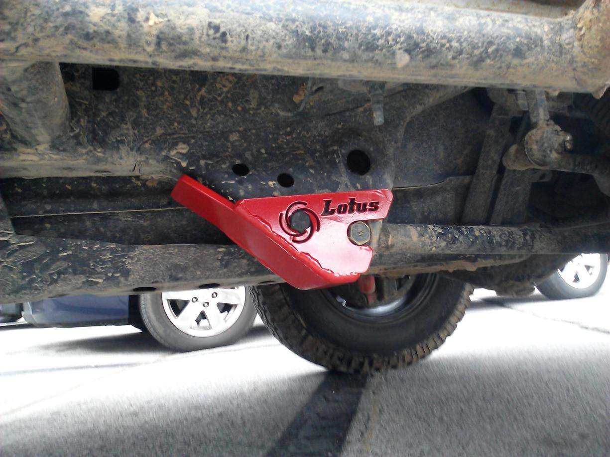

The lotus development guys got back to me. They said if they had a local 100 in Denver to measure they would probably be able to make em up.
Okay everyone,
Got with a vendor and they will make these for all who is interested but I need to get a good number of us to be in the "buy in" to prioritize the fabrication of these.
they will looks be made of 3/16 HSLA steel and will look similar to this:
I will start a new thread. Who all is interested in this thread?

Okay everyone,
Im in for sure. Thats exactly what I want/need. I would rather have the bottom in 1/4" or 5/16 though. Maybe the 3/16 will be enough??
Interested-
Very interested.

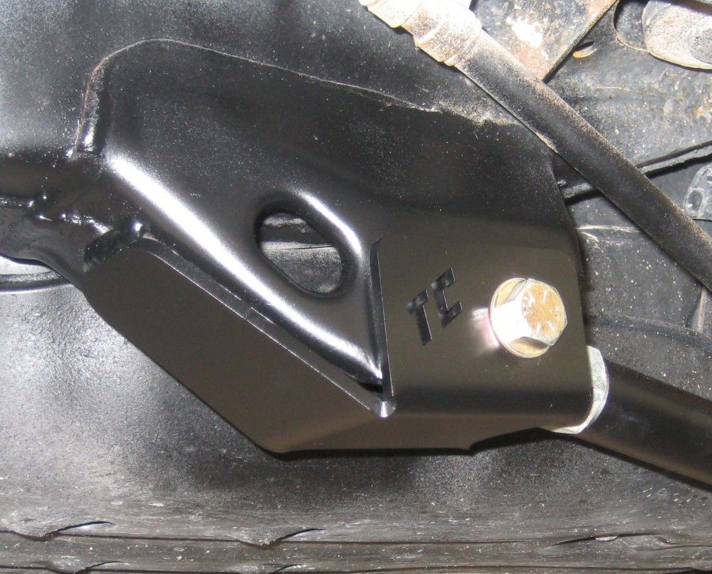

Funny just saw a posting on another thread an look at these brackets:
Are these going to require a weld as pictured above? Also, the first bracket looks like it bolts to the old mount and has an indent for the mounting bolt for the control arm/mount. How will yours mount? I would rather that the bolt pass through both the protection bracket and mount. This, with new and longer mounting hardware would ensure simple installation. A weld would up the complexity on these, but make them that much stronger.
Good question, let me find out.... though it looks like the non-mounting hole is partially blocked by the control arm ring.
