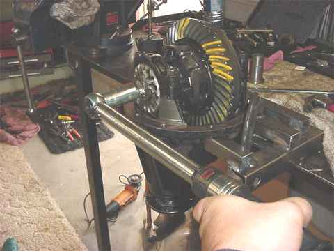

None of the observations in my post above are from Toyota. I have been doing research to regear my 80. Talking to local gear installers, their experience is that tighter carrier bearing preload makes for a stronger setup and it's their observation that some units are coming setup looser than they would like to see for offroad use. Their standard procedure is 100 ft/lb for units that see highway use and up to 200 ft/lb on the adjusters on trailered units.
One was telling me of a customer that broke a ring in a late e-locked Taco, towed to the dealer and replaced the 3rd with an new assembly under warranty. Brought to his shop, dropped the 3rd and it had no preload, he said they turned the adjusters 2 notches before any preload was felt and ended up with about 4 notches on each side. I haven't measured the thread pitch on the adjusters, but that's about a half a turn total, a significant adjustment IMHO.

Zuk's take on carrier preload;
>I set the CBPL extra high for kyle (150 ft/lbs) while maintaining the prescribed 7.5 BL. Although 150 ft/lbs on the spanner rings sounds terribly high, it is not and translates into an actual 15 inch/pounds of CARRIER BEARING pre-load which is a desired spec to shoot for.....even for a daily driver.
