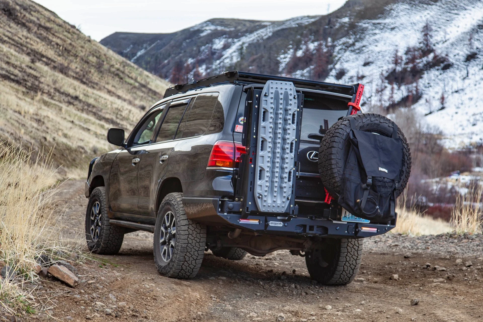

The elusive lightweight rear bumper solution. No real answer atm. Though there are some options that come close like the LC200 Kaymar rear, Slee aluminum replacement bumper, Dissent, Victory. Wish there was a bumper slider type solution.

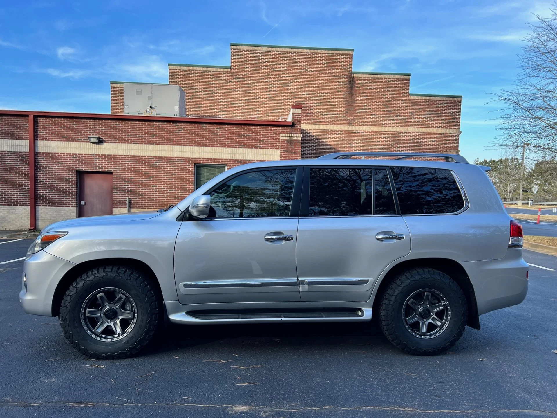

Curious why you're choosing to mount the spare on a Wilco? It's better off in the stock position unless that's taken up by something else? Can still fit pretty dang large tires under up to a 34.3" diameter.
You look like you have some serious meats already. I'd encourage more sensor lift. Between the tall tires and sensor lift that create up to ~5" total lift, there's less concern to dragging the rear end.

You could look a the couple threads where the stock rear is trimmed up about 1", and a tube slide rail installed on the perimeter. Definitely will be the lightest, and done with appropriate reinforcement might meet your needs.
Like this:

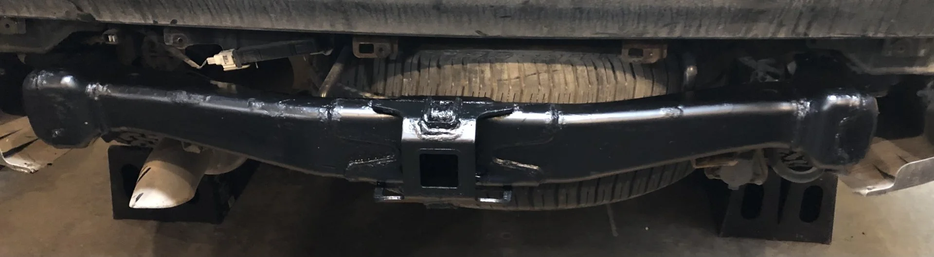

This is what the rear sub frame for the hitch mount looks like. I don't see how from that pdf it would attach to this. Unless there is something that mounts into the 2" hitch receiver and allows the bumper to be bolted to that. Or are you supposed to drill and bolt through that frame around the receiver?

Easier to paint-match after scraping it up than the factory tupperware, I suppose. I can't tell from the limited photos/drawings but I suspect it actually rests on the rear frame cross-member.
