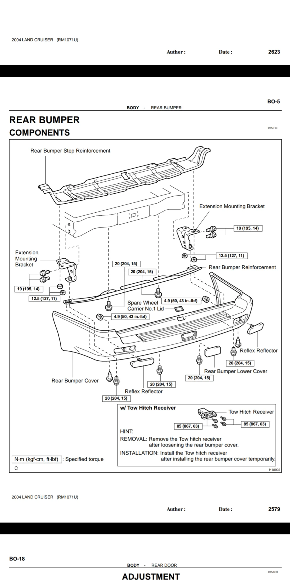

Rear Bumper cover removal
Bear Lake Cruiser
SILVER Star
Dec 30, 2009
64
1,208
Tucson AZ/ Fish Haven, ID
Does anyone have a step by step removal instructions? Or an exploded parts diagram? I can tell I have at least one mounting bolt or fastener loose or broken as the bumper cover moves up and down about a half inch and squeaks. I need to get inside and remedy the issue.
