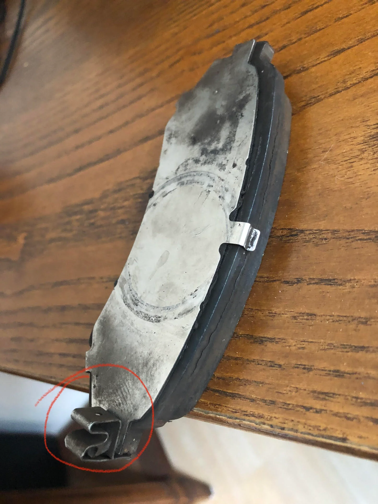

guys, i did not notice the orientation of this notch in red on the rear brake pads.
Can someone tell me what this is. I got two new with the rear OEM pads. Where does it go, on the inner (towards the caliper piston) or outer and whether on the top of bottom.

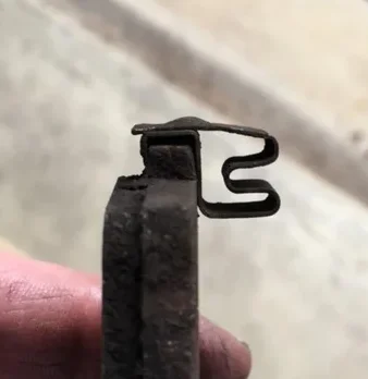

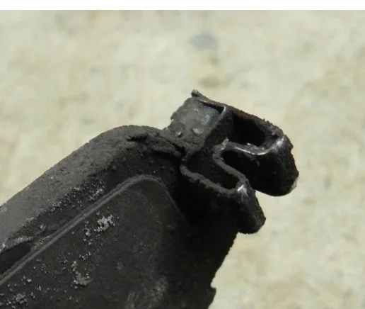

I assume u mean inside towards the piston and on the top. Why is mine pointing upward away from the pad? Isn’t it supposed to be towards the pad if it is a pad wear indicator?
Do u have pic of it installed correctly?
The guy who did the brake job did a terrible job. Broken brake pad retainers, both horse shoe shim installed on the rear driver side and other 2 passenger side!!! Doing it myself this time.
This thread shows the correct tab. I dont think the above wear indicator is for a LC. This thread mentions his for a different purpose. Says it is at the bottom of the outer pad.
