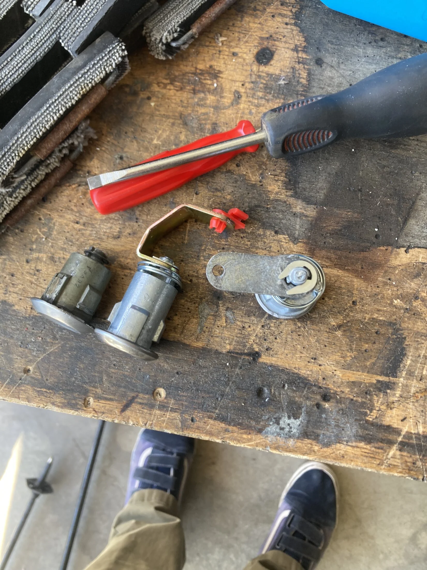

Got these things from the Philippines and they worked great. I can actually lock my car now!
As you can see I just switched to the flat back piece and bend some stuff a bit cause they are a little longer and good to go.

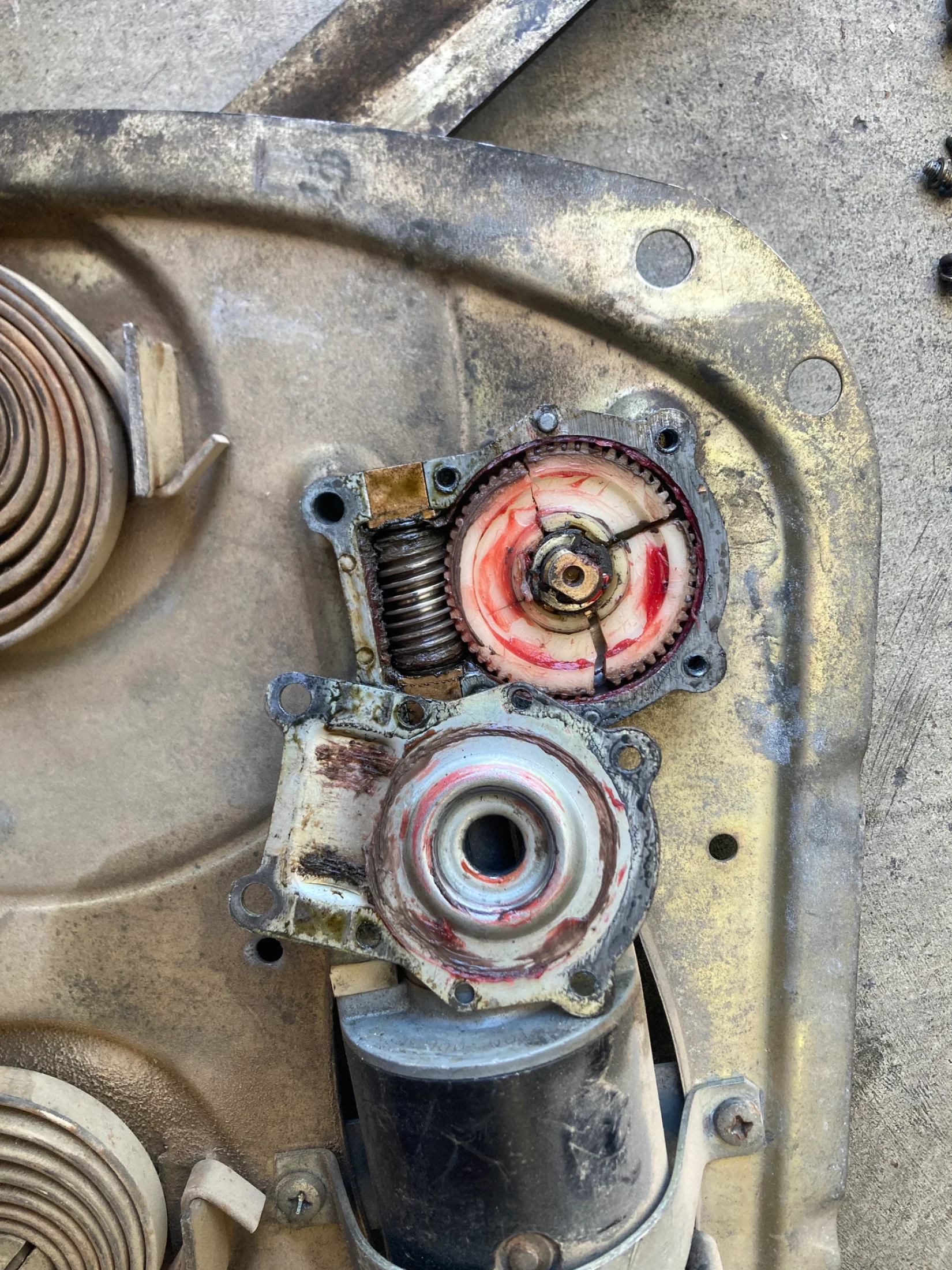

At the hotel the back window would not roll up. Augh! Ended up messing with it and got it up but now it was definitely broken.
Got home and after some taking apart realized that the flat slide pins that hold the window to the little tracks had been put in the wrong way. Each time the window was rolled up the little tabs would hit the inside walls of the tailgate. Stupid!
Now, with parts that I had bought a million years ago, I was able to get this thing together.
It works better than I can remember!!!
