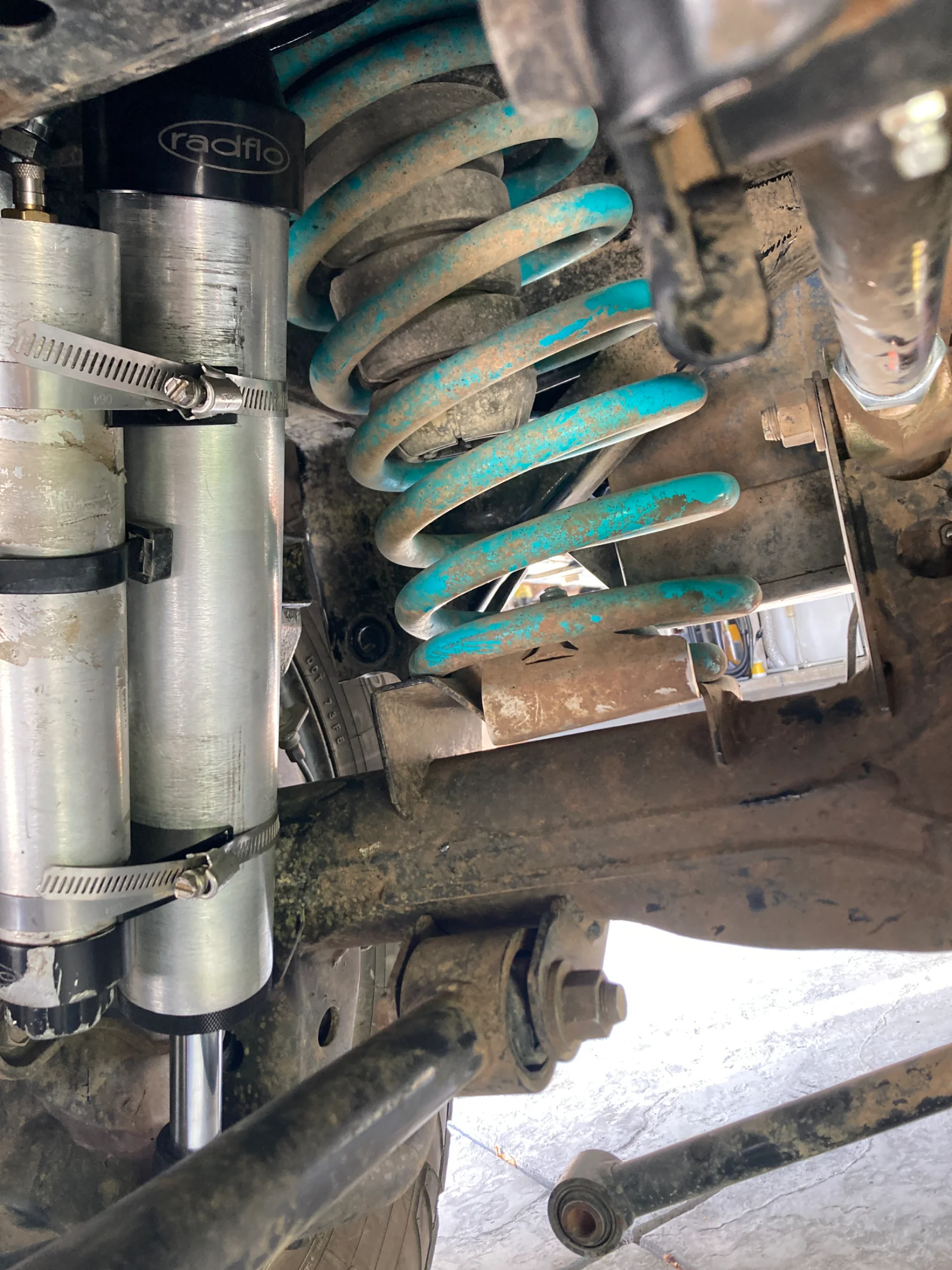

Fixed rear shock

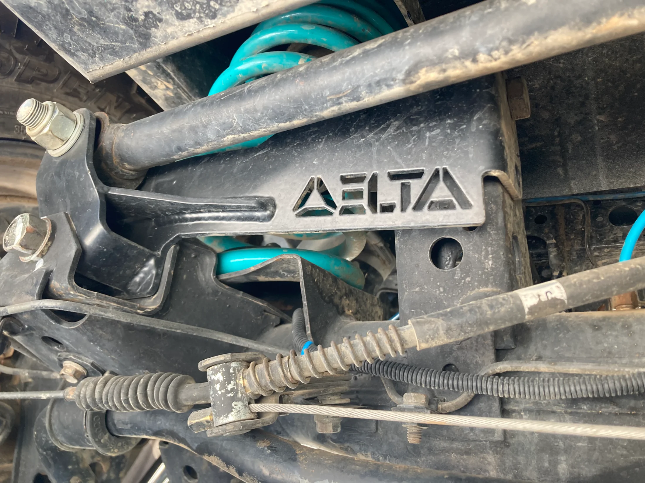

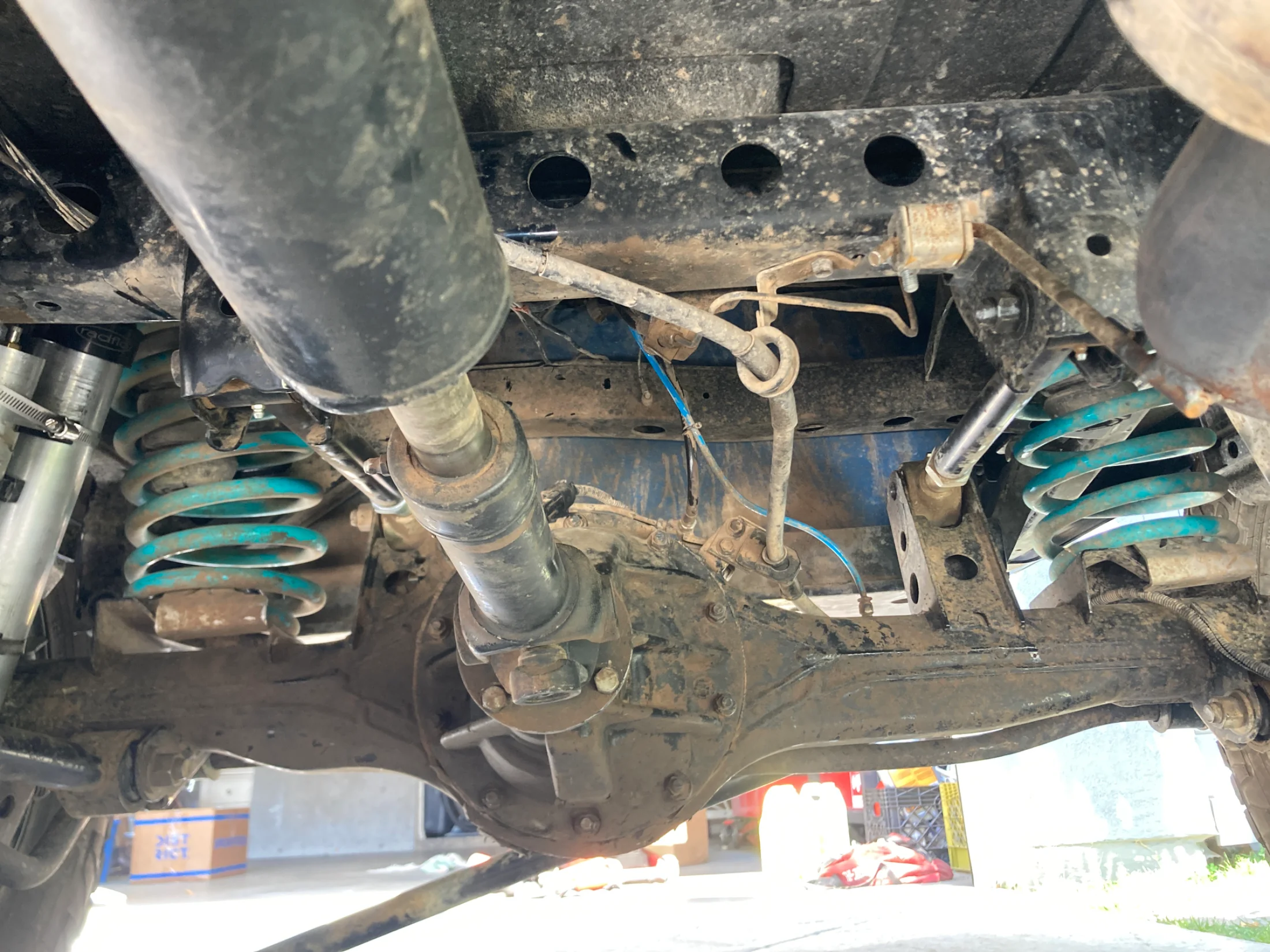

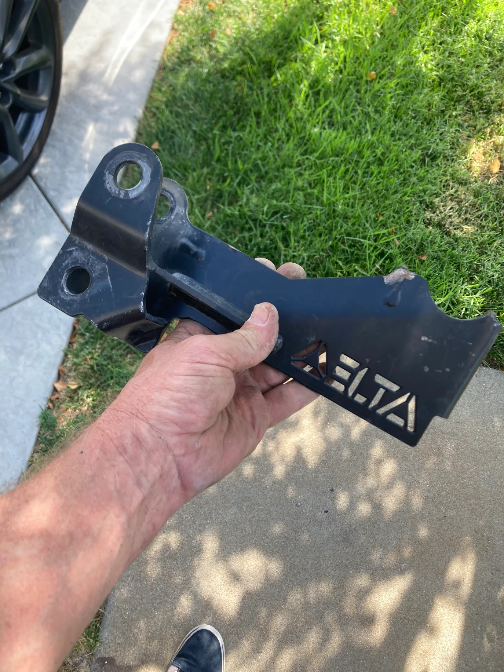

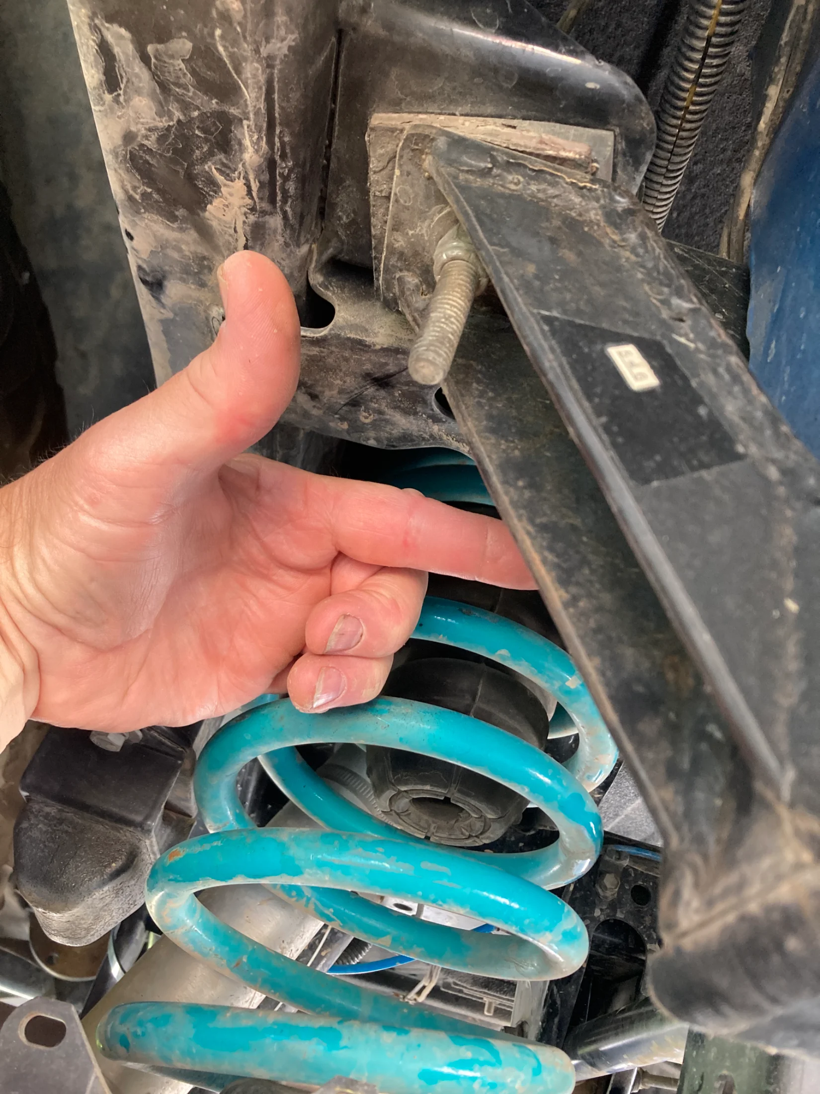

On my quest to quiet down the cab I have been struggling with the exhaust. Originally I had it set up to go all the way out behind the driver tire, but I had not added this Delta part.
You know, to handle the three inch lift I put on. Now there is no room so it empties right in front of my drvr rear tire.
Too loud
Too stinky!
I have to make room to get that exhaust out the back.

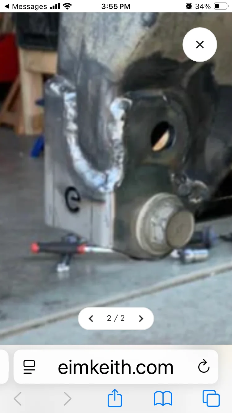

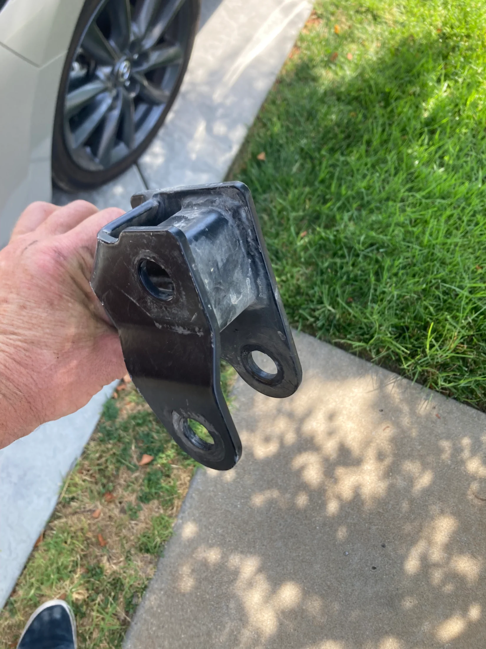

Maybe instead of the angle of the panhard being adjusted by raising the axle side, which is real sweet,
Maybe I could drop it on the body side.
Kinda like Eimkeith does with their kits.
Maybe even use the Delta bracket cut down and welded in.
Thoughts?

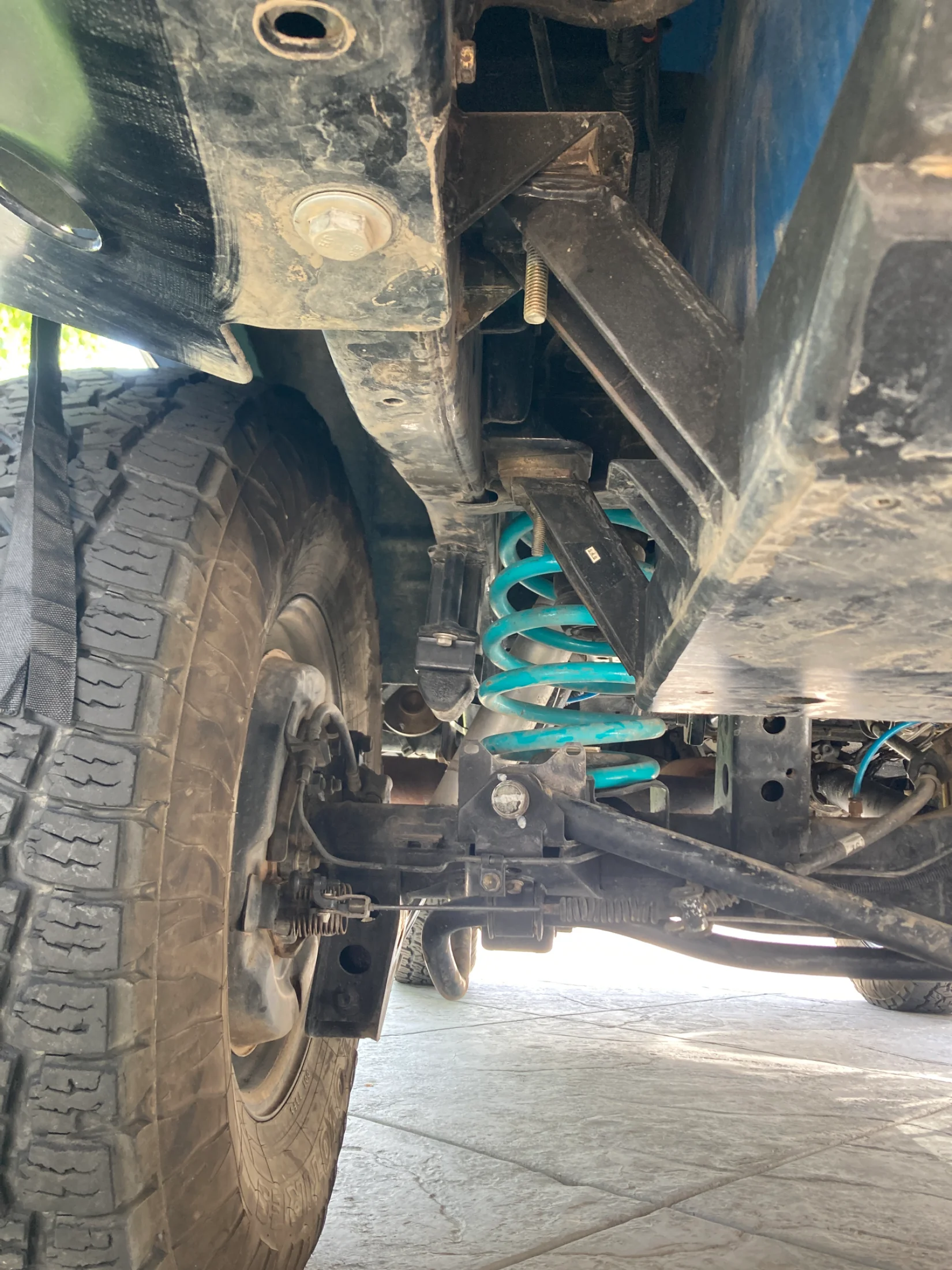

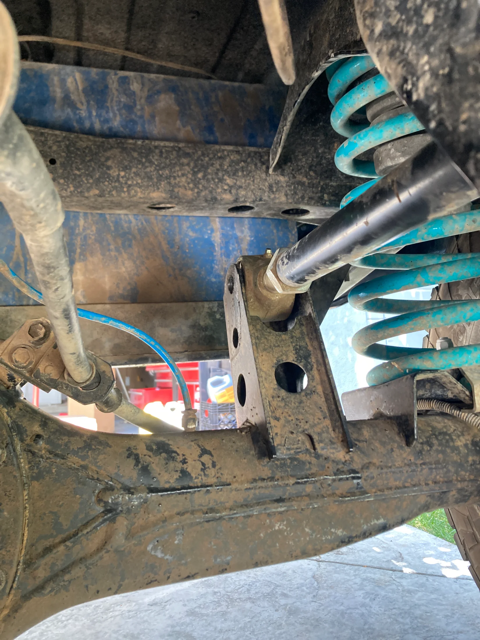

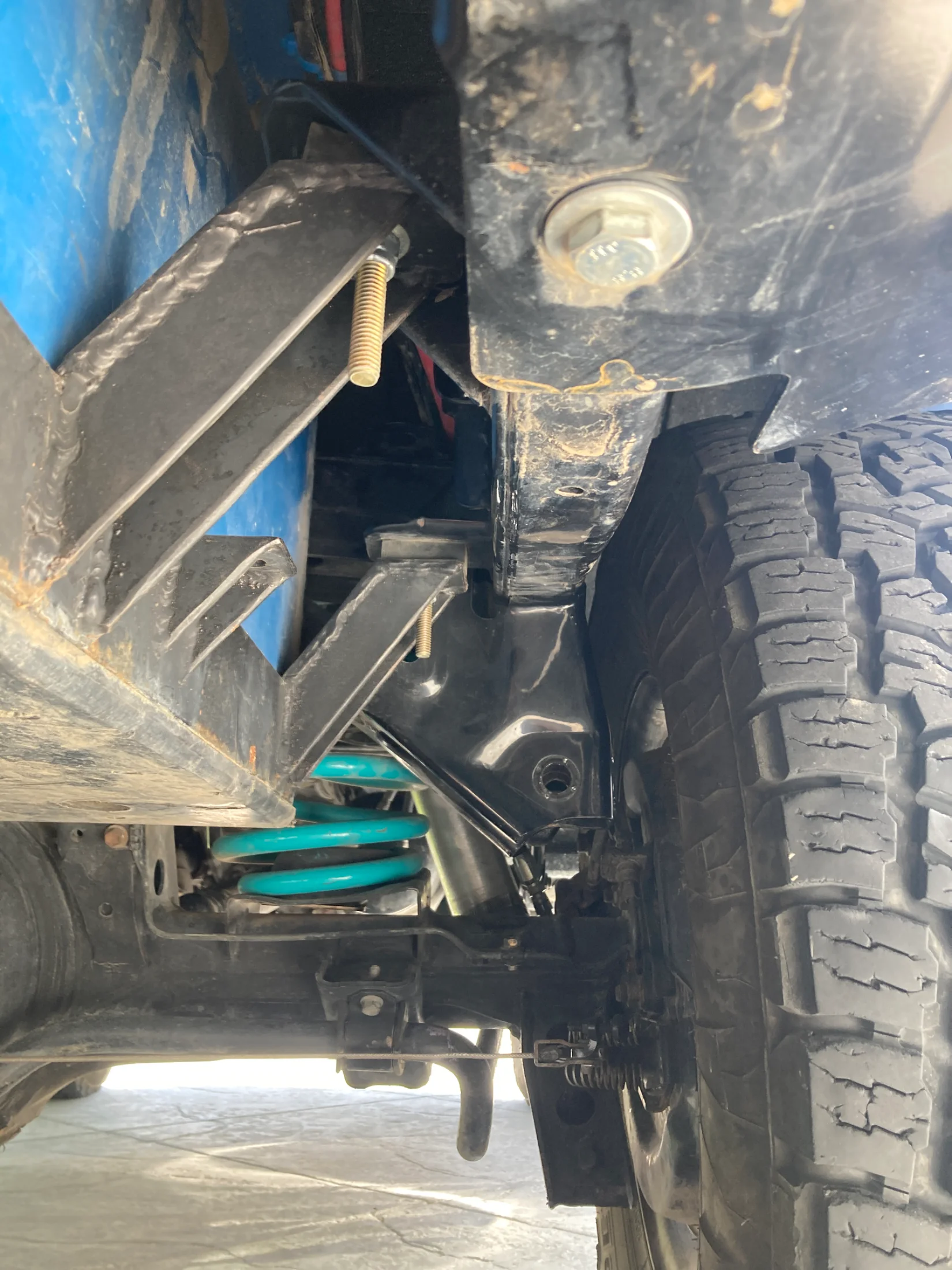

That Panhard bracket is in the way.
It squeezes out right below that cross member at full bump.
With that Delta correcting bracket it closes up that space. So the idea seems that to just reverse. Instead of going up on the driverside come down on the passenger side. Keep the space while getting correction. Dave hooked me up with some videos on Eimkeith brackets.
Could that be my answer?
Look at the first 2 pictures in this post to show you where the 80 exhaust runs over the rear crossmember. It looks like you have room to snake it through on either side, but it will be tight and lots of bends or pie cuts. 80 exhaust
