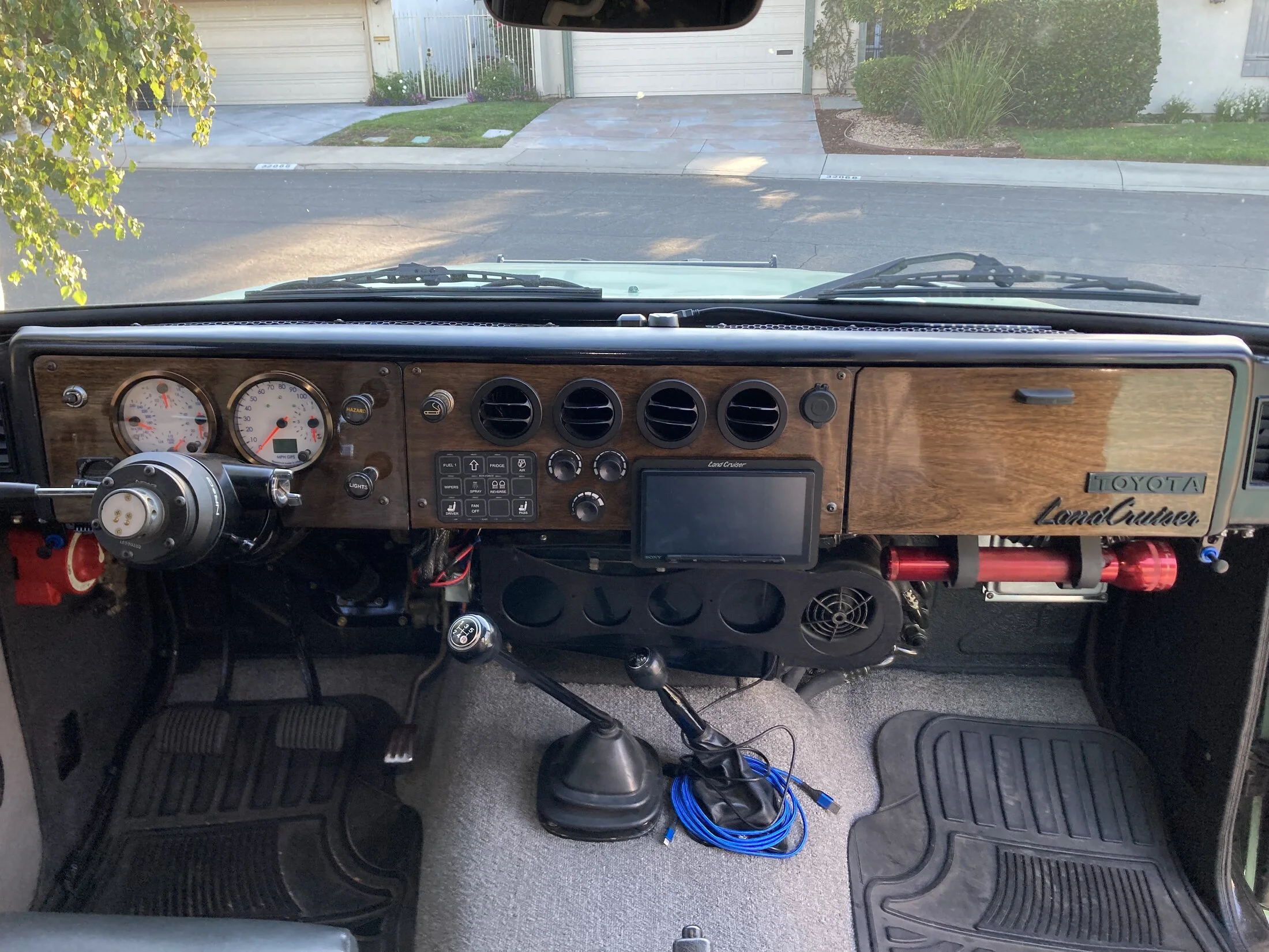

So I had bought the SwtchPro so long ago to enable to make the dash and figure out where the computer would fit under the dash. Once done just put it in the shelf until the day would come for wiering.

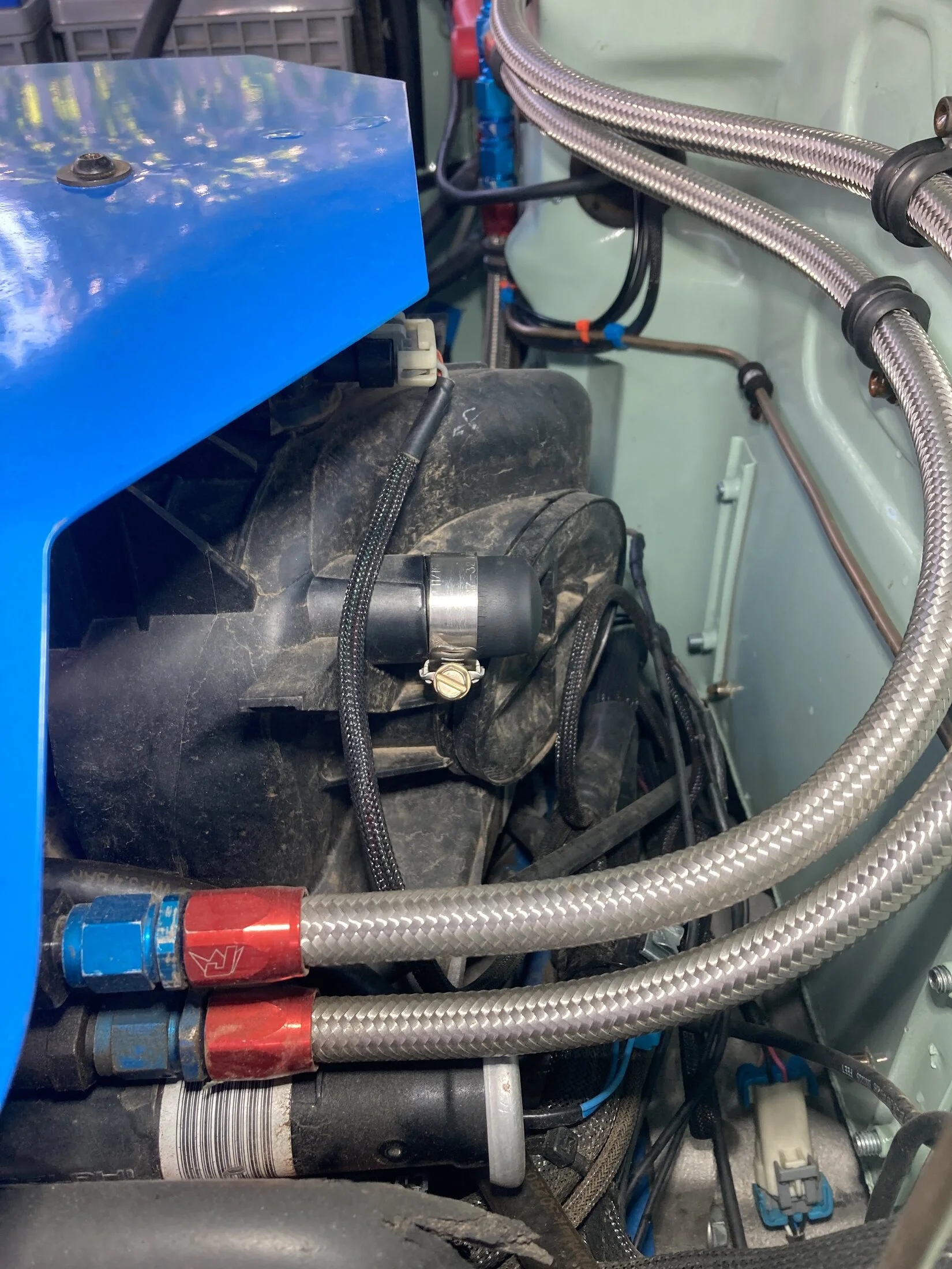

So have been struggling with two things. In a cold start I have to throttle until the car is warmed up otherwise it just dies. The other is randomly when I come to a stop it will just drop off and die.
I had a port on the back side of the intake that I had capped, so I thought it best to check it again. It was loose and spinning around.
Took it off and repositioned it around the base so that it fit solidly.
FIXED! No more having to throttle when cold and no more random dieing when coming to stops.
At least so far! I just love me some easy fixes!!
Picture of the Vaccum port

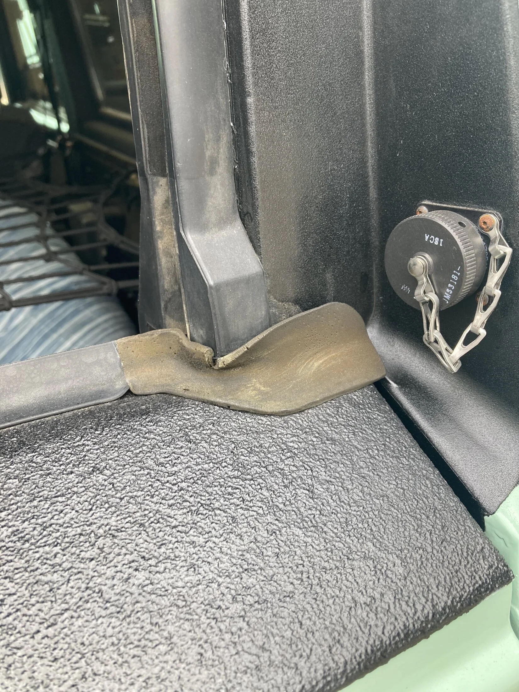

Same as Slocruisers. It's like they used a different rubber for certain pieces. Vent window gasket and the fixed glass rear door rubber, all deteriorate quicker than the rest. I don't know why?
Something to do with Chinese rubber. Something about its composition is lacking resistance to UV, and basically time. Tons of rubber products/parts I’ve bought and also bought by my company have deteriorated in 1/100th of the time the original pieces.
Yeah the rubber thing is not just automotive applications, lots of it is junk these days 🤬
