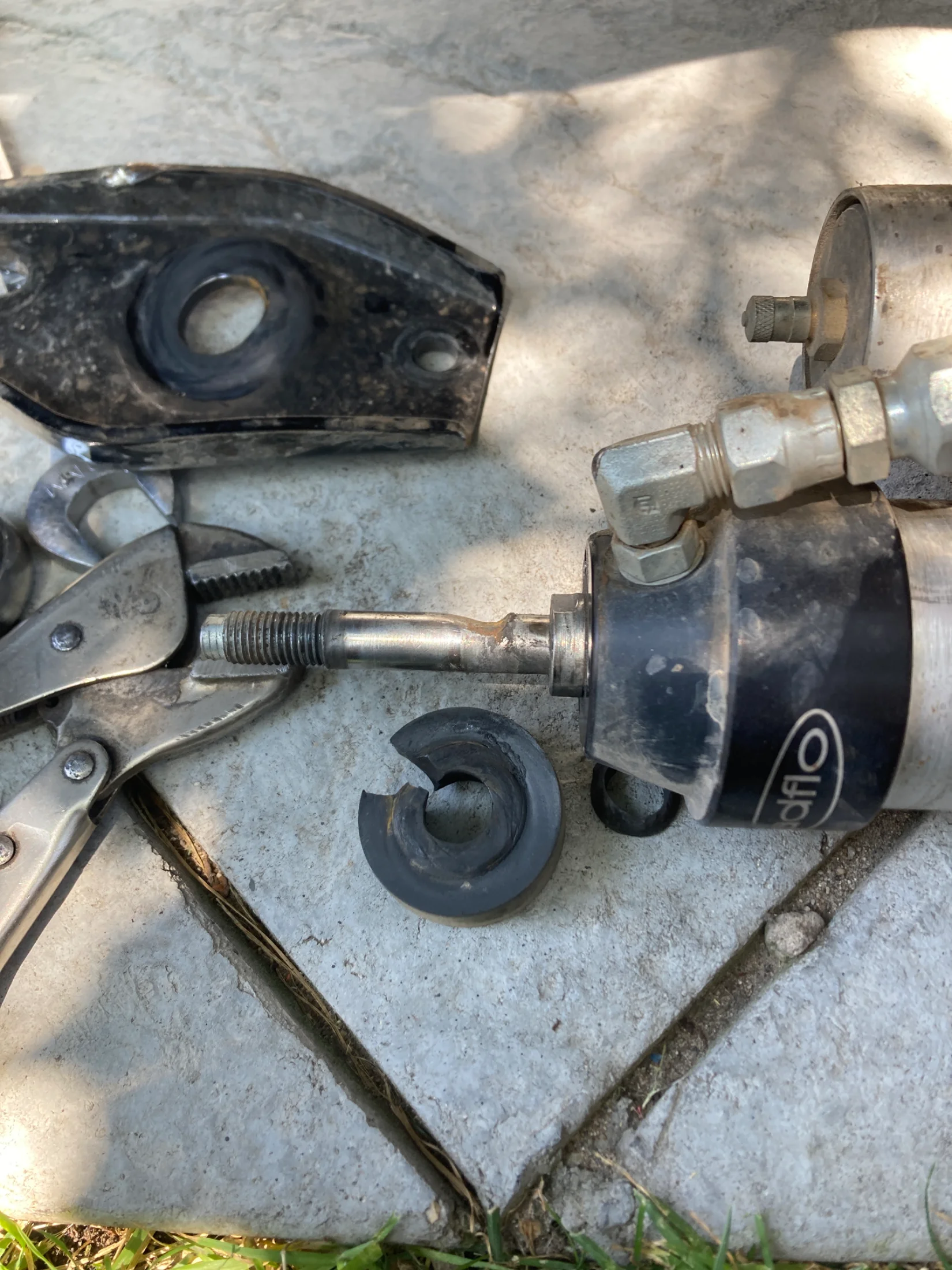

rear body mounts
I got this when I couldn’t find a bushing to replace.
Guess I need to fix that. That gonna cost a dollar!

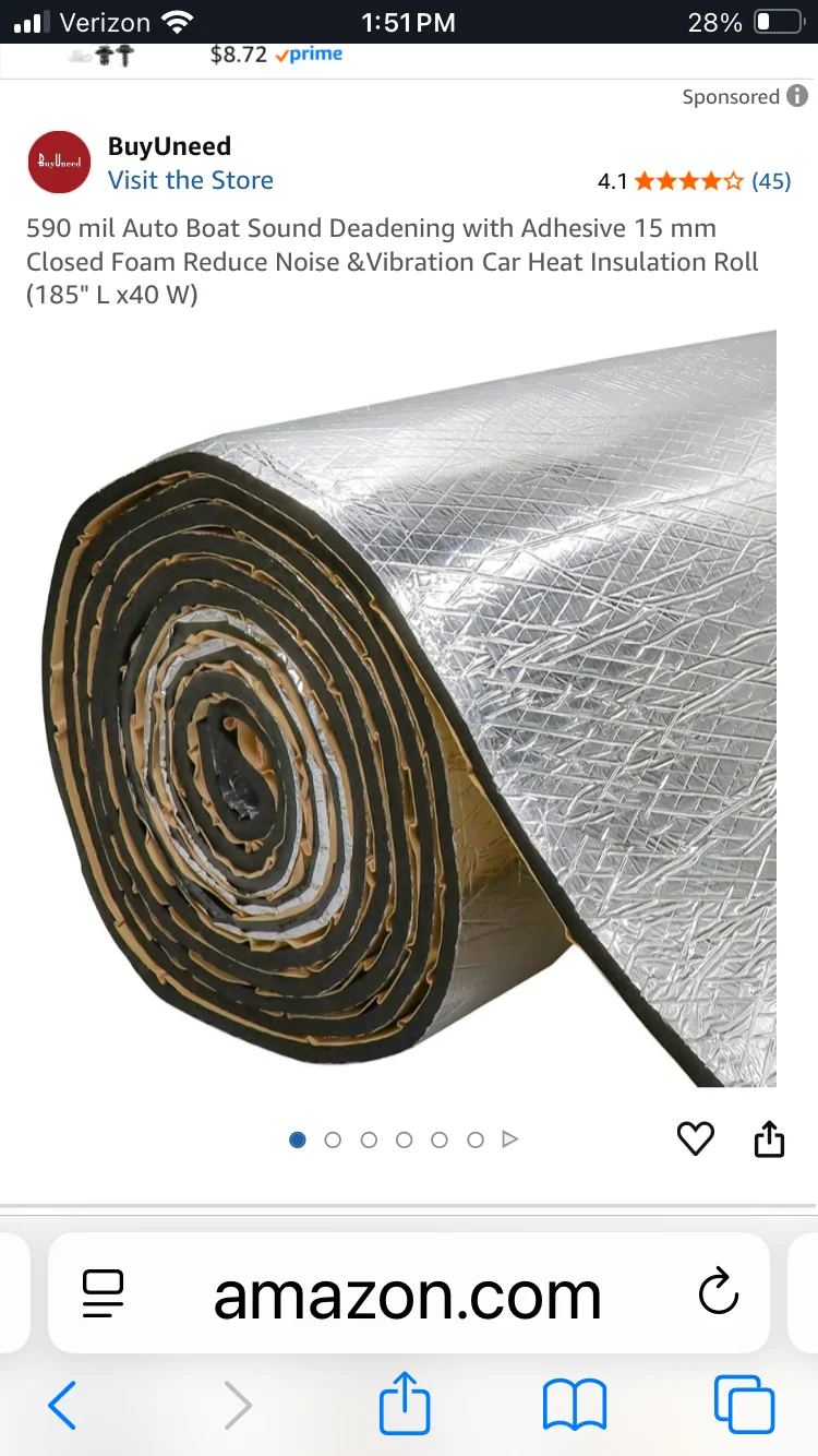

There is a thick rubber inverted boot that goes under the leatherette transfer case boot. Sounds like that is missing? I’ve also lined the underside of the transmission cover with raptor liner, helps some as well.
Often on trucks with trans noise there's a missing pillow of foam stuffed between the trans and the body to arrest noise.
It will be a lot more effective than anything that you'll pour in the transmission.
You can make this yourself out of foam from an old mattres or chair.

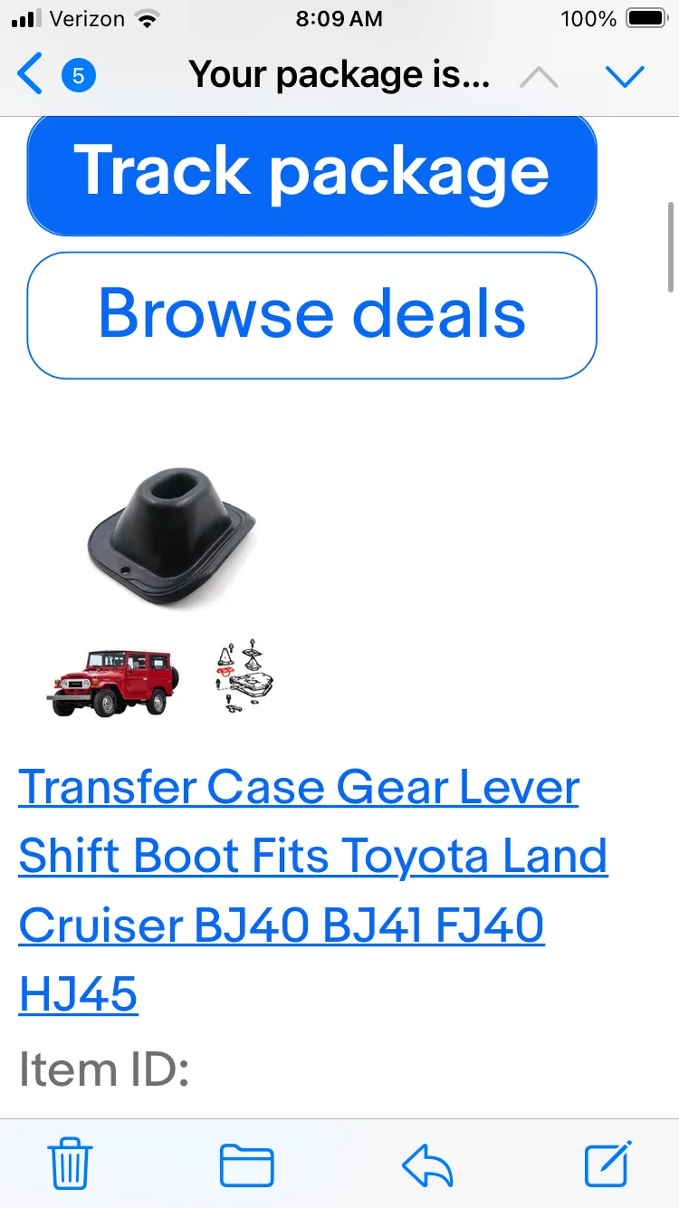

Here's the full part number for the transfer case lever boot:
58281-90352
[td]58283[/td][td]COVER, FRONT DRIVE DUST[/td]
Looks like it's NLA from Toyota but maybe City Racer or someone makes a replacement.
Just the single. That twin set up looks really cool!
You can possibly incorporate the lower boot for the t-case shifter that WDE found above as long as there weren’t mods made to the opening on the hump. If you had to make any mods, or are looking to run the twin stick shifters, that lower boot won’t work. That doesn’t mean you couldn’t try to make one that would work.
