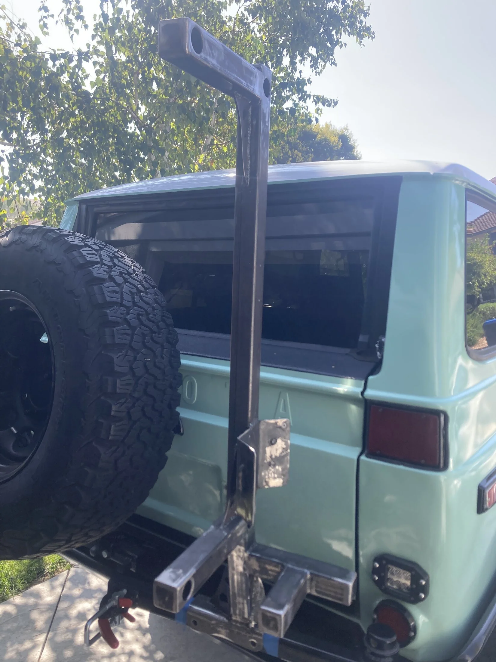

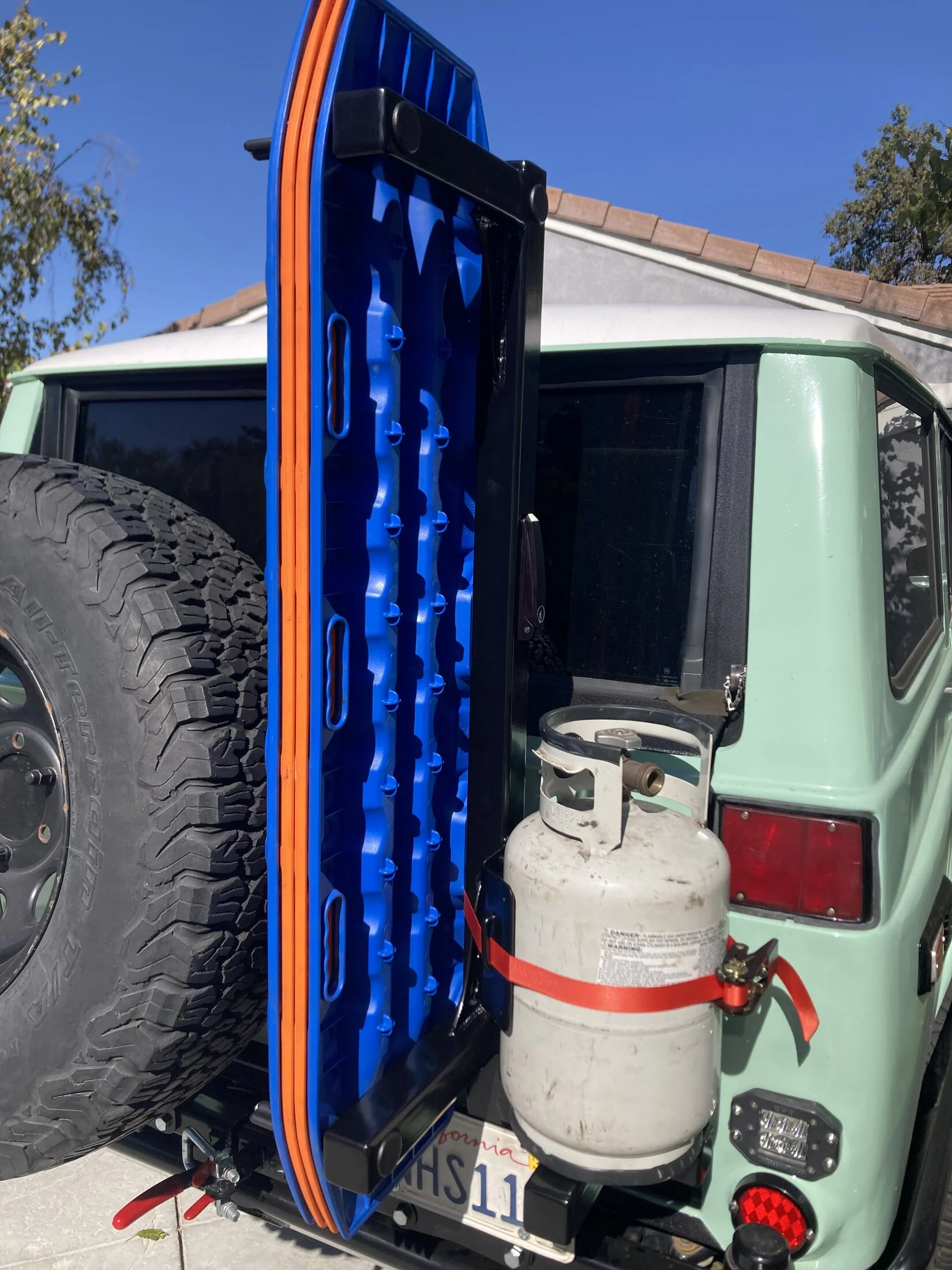

rear body mounts

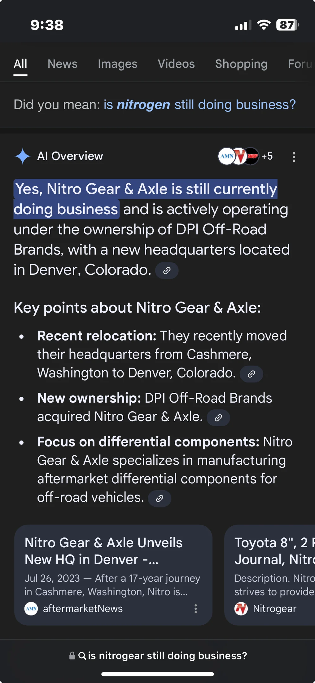

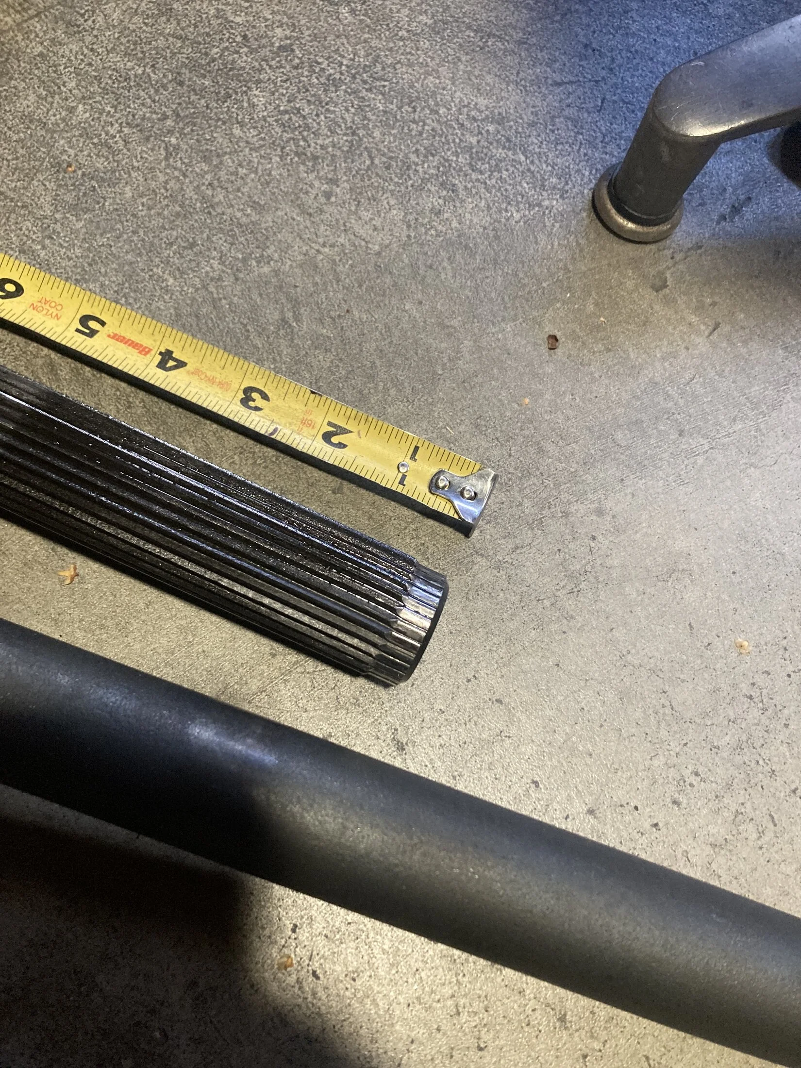

Looks like their server is down- or they’re gone. Trail gear still shows offerings from them. That bums me out, because my rear fzj80 full floating right hand shaft is one of their locker compatible cut to length deals. Hope I never need a new one. Which rear axle are you running?
I called Dpi and they don’t carry them. I think they were sold twice and now are gone.
RCV has m300 shafts but they cost $1200!
I had an old 60 shaft and took it down to Specter and got a trade deal, an axle for an axle. So now I am running stock Toyota axles.

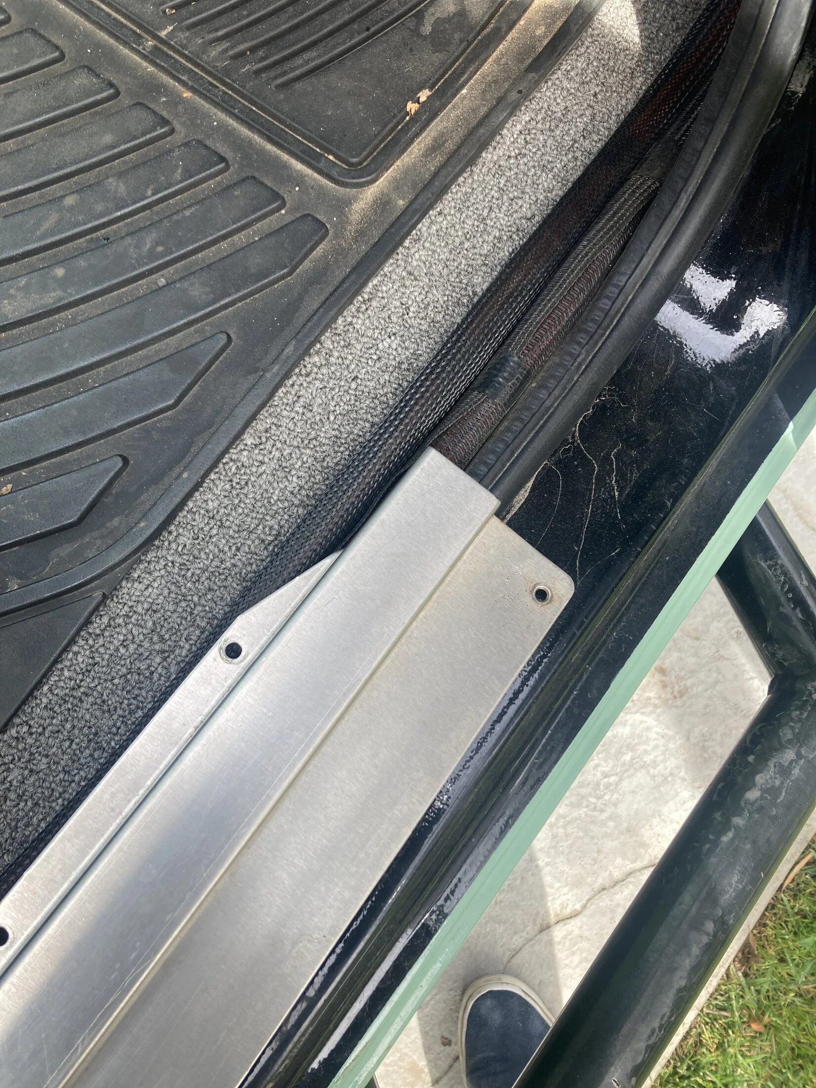

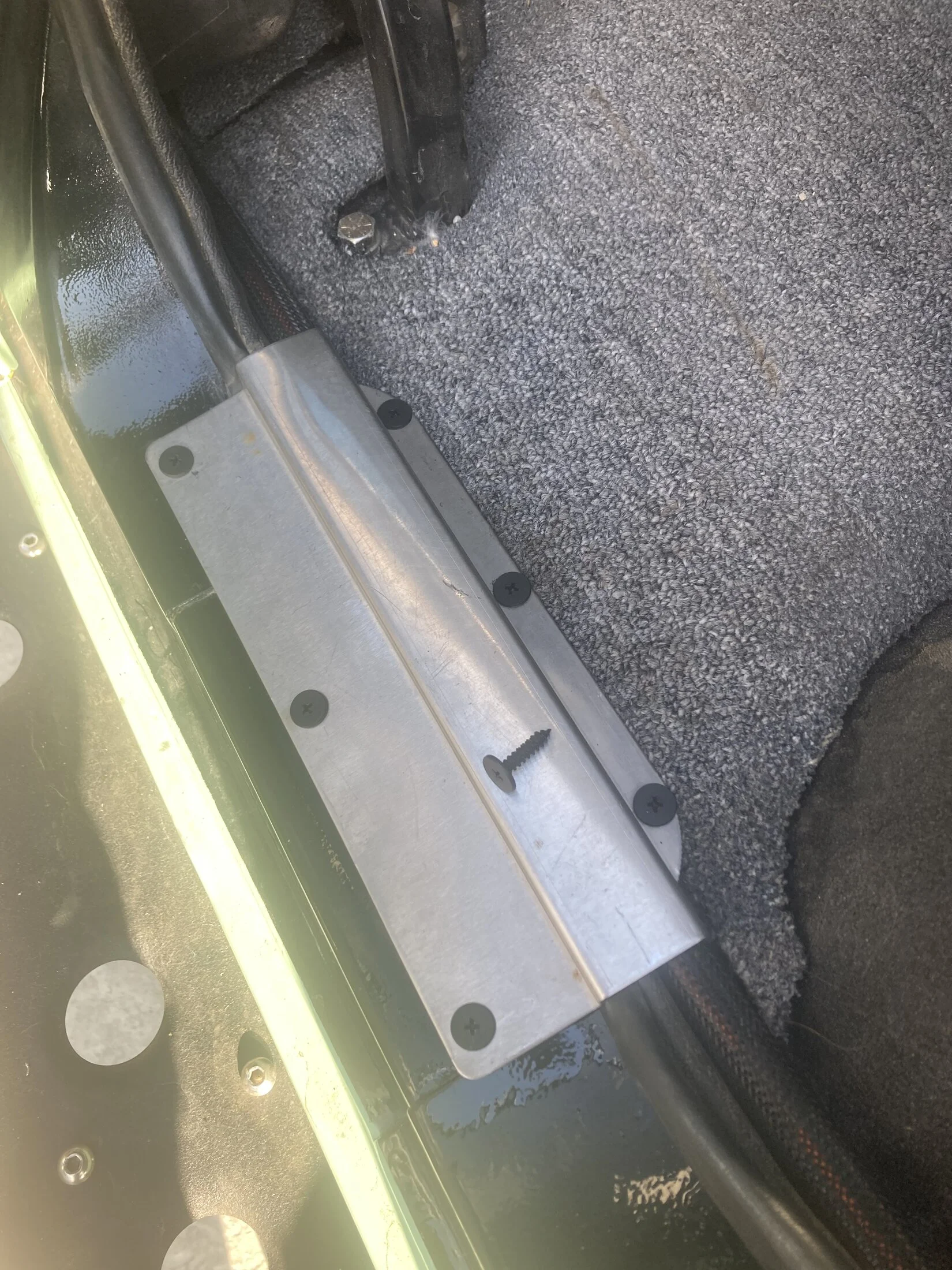

Another big is that I finally got Bobs door sill in the back driver!! I have been waiting for years to get these back in!!!!!!
AND to use the special screws that JMack suggested years ago!!!! Or at least it seems years ago!
Very excited with this as it marks an end of something! Well….
Reaching out Bobm.

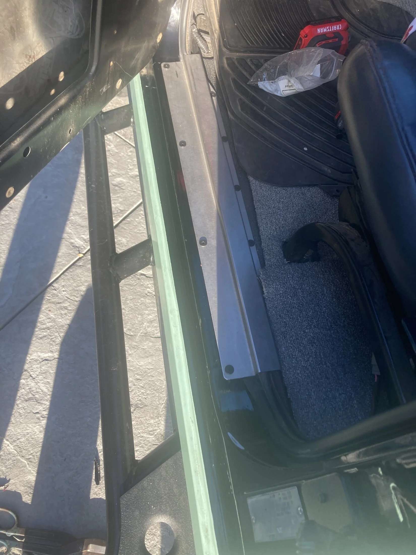

I am in the process of installing my last Bobm door sill and I am realizing that my front passenger needs to be an inch wider to capture all the new wireing.
How do I make a new one of these that will accommodate the new dimensions? As I look at this piece I am realizing the level needed to make these things and have a new appreciation for all things Bobm!
