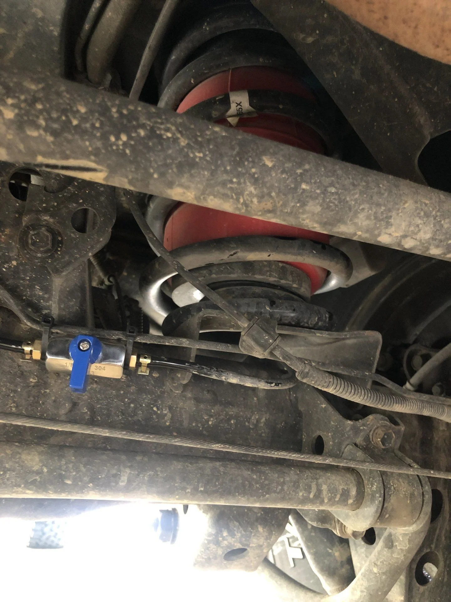

Some folks "wire up" the air line to supply air to both bladders off of one Schrader valve. Why? If you have a bladder pop on the road while towing, your suspension remains symmetrical. This is a VERY important safety consideration and one i experienced myself towing with the Airlift 1000 system.

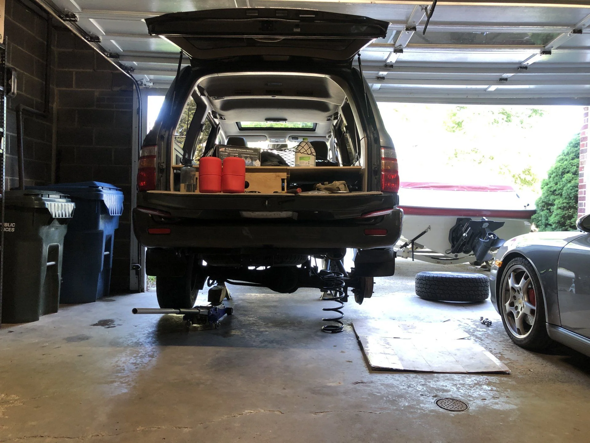

You can see how I routed the lines through the bumper and installed the bags in my build here. I would definitely make the holes in the spring plates bigger and like others have said check the air frequently especially if towing. I did not make the holes large enough so it has popped the line off the bag when wheeling, and have to go in and fix that.
Warning: Harbor fright jack stands in use. {{shudder}}
I’ve been running airbags (airlift 1000) for four years now with no leaks to speak of. I have them plumbed together so yes their is the potential for a jacking effect but I haven’t encountered it yet. My air valve sits behind the fuel door. I inflate the bags to about 25psi when carrying the family and all our camping gear and air down to 7 psi when empty and driving around town.

I routed the airlines from the bottom of the bags, along the dif breather hose, then to the rear bumper. I would highly recommend installing a valve in between the L and R bags to prevent excessive body lean when taking large sweeping turns on the highway.
