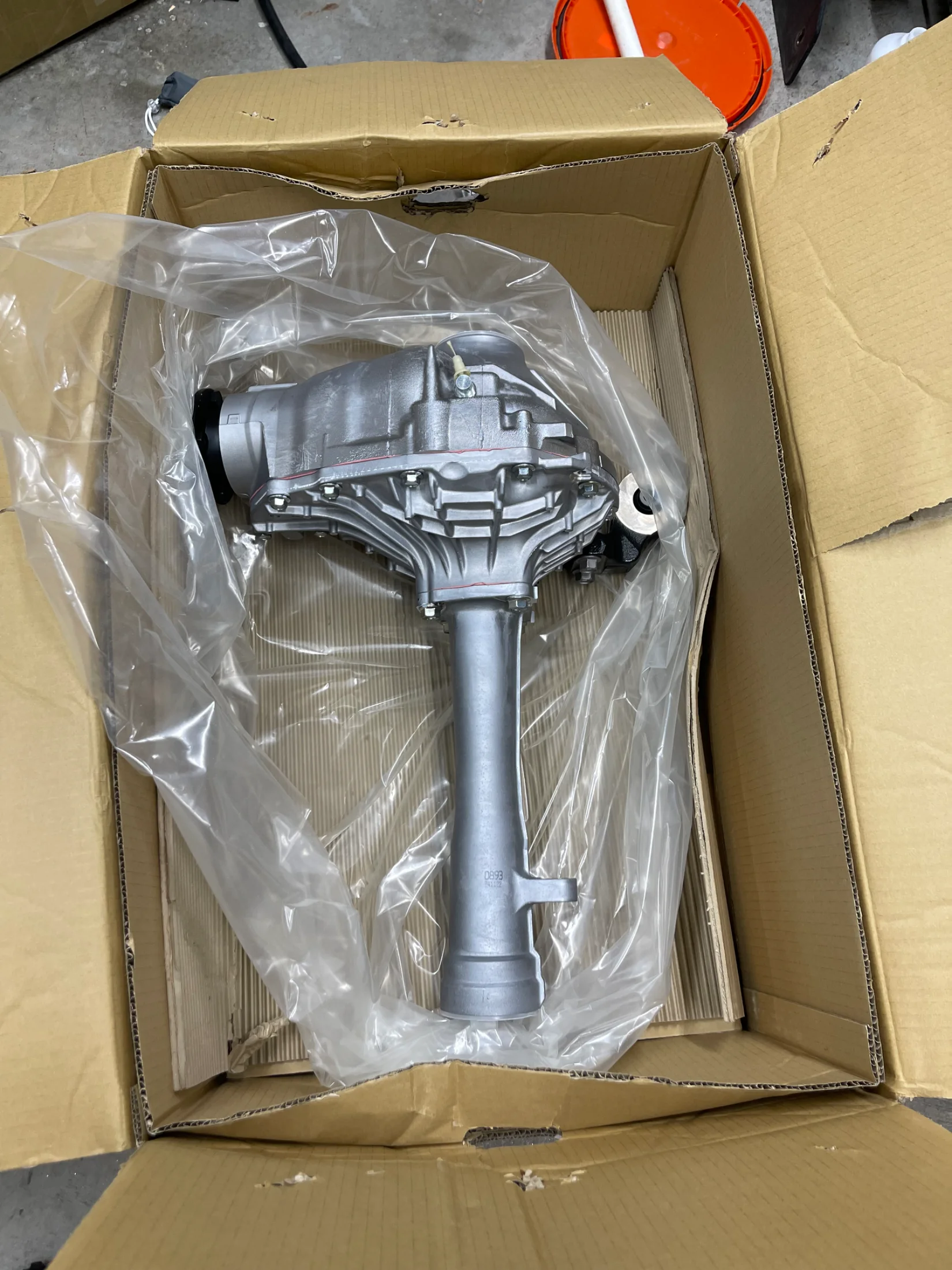

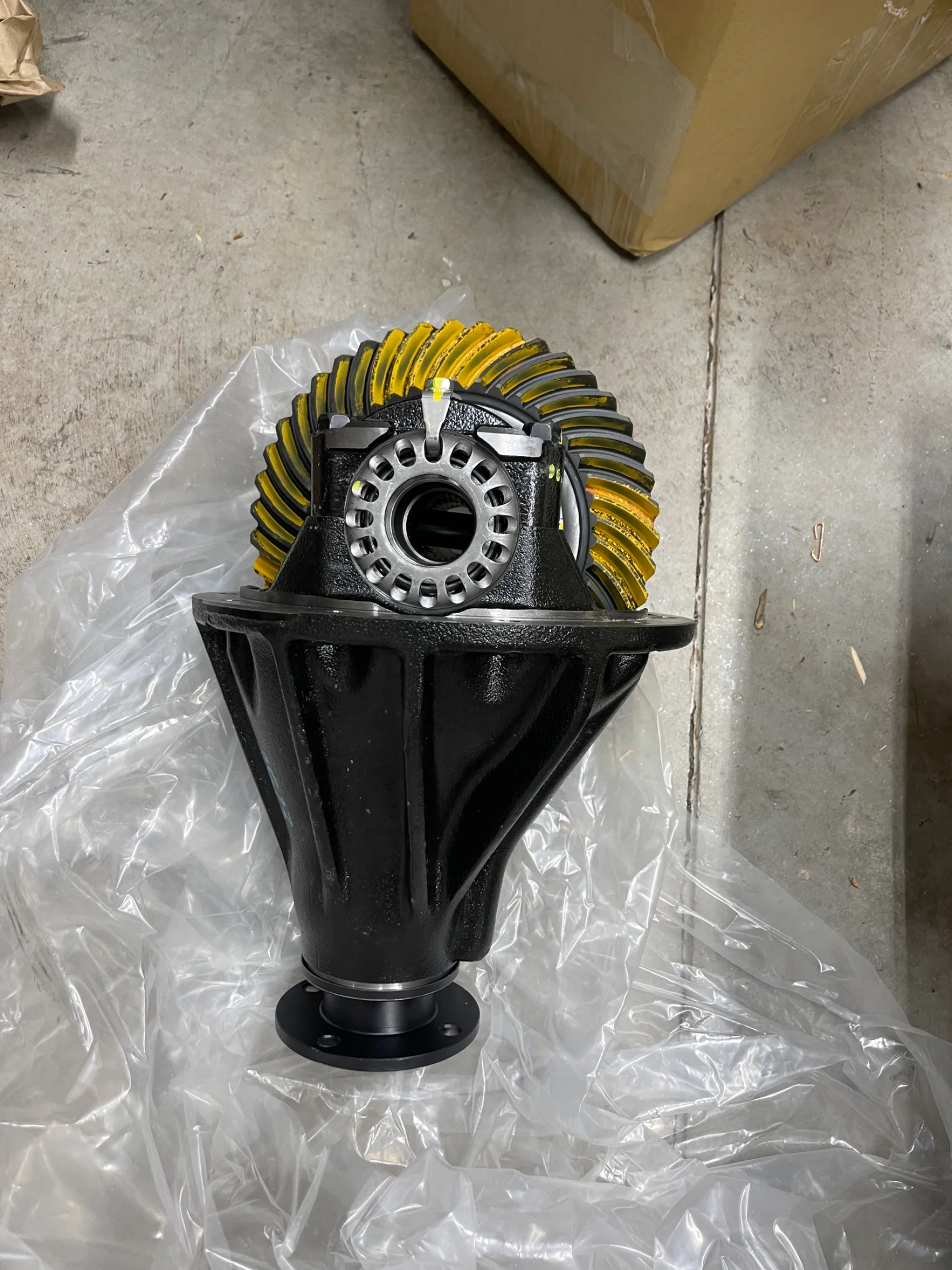

I might as well drop some eye candy while we’re discussing these things.
