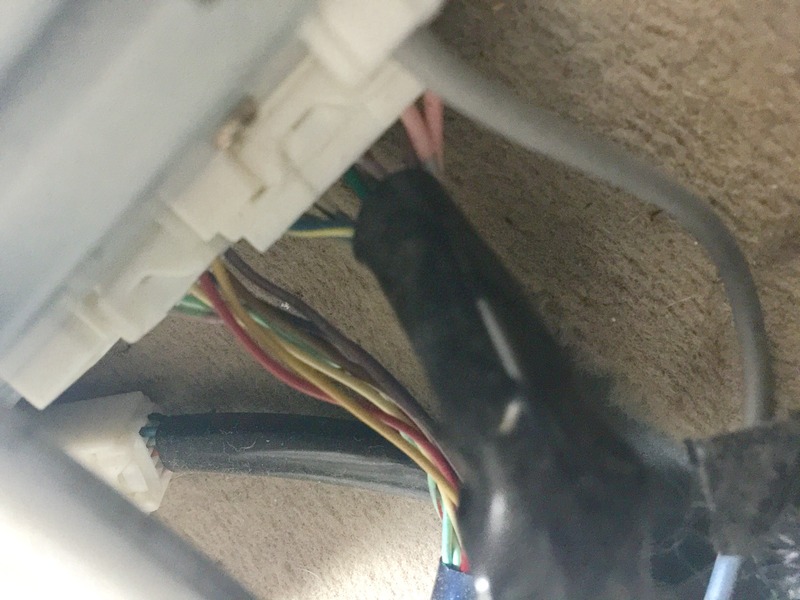

There is a blue connection facing the front passenger seat but I can't see or feel a lose wire that would connect to it. Do you know by change if this should have a wire to plug into it that I'm just missing?
I appreciate everyone's feedback. Fuses are good, pin 60 soldered (just in case), battery disconnected several times and still no luck. I'm assuming the nav dvd unit is bad or I just can't see or feel a wire that connects to the blue connection point at the back of the nav dvd unit. The quest continues...
Sorry for the bad pics but this is what the connectors behind my dvd player look like.
