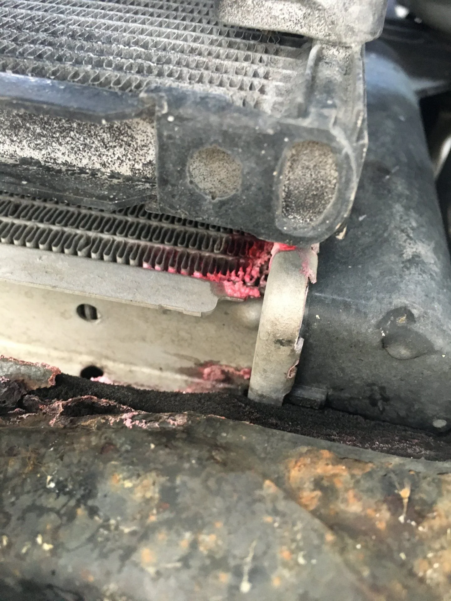

Hey gents, I am a 100 series owner but I am taking a look at my mom's GX before we road trip to CO from WA. I am trying to familiarize myself with the systems in this rig so I can do a bunch of maintenance for her. Looking underneath, there appears to be a radiator leak? I am assuming this isn't a normal thing, question is if I should be concerned or not. Coolant level appears to be normal. Thanks in advance
I think you're spot on about it being a radiator leak. I'd replace the radiator if i were about to drive it from CO to WA.
Not normal, but common. Radiator replacement isn't super difficult on these trucks. Hardest part is getting a good replacement radiator without paying dealer prices. Probably should flush the coolant while you're at it.
I had the same problem with pink stains on edges of radiator. I didn’t want to risk it on a trip to Utah so I had it replaced.

Realistically I am not going to be able to change it before the trip. Have there been many cases of these radiators exploding from tiny leaks? Or should I be good getting a gallon of coolant and watching the temperature?
I actually went on a couple of offroading runs to Joshua Tree and Big Bear plus a trip to Utah (all departing from Los Angeles) with the radiator leak prior to replacing. Nothing happened to me and the coolant temp was good. The coolant level didn't change much and it stayed within range in the reservoir.
I did notice that my pink leak was crusted and it seemed like the crust got a little thicker, but I made it fine. I can't say how bad it deteriorates once theres a leak, but I drove long trips (up to 10 hours straight) without any issues. My mechanic told me not to remove the crust since it acted as a plug. He said just to leave it alone until I replaced the radiator.
I can't predict what's going to happen to you, but if you can't change it...then just take some coolant and distilled water as a precaution.
