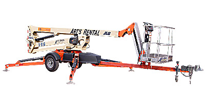

Im about to rent a 50' towable boom lift, and one of the companies that has them for rent locally won't rent to anyone that doesn't have a 3/4 ton pickup "due to stopping power".
The manlift weighs 4800 lbs with a tongue weight of 350 lbs. A 2005 LX470 should handle this with ease, correct? I know the fuel mileage will drop to single digits, but the 20 mile round-trip to my home and back shouldn't be an issue.
Should I press to rent and tell them my LX is fine, or should I look elsewhere?
Is the trailer 50'? If so, I would not want to tow anything that long in a diesel, much less a gasser. If not, how long is the trailer?
Weight wise, yes that should be doable, but you need to have a brake controller. If you do not have a BC, I would not expect many folks to rent anything to you over 1000lbs.
Dimensions stowed for towing are 26' long, 6' tall, 6' wide.
From a trailer length/weight and tongue weight perspective, your LX is fine. It's almost certain that a trailer from a rental place will have surge brakes and not electric brakes, so you probably don't need a brake controller on your LX. Take them the LX owner's manual showing the relevant towing specs, and they should be ok with a rental if the towable lift has the surge brake hitch that's shown in the photo.
Yep, the data sheet for the lift lists -
Brakes Hydraulic Surge
Good idea.
This changes things, do the above and you shoudl be fine. Especially if you tell them how/when you are going.

Ill get some pics of the LX towing this boom tomorrow if things work out like I plan.
Yes, please keep us posted, I'd like to see it being towed as well as the result.
The LX hauled this big beast wonderfully today. Fuel mileage suffered as expected but not too bad. Ended up going with a 40 footer instead of the 50 footer.
